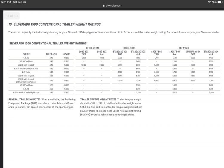

  2. Just wondering If I am calculating the “max” towing capacity of the truck (google and vin checks are not consistent). From what I can tell it is 9500lbs***. Does that sound correct?

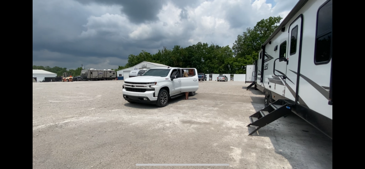

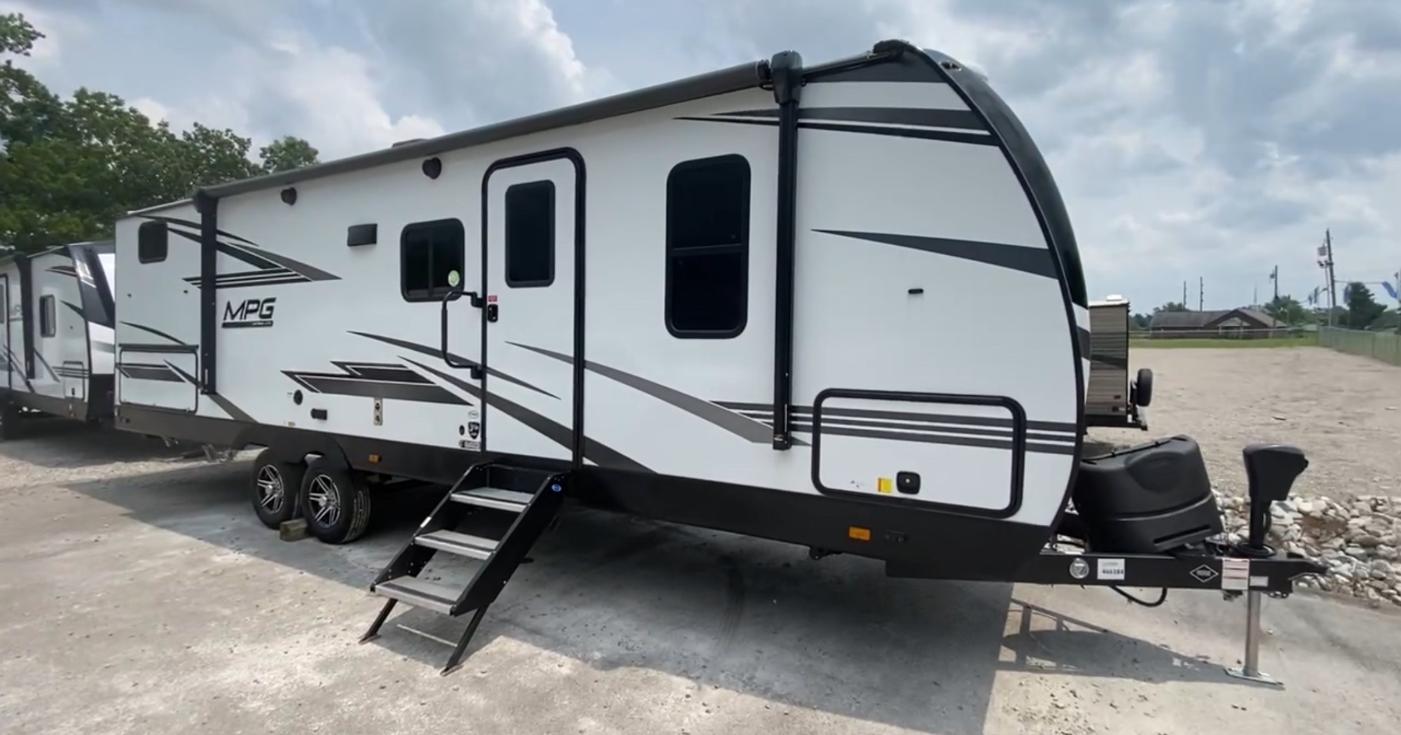

  4. I am currently in the market for a camper and I am wondering how much weight I can tow. I have 2019 Silverado 1500 RST 5.3 V8 crew cab short bed. From what I can find online I should be “okay”, but really wanted some feedback from those of you that have a similar setup. I am aware the 2500 is the ideal setup, but that will be down the line a bit for me. Truck Trailering Info: GVWR 7100lbs GCWR 15000lbs GAWR RR 3800lbs Max Payload 1819lbs Max Tongue Weight 960lbs Curb Weight 5281lbs The camper I am looking at has a dry weight of 6300lbs and GVWR of 9,480lbs (no intent to load our camper down or travel with full tanks). Hitch weight of the camper is 680lbs. 32’ 11” tongue to bumper. Really only looking at going camping within 100 miles on the weekends. We typically travel light with basic necessities for hook up campgrounds (clothes, food, chairs). any help would be great!

  8. Thanks for the response. I am most definitely looking to add a WDH to the setup to support. My family weighs around 240lbs** and our luggage would be very little (200lbs as we pack light). From what I can find online the truck can safely tow around 9500lbs. This would be significantly less than the added payload and loaded trailer. We don’t plan to travel more than 1 hour 30 minutes away. I have several friends with half ton truck towing 6000lbs+ with no issues. The trailer is a total length of 32’ 11” tongue to tire.
