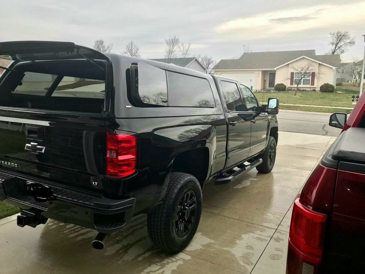

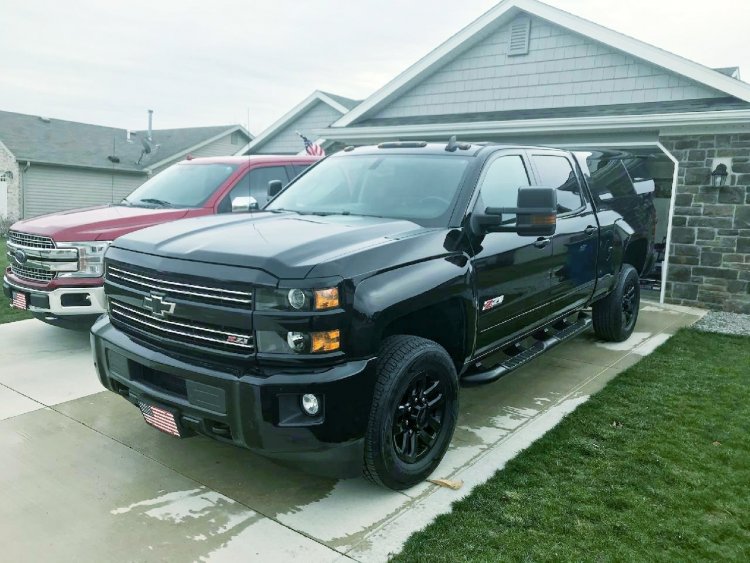

My 1st two cars were an 85' S10 Blazer and a 90' K5 Blazer. I got them both 98/99. Only had them a couple of years they were poorly maintained and were great 1st vehicles, learned a lot. Since then I have owned several Fords ( I know). Two years ago we really got into camping and bought a 25' TT. I had a 2018 F150 Lariat w/ 3.5L ecoboost and it towed that 8k trailer like it was nothing, however I was maxed out on payload. I wanted a used F250 Gasser but I came across my current truck and could not turn it down. 2017 Z71 LT 2500 HD 6.0L Midnight edition w/ a cap already on it. It had 45k mi and no accidents and no rust. Man I love this truck, big difference from my previous truck, at 1st I wasn't sure because it is just soo different but the more I have gotten used to it the more I love it. Can't wait to load this bad boy down and tow away! The F150 is sold now. Wife said I didn't need 2 trucks lol.
