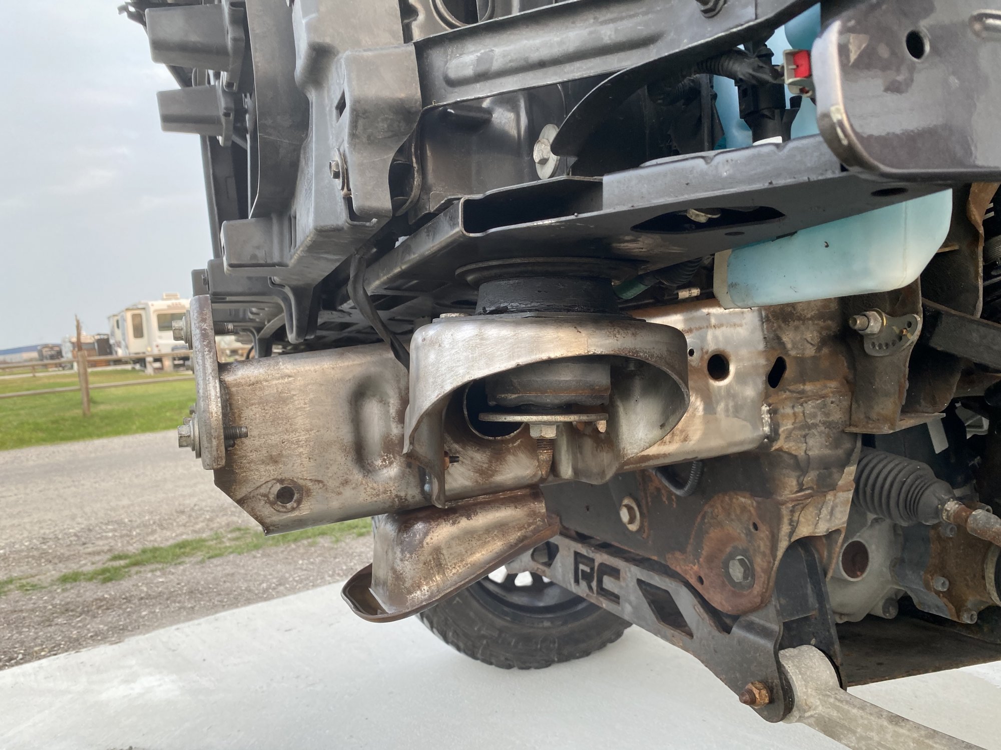

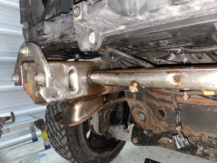

  1. This is the POR15 coating. I did two coats as best as I could. It’s hard doing this much working around all the parts and lines still on the truck. With the humidity at 95% around me made this cure super fast. I wasn’t even halfway to the other side by the time one side had gotten tacky. Came out pretty good. It does seem to leave drip marks as it dries. I used both a brush and a foam brush. Results were the same with both. Did self level for the most part. It was dry to the touch within about 2 hours.

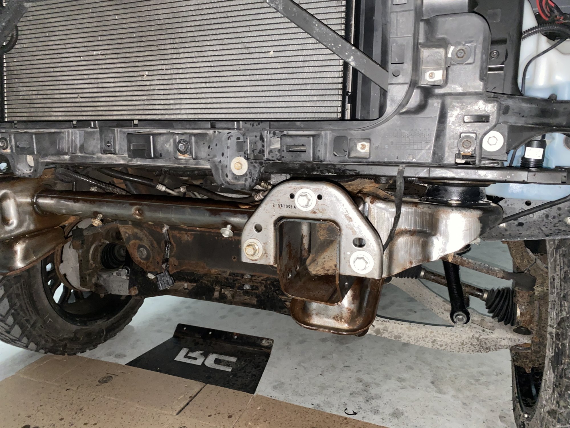

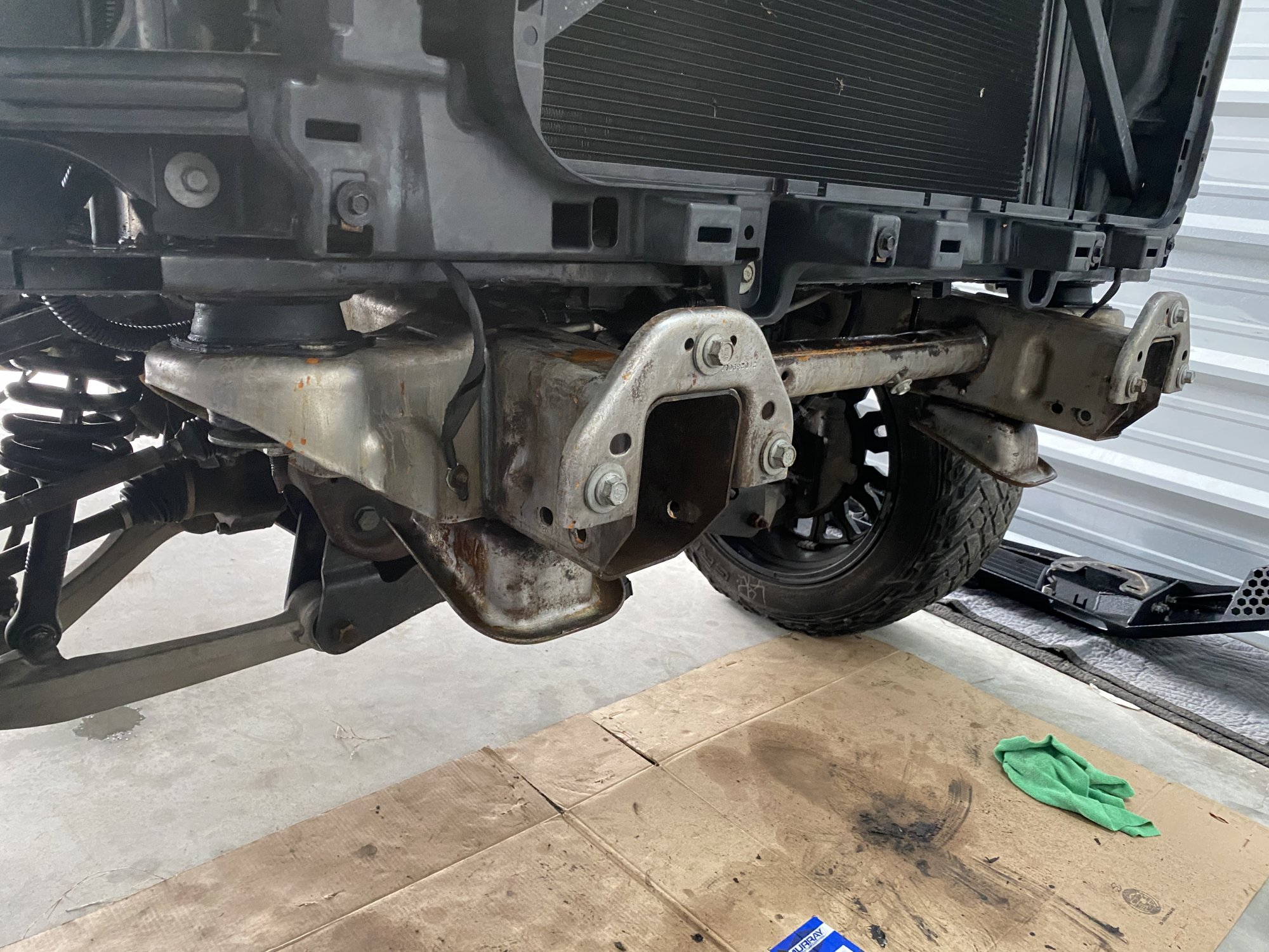

  2. So here is the only picture I took of the “metal etching” part I took. I let it sit for 2 days after I did the metal prep step and it didn’t really flash rust. Which was very surprising considering the humidity and salt air where I am at.

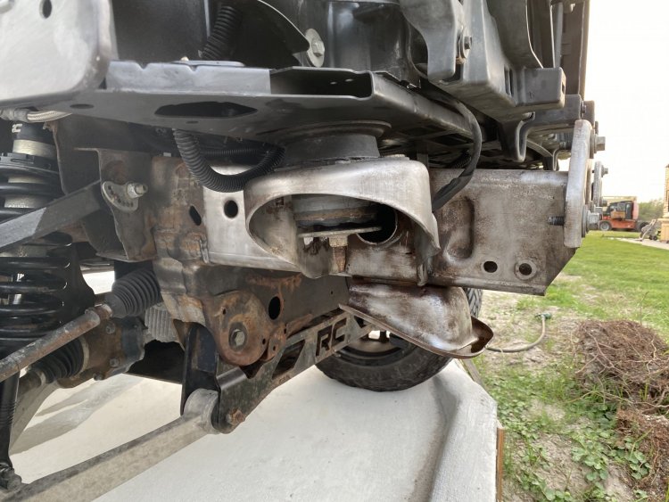

  3. This is pretty much doing it to the crossmember welds. I wanted to test this section first before I tear out the rest of the suspension since this is the roughest area due to the bumper being so high. And getting the most weathering

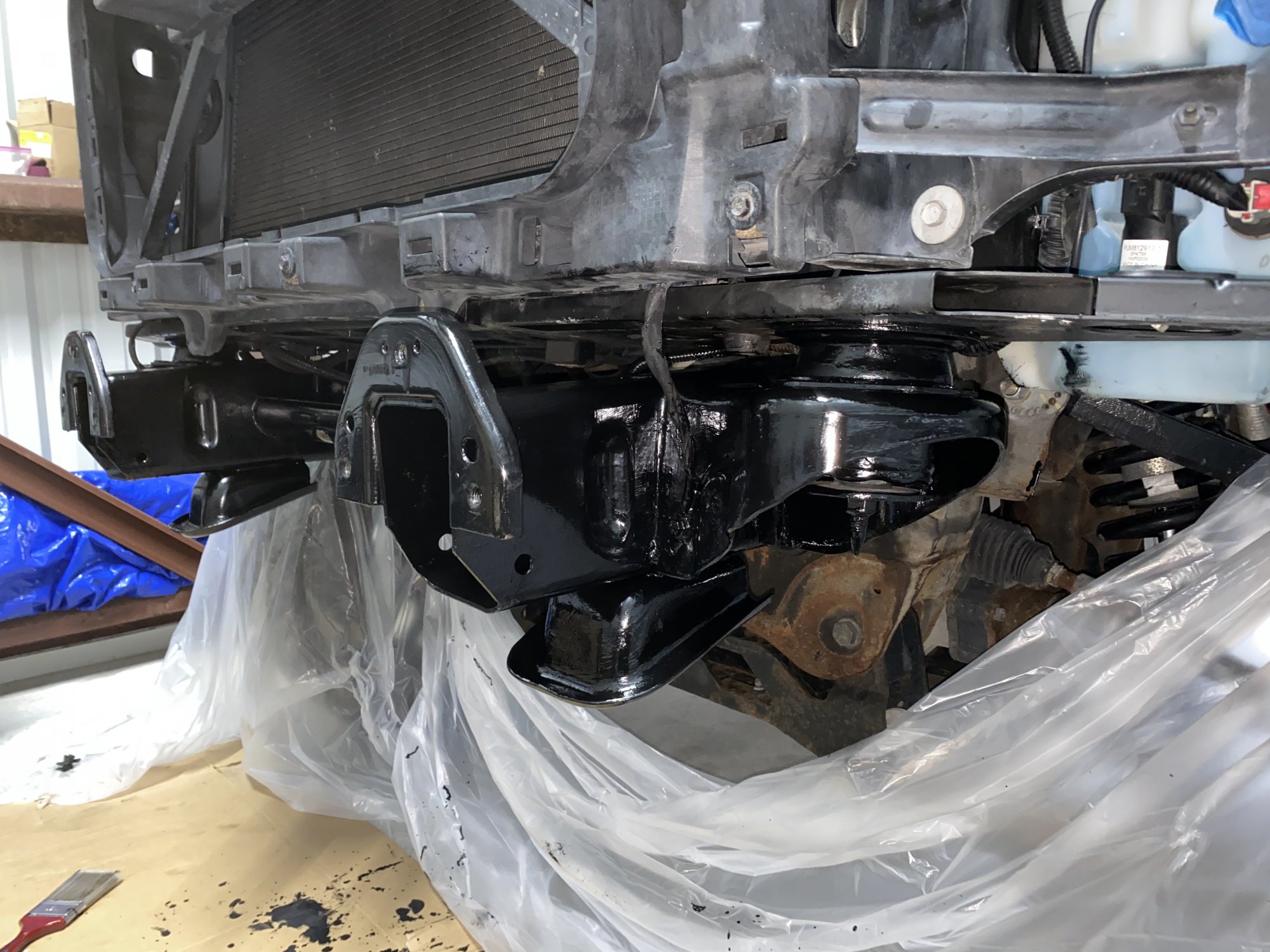

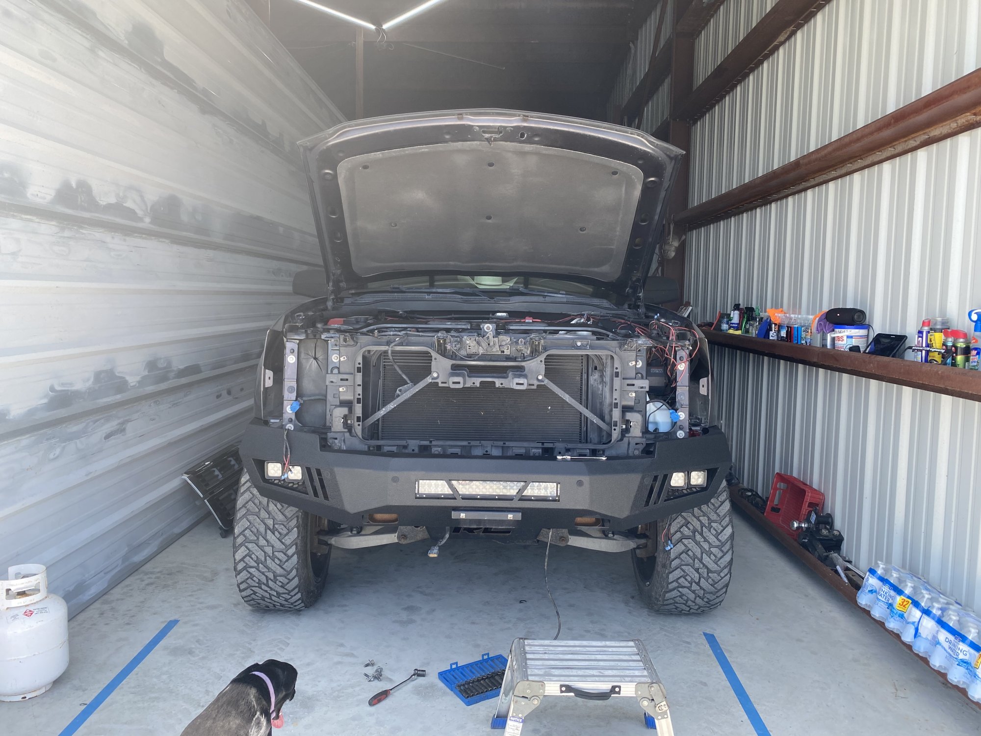

  4. So here’s my progress for tonight 4/13/21. Went a little further back on the frame. I’m gonna call this my first section. I went ahead and did the 1st and second step of POR15. Did wax remover and degreaser. Rinsed it, then did the acid phosphate part. Rinsed it. Letting it sit over tonight then tomorrow night I plan to do the 2 base coats. Planning to be able to scuff and do top coats this weekend.

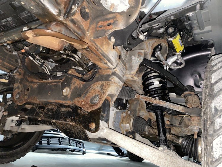

  5. @CamGTP yeah it looks rough but it seems to be mostly surface but this coating just comes off in flakes. Especially the front crossmember that takes all the rain, sand, dirt, etc. But this is just South Texas Coastal Humidity for ya.

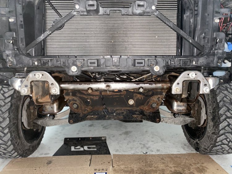

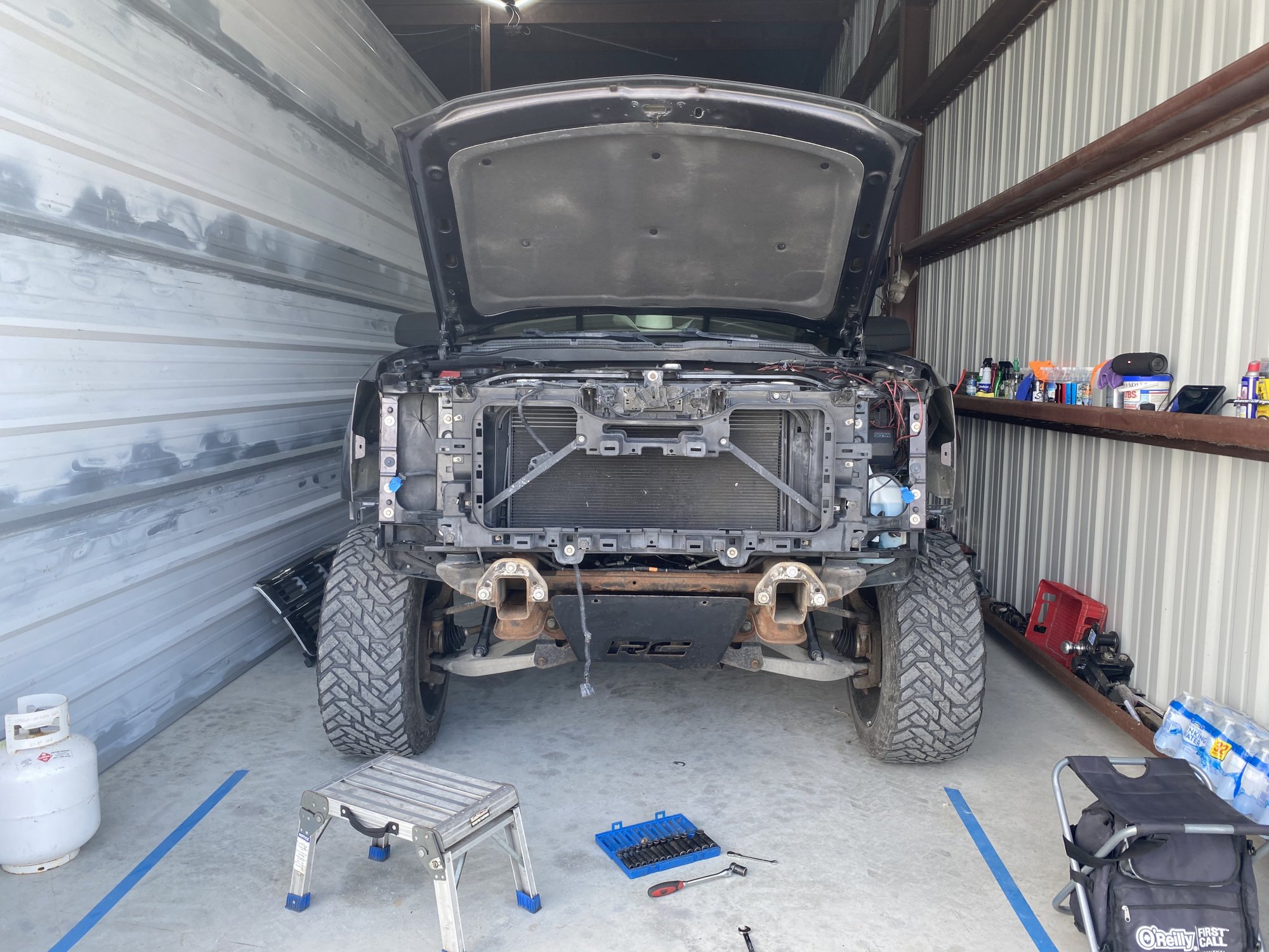

  6. Here is when I started. Gonna start from the front work my way back as I can. Here’s me removing the grille, headlights, and bumper. Doing all of this myself. Getting help with lifting stuff as I can. I will try to keep things as going as the progress comes. Pictures will be a few at a time depending on the progress.
