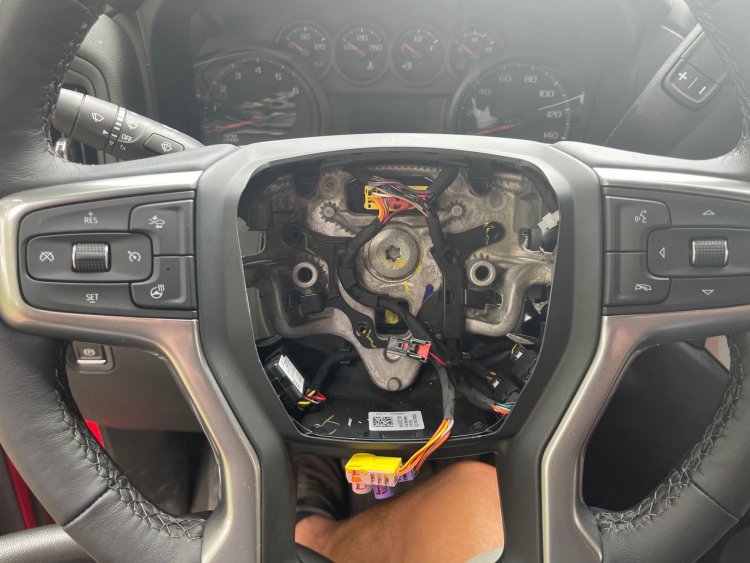

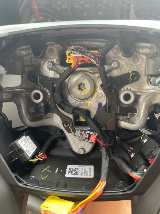

Well it was actually the buttons. I was able to swap out with the one on my old wheel, had to take apart the backing so that the harness would fit and it turned on. Great… Thanks for the help.
I tried but the harness point doesn’t fit on my old cruise control. Looks the same but old is black and the one on the new wheel is gray. Doesn’t line up. Might just return it and get a new one. Thanks
Hello model # is 85105210. Just took it apart to make sure all was plugged in and it is. Got mine from eBay. Maybe I got the wrong one, figured they would all work. Its from a 2021 suburban maybe that is the issue.
Hello, i just swapped out my steering wheel for a leather one and now my cruise control isn't turning on, i didn't do the cluster swap yet. Anyone have this problem after swapping out? Thanks for any help. Will try to take apart and see if anything isn't plugged in.
