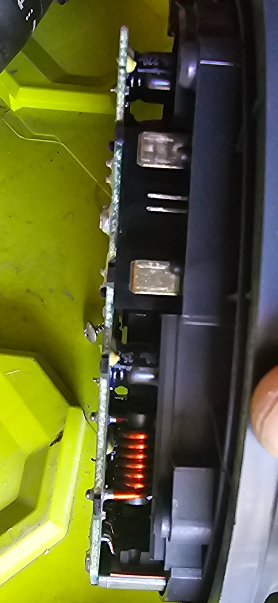

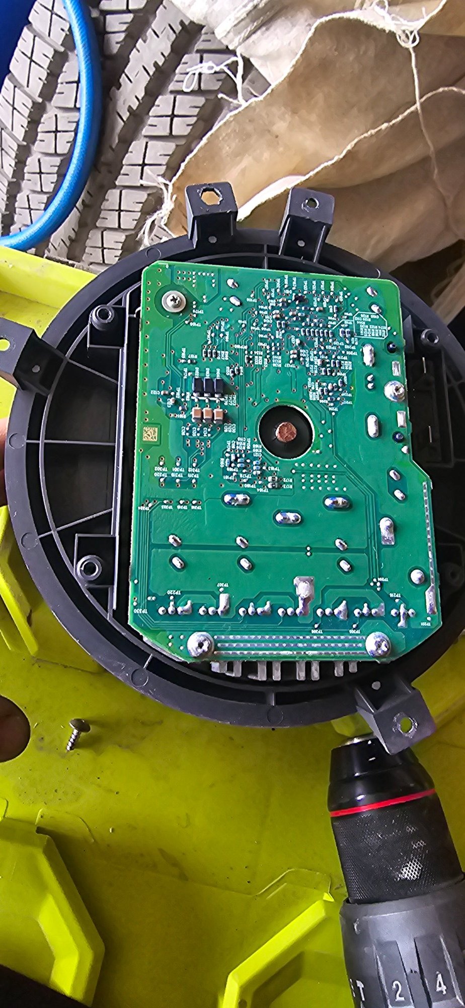

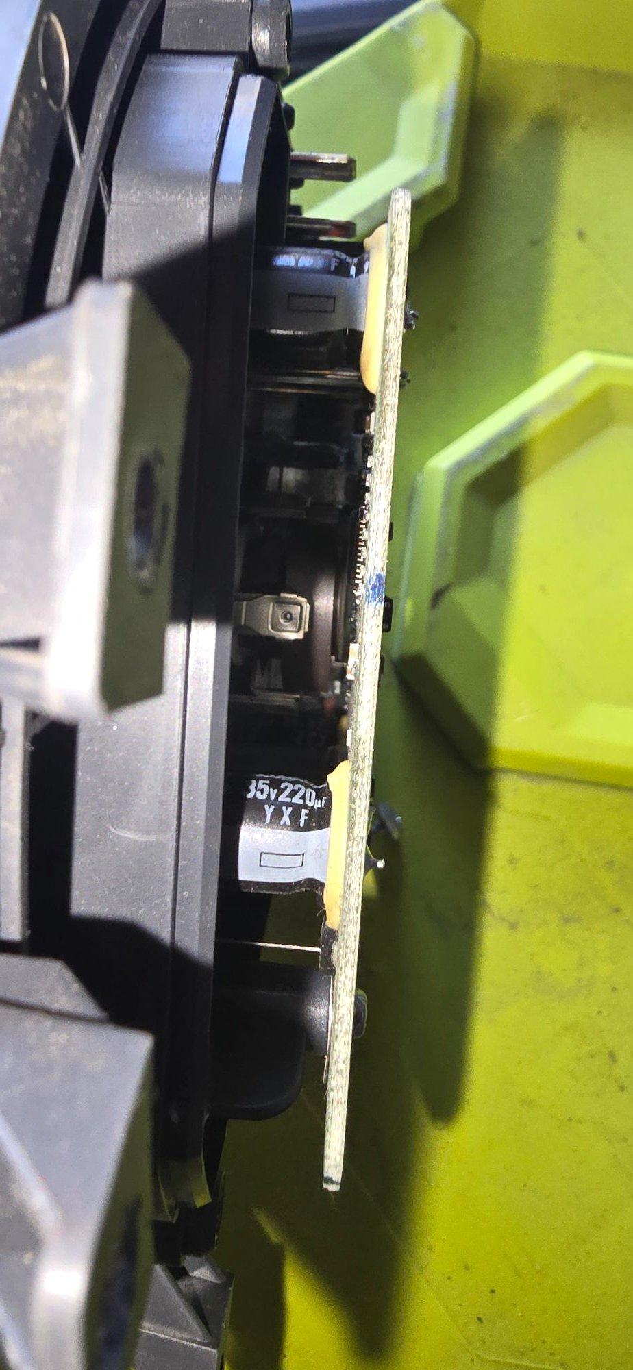

  1. https://streamable.com/w9b20n That's video of inside my dash, no clue where the resistor should go. Also here's a picture of the blower motor open, doesn't look like any resistor is built in but I'm not sure, the screws have solder in them so I can't really pip them out right now but I don't think there's a resistor in there.

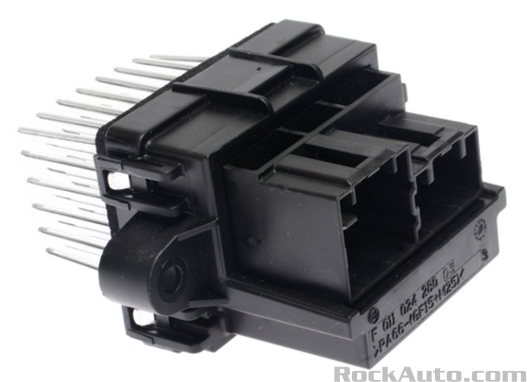

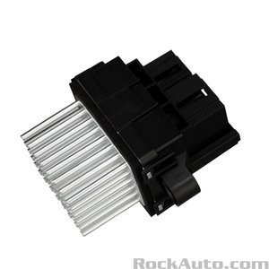

  2. My blower motor doesn't blow hard at all, maybe medium power at most. My controls work, it goes from low to high but compared to my other 2015 2500, it doesn't even compare. Replaced the blower motor, same issue. Bought the resistor from rockauto but can't find anywhere online that shows its location or how to access it. I read on another topic someone said it's built into the blower motor, but when I looked at the new blower motor and resistor, it isn't a part of the blower motor assembly. Any help is much appreciated Resistor looks like this
