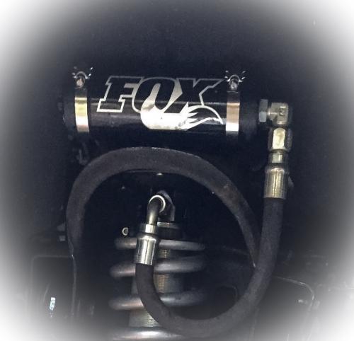

  8. Appreciate it! As for the flares, there's no drilling. They're pocket style flares, the outer bolts just give the look like they're drilled and bolted to the fender. They're held on with clips and bolt on brackets, very easy install and they're very solid. As far as the suspension, it's a little crazy. I actually picked all the Reaper stuff up used off eBay. It had 12k miles on it when the guy took it to a shop to have it swapped out for a 6" lift. Why he didn't tell them to keep the fox stuff, I don't know, because they definetly could have used them with the right spacers and his new kit. I picked the whole Reaper package up for $800 shipped. I had to buy the Superlift kit because the Reaper stuff was for a steel A arm truck and mine is aluminum, plus I wanted to add the differential drop to help the angles and the Reaper Doesnt use them. It cost me $550 from Summit. The add-a-leaf was something I wanted to go with instead of a lift block in the rear because I pull our 21' boat with it and wanted the extra support. It was $80 from Summit. So I've got about $1450 in it, I installed it all myself and then took it and had it aligned (another $80). Not sure if it'll fit in the garage or not... it's occupied by my C6 Vette. D

  10. The lift is a combination of the stock parts off of a Lingenfelter Reaper (all the fox stuff), a Superlift 3.5" kit with new A arms, and an add-a-leaf for the rear. It's right at 4" of lift up front and the add-a-leaf has it sitting with about 1/2" rake in the rear. D
