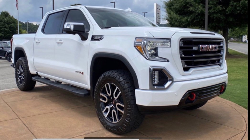

  4. NerdStrong, I think it’s closer to a 295/60R20, too (your 1st guess). I think 285/65R20 (34.5”) would require some serious trimming.
  5. Yeah, they seem too wide for stock tires…20’s or 18’s. I was hoping this was someone’s truck here who could tell me. And they don’t seem stock, because they seem to be Nitto’s, and probably not KO’s… even though BFG’s AT’s are what I want. The truck in the photo appears to have a 1 upsize tire. Wish I knew what it was.

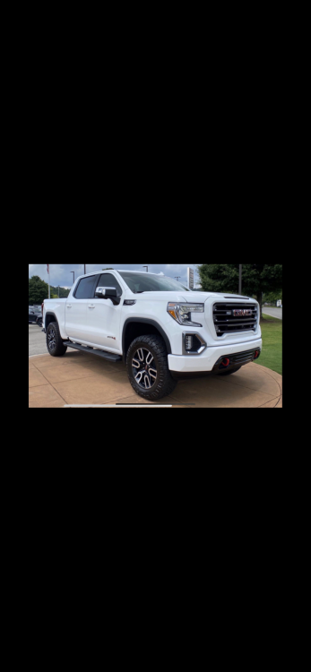

  6. Anyone know, or want to best guess this tire size? It looks leveled, and looks like up-sized tires. not sure if there are wheel spacers. I would like this exact setup. I just can’t remember where I found this photo. I have the same truck…currently running Icon 3 1/2 level (1 1/2” added to AT4) with UCA’s and rear Icon shocks…with 1 1/4” wheel spacers with stock 20 tires/wheels. Thanks!!!
