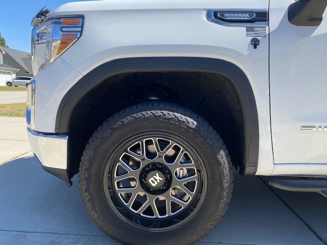

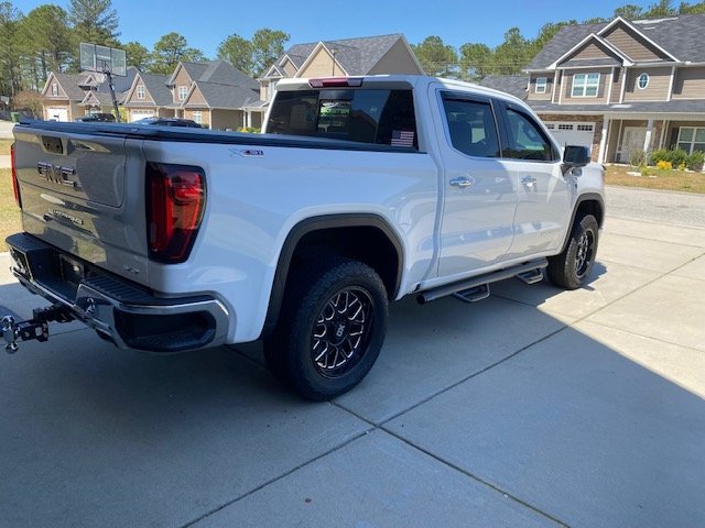

  14. I am new to this site as well as GMC trucks.... long time Ford driver but decided to make a change and move from a Super Duty to a 1500 and went with the Eco-Diesel. I know that when I post this, alot of you will say do not add a lift kit to the Bilstein 5100 Adjustable Ride Height front struts, a fact I did not know prior to the installation and calling Bilstein. Regardless, here is where I am. I added a 3 inch Superlift to my GMC that came with Bilstein rear shocks and 1 1/2 inch lift block as well. All of that was fine and raised the rear from 38 1/2 inch to 40 1/8ish stance in the rear. I added the Bilstein adjustable struts in the front, left them on stock level and added the spacers that were supposed to give me 3 inches of lift yet only yielded 2 inches (measured 36 1/6 inch height before and 38 1/2 inch after). The off road shop told me that when I bring it in for retorque of the bolts, they can adjust the front struct to the second ring which is 1 inch giving me the desired 3 inch front lift and leveling out my truck as well. I do tow a bass boat often and also added Firestone Ride Rite air springs in the rear to avoid the "sag". My question is really not can I add spacers on top of Billsteins, it is has anyone added suspension lift and not got the height that you thought, in my case I only got 2 instead of 3? My truck came with the X31 package and had Rancho shocks, wonder if I put them back on with the spacers would that give me the 3 inches to lift and level or just adjust the Bilsteins up one inch and in theory it should alleviate some of that rake and level it all out. My lift also came with Control Arms and other stuff to help with Angles etc. Any advise OTHER than dont add spacers with Bilsteins? Thank you. Here is a after lift picture as well. or just leave it with that built in rake.
