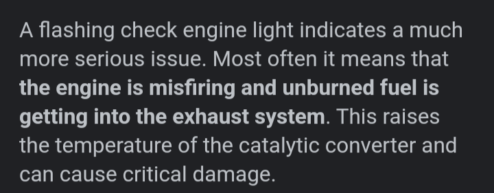

  3. I have no choice I had a full scan done and the only thing that came up was a engine misfire on cylinders 3 and 5 and I was told to change the ignition coils and wires so that's what I did but the engine light keeps coming on and blinking from my experience that indicates a bad cat maybe I should perform a smoke test to see if there is a vacume leak somewhere just hoping someone out there might of encountered something similar
  4. Check engine light blinks and when the tranny downshifts the exhaust vibrates really bad only when dropping into a lower gear it was giving me a code of engine misfire on 3 and 5 so I replaced all ignition coils on negative side all new spark plugs driver and passenger cleaned my throttle body and reset it but I haven't tried changing my 02 sensors just need some different opinions on what it might be causing my check engine to blink that's usually something serious
