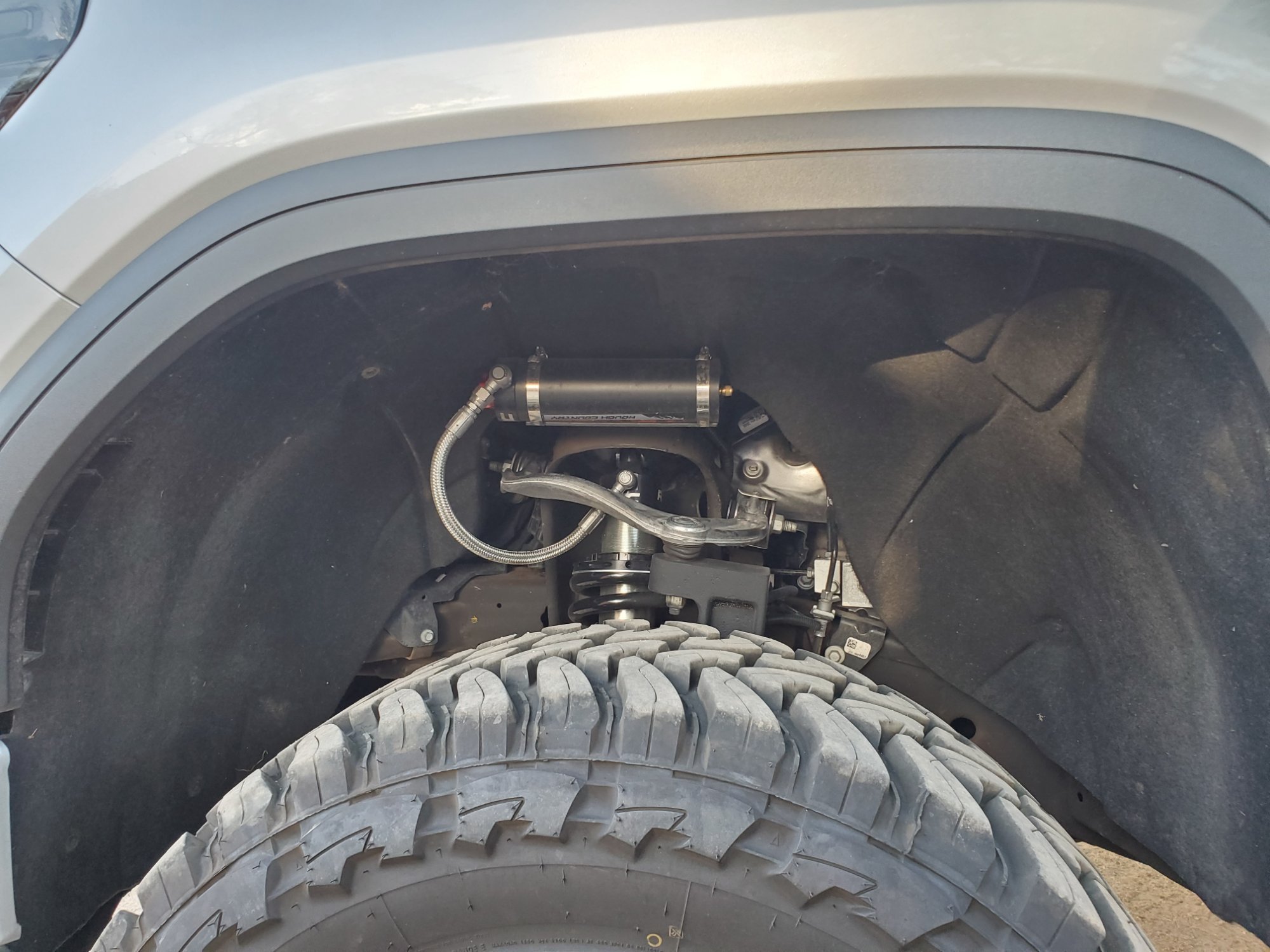

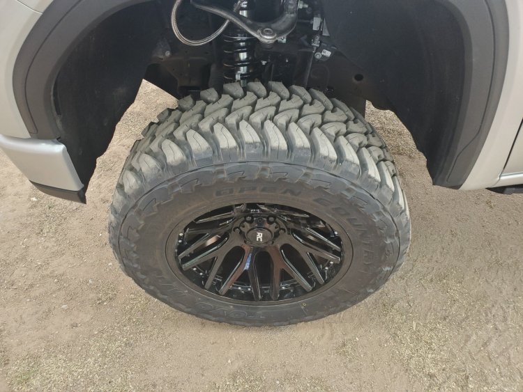

  3. Mind you, I have a 6" lift with 35-12.50-20 Toyo Open Country MT's on 20x10 wheels with -25mm offset. If you do need to trim the wheelwell liners or plastic, use a pair of tin-snips. Clean cuts and lines.

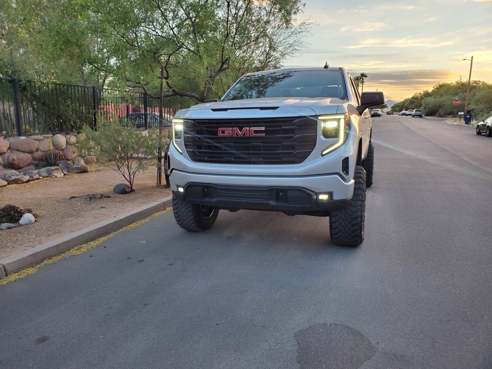

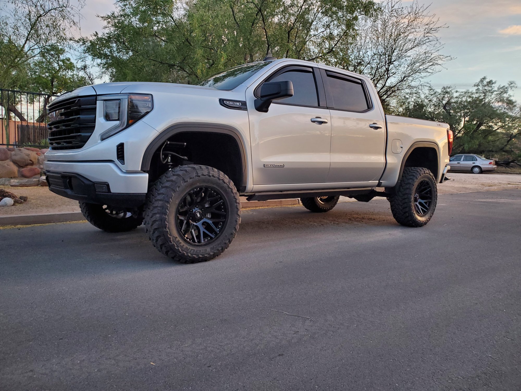

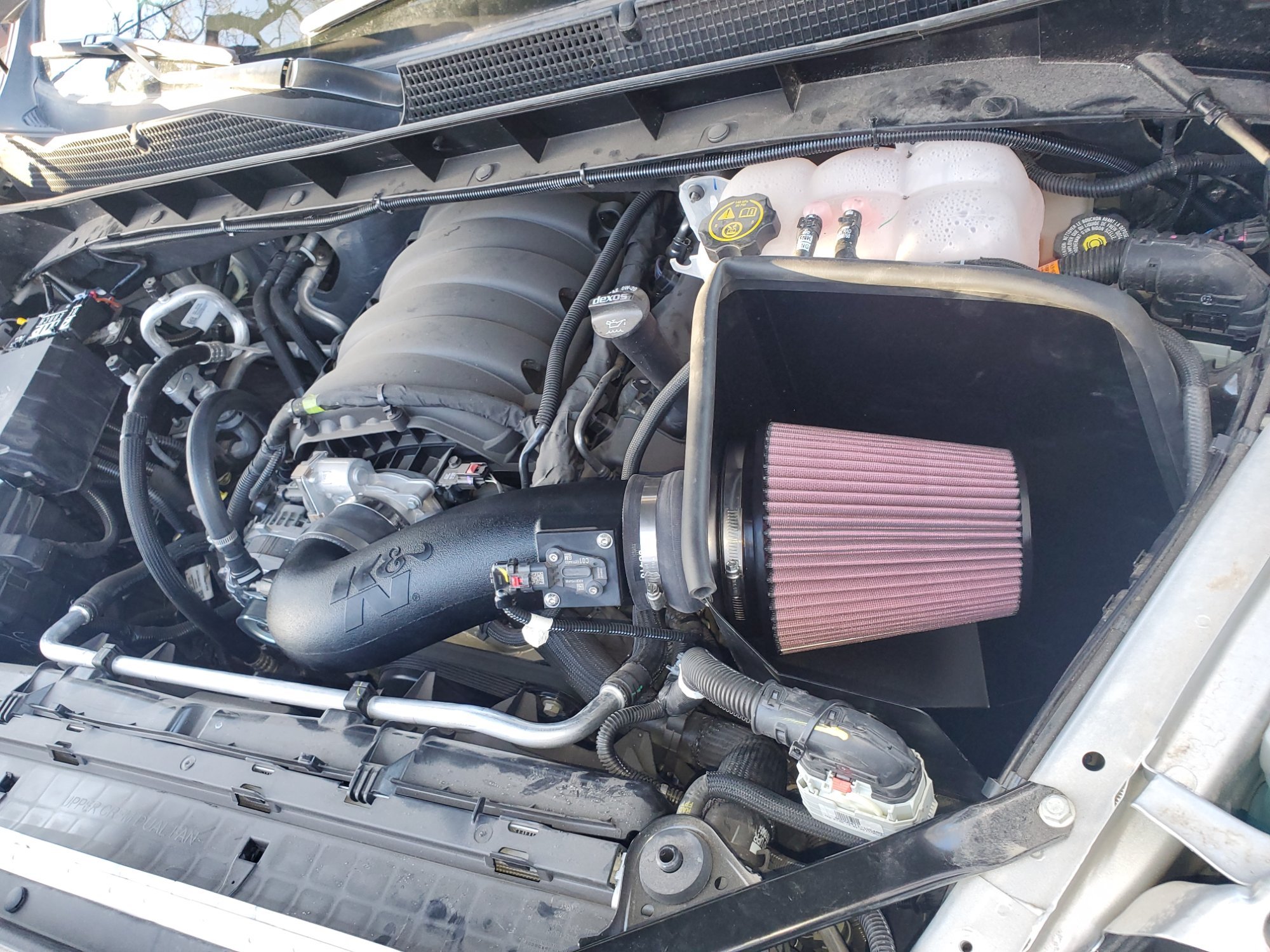

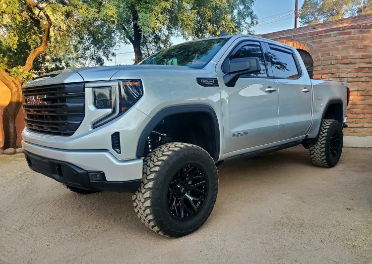

  9. Pictures are of my 2022 Elevation x31. 6" Vertex remote reservoir coilover lift, 35-12.50-20 Toyo Open Country MT's on RC 95 series 20x10 wheels. AMP power steps, K&N intake, MVRP muffler delete. Also added 20% tint on the front windows, Weathertech window guards, Husky floor liners, RC under seat storage box, and a Pedal Commander throttle controller. I'm considering re-gearing to 3.73 from the factory 3.23's, but I haven't decided yet as the 10sp seems to be handling the 35's pretty well.
