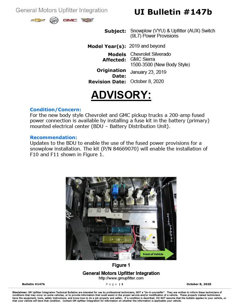

  9. That kit is actually a plug and play for the primary fuse block though you could use it on the auxiliary block with some modifications. I just installed it on mine.
