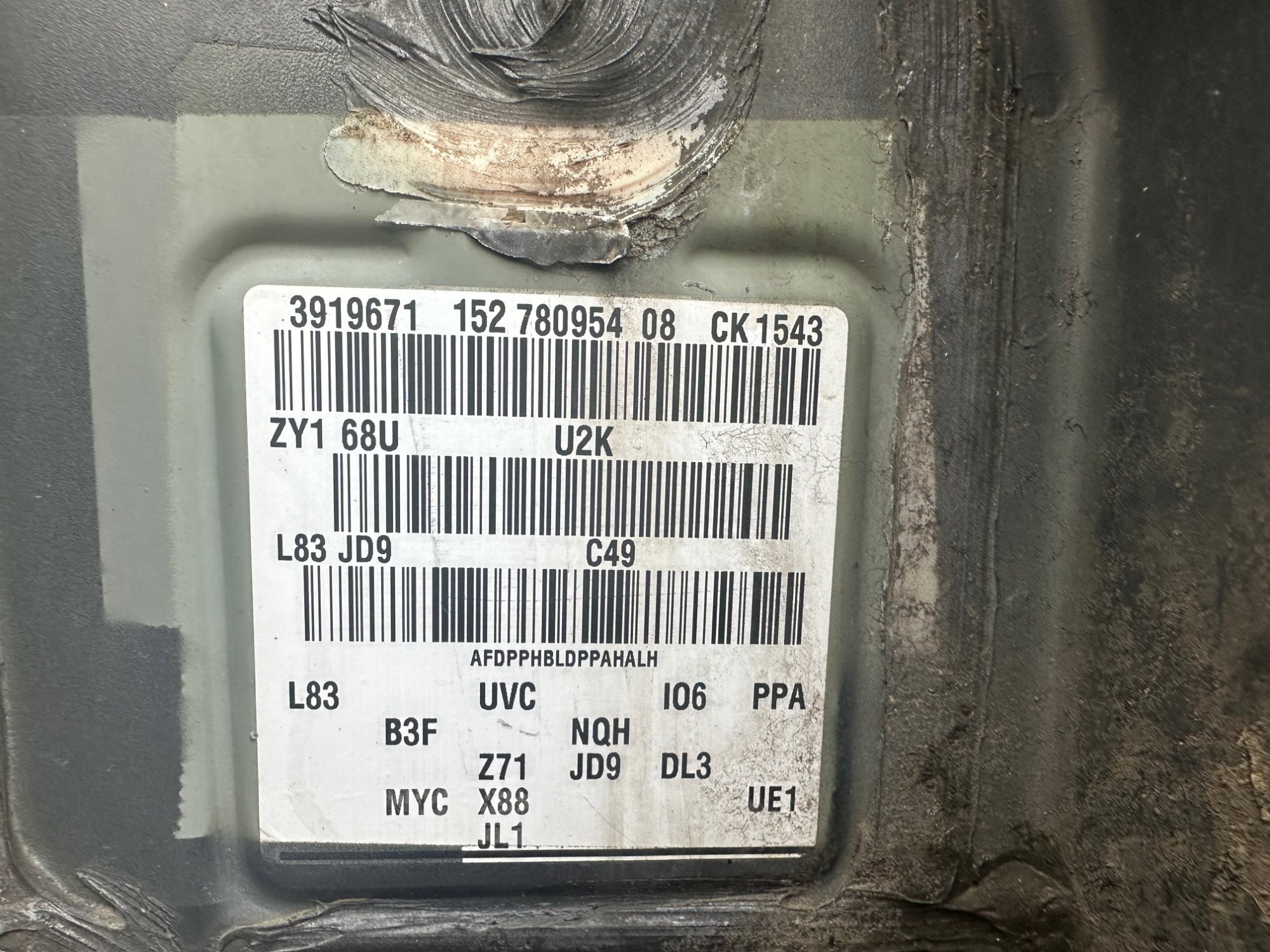

  3. I just found the window sticker for the 2019 LD, and it says the rear axle is 3.42 ratio. I assume the front is the same. I've attached the photos of the vin and another sticker from the 2015 z71. not sure if it helps @newdude @mikeyk101
  4. Do you know if the numbers on the stickers shown in the photo are any indication of the gear ratio?
  5. Well, looking back it looks like the question was already answered by Newdude. Sorry, I guess its been a minute and I've slept a lot since then. .. But can anyone confirm is the gear ratio on the 2019 is the same as the 2015 1500 z71? Thanks,

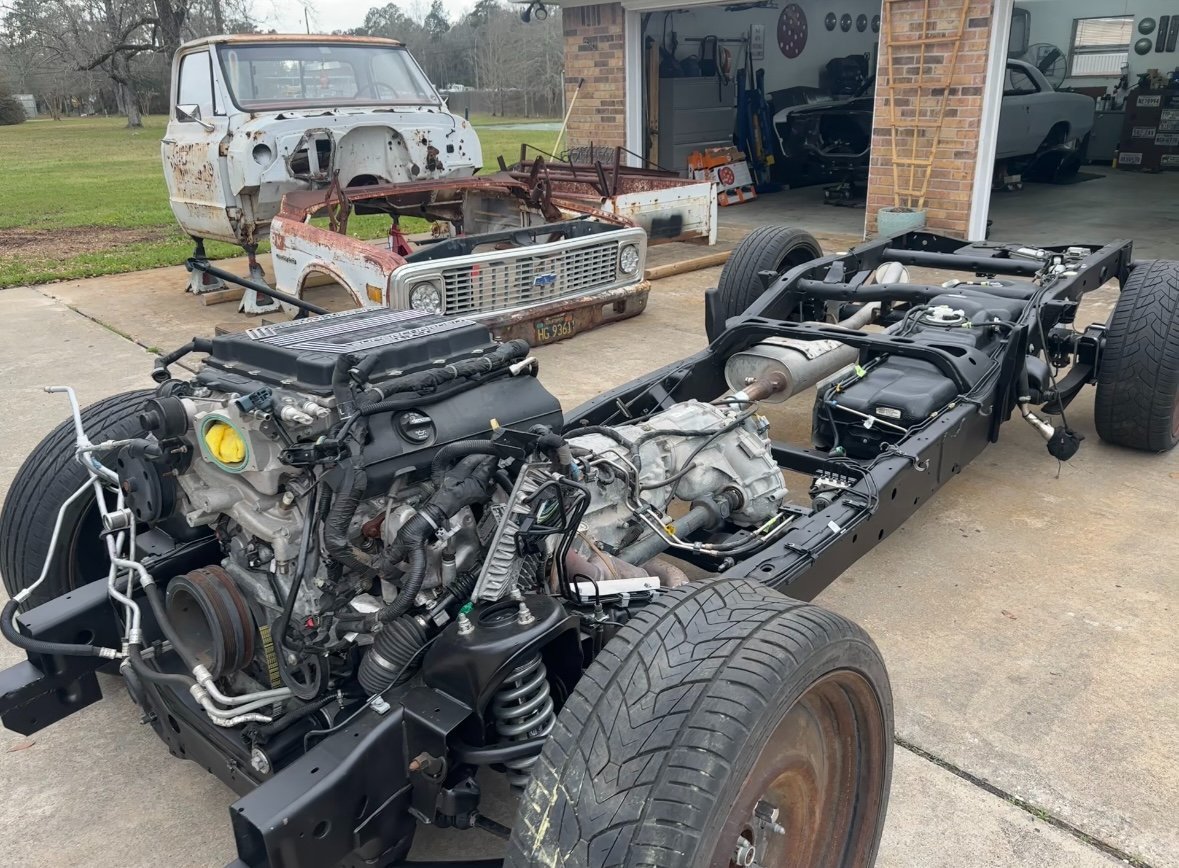

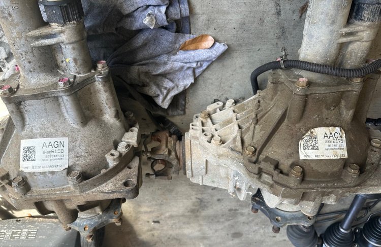

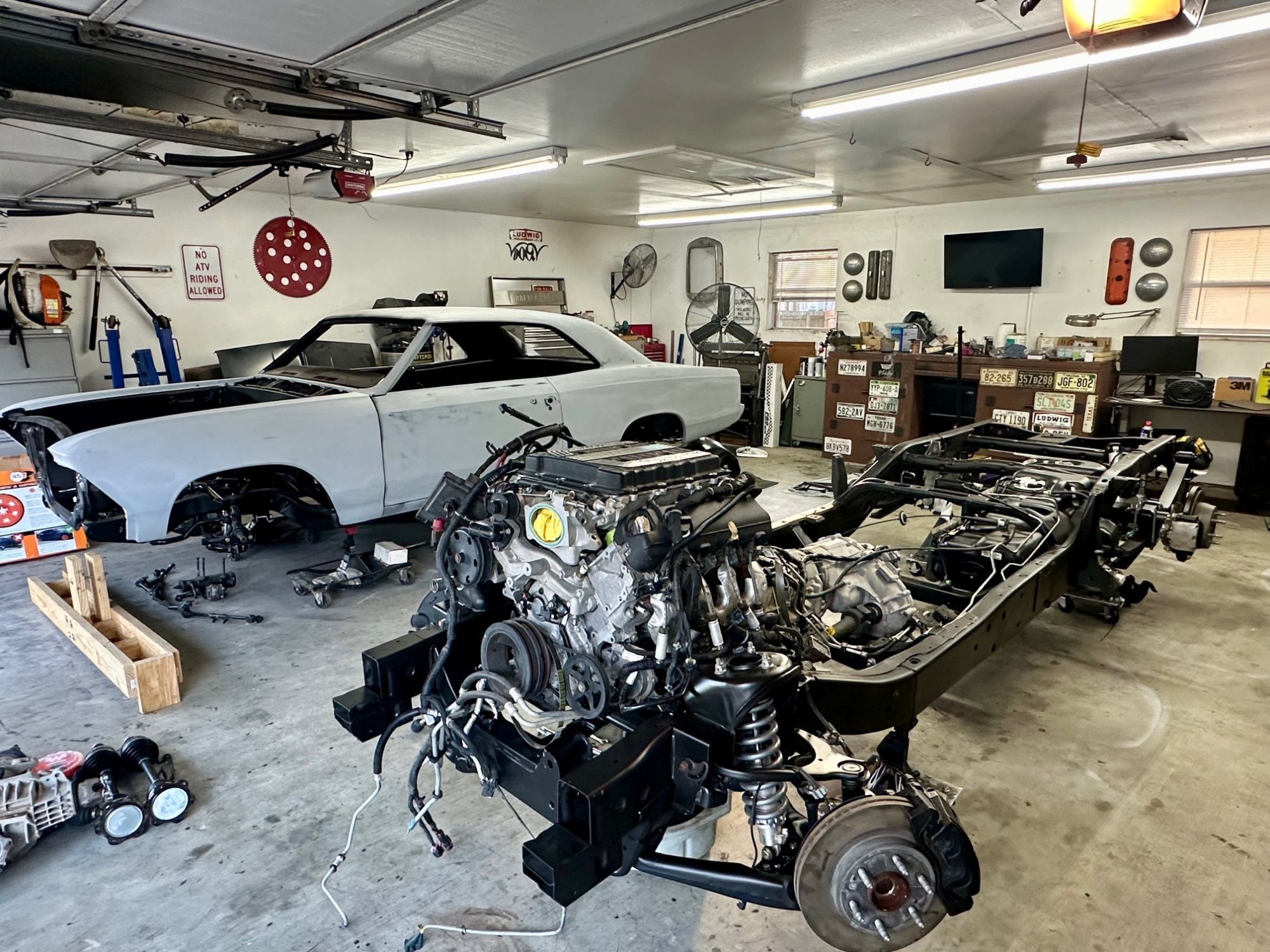

  6. Ok so the front differential from my 2019 1500 LD is cracked (left). I picked up a front differential from a 2015 1500 (right). Can anyone tell me if the 2016 differential will work? See attached pics. I also attached a pic of how the chassis looks now. Just trying to get everything bolted up, brake and fuel lines ran before putting the body back on. Thanks for the help! Jeff

  9. I just got the truck from a friend so as of now I don't have any build pics ,but I'm currently backing up a bit and taking it apart. I'm redoing some of the work that was previously done cause i think the frame has damage.

  11. Newdude, thanks for the information, Much appreciated! Now I understand why I've been seeing conflicting information. Any idea if the front differential is the same?

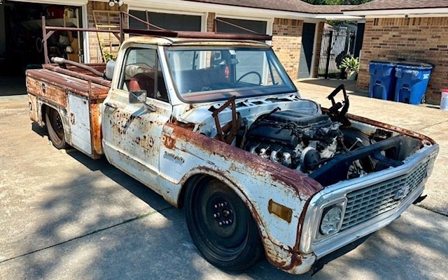

  12. I'm new to this site but couldn't yet find the information I'm looking for. Hopefully someone can confirm or point me to a previous post. I have a 71 Chevy C20 that's sitting on a 2019 Silverado LD 1500 4WD Z71 Chassis/Suspension/Drivetrain. There is an issue with the frame so I need to replace it. I found a 2015 Silverado 1500 4WD Z71 that I can use for parts. Can anyone tell me if the chassis is the same? Will all of the 2019 drive train bolt to the 2015? Also, do you know if the rack and pinion and front differential from the 2015 will work with the 2019 components/ computer? Thanks!
