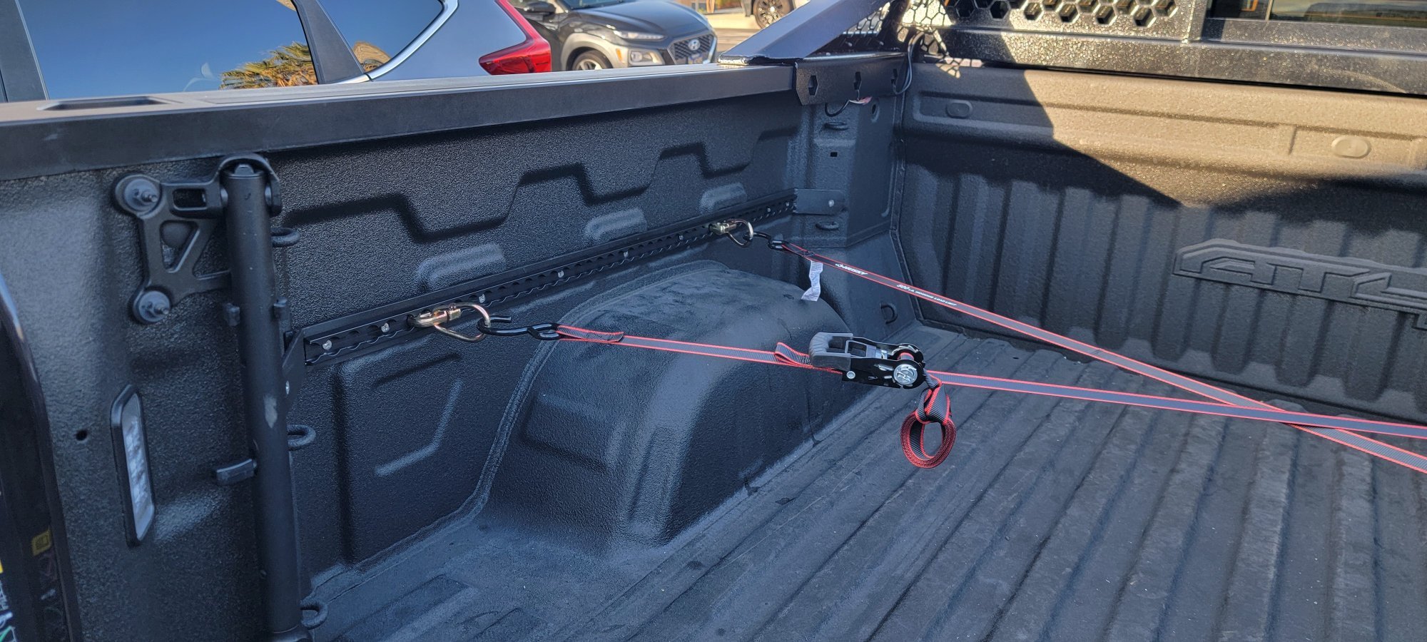

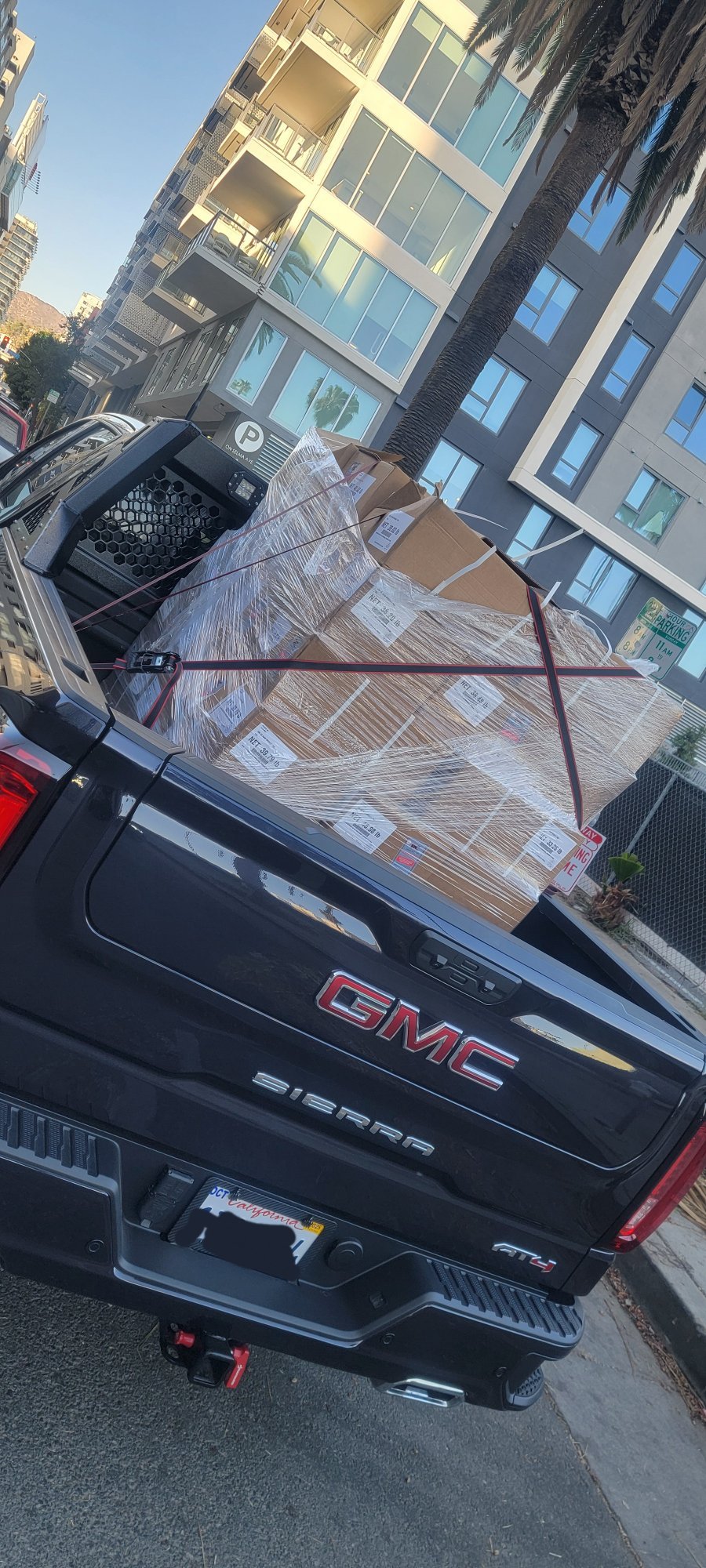

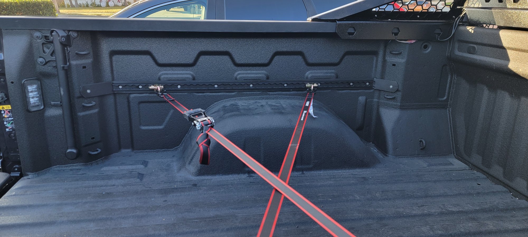

I have a custom piece of 1/4in steel that is bolted on the ends, then the track is bolted to the steel every 6in, except where the three plugs are on the sides, those are thru bolted from the track thru the steel and into the bed. I haven't put a dyno on it, but I used them to tie down a 1400lb pallet of brisket and they held.
