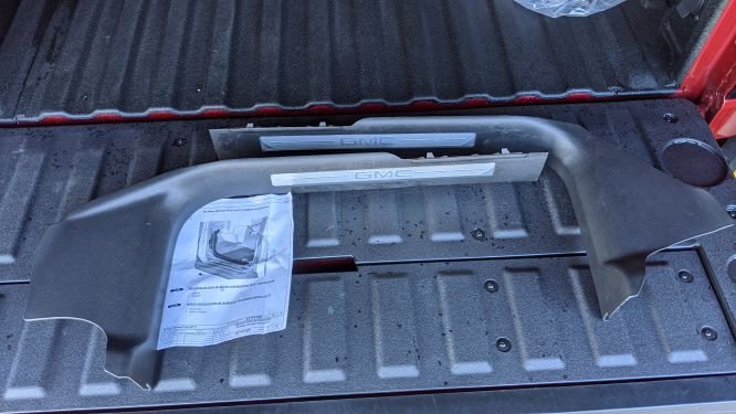

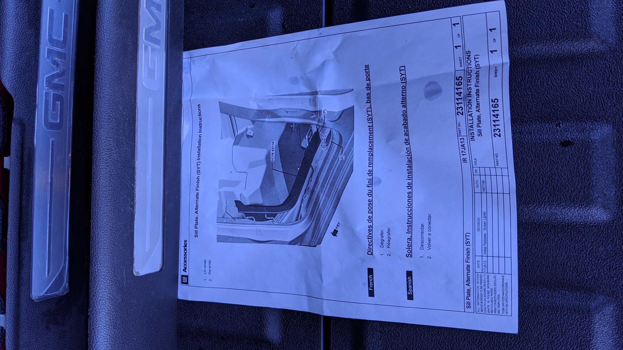

I have a couple parts I removed from my 2014 GMC Sierra SLT. Front Door Sill Plates with Jet Black Surround and GMC Logo. Still has plastic over the metal insert. Part No. : 23114162 75.00 Plus actual USPS shipping cost from 18707. A set of LED tail lights made by Eagle Eyes. Passenger side turn signal will start to flash faster if left on. These will only fit a GMC Sierra 2014 -2018 1500 Series. 110.00 Plus actual USPS shipping cost from 18707.
