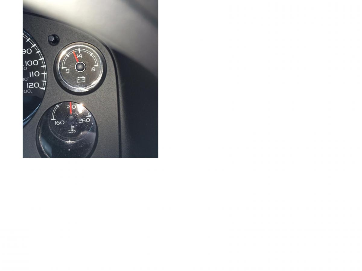

  2. Well it looks like my alt is bad. Here are two pictures of the gauge today. Both were taken at idle but it did the same thing while driving. It wouldn't fluctuate quickly but at random. I would look down and its dead on 14 then look down about 5 minutes later and its a good bit below 14.. I tested it with a volt meter I have at the house and the highest number I got was about 15.1 and the lowest was about 12.4 (this was at idle) on the same trip. Then went to Advance and had them test it. The voltage was only running high when we tested it at about 15.1 (same as I got) but it never dropped below 14 at Advance (it did it again on the way home though). I'm thinking it's the voltage regulator in the alt but I'll replace the whole thing. The good thing is that I won't be driving my truck for 2 weeks starting tomorrow so I can replace it when I get back since the part won't be here before we leave. I'll just pick up a new AC Delco from Rockauto for $157 vs. AAP (ToughOne) for a remaned for almost $190. I did notice that my truck has the DR44 alt (KG3 RPO) on it now but the 145 amp on Rockauto and AC Delco's part site has the DR44 as the 160 and DR37 as the 145. Mine is stamped with 145 A. Did they change the casings at some point or does that even matter?
