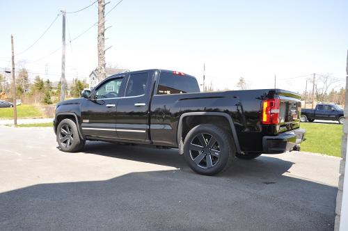

  1. It rubs a tiny bit at full lock if the ground is not flat and a tiny bit during very hard cornering when the body rolls. I'll check it in a few weeks and do some trimming if needed.

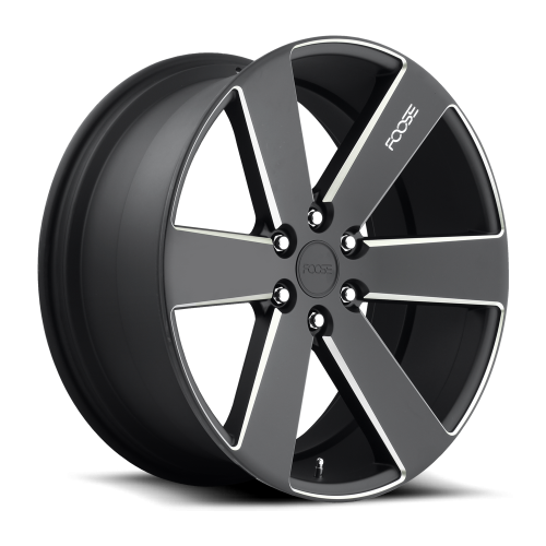

  2. Foose http://www.mhtwheels.com/switch-f158-w-6089.htm 20X9.5 30+ Offset. I think they have the stance I was looking for. The truck is lowered 2/3. Tires are 305-50-20 Toyo Proxes 2
  3. Hi Folks, Great forum and my first post I believe. I have a 15 GMC All Terrain 6.2 . It is a 4x4 d/cab, lowered 2/3. I have these wheels. http://www.mhtwheels.com/switch-f158-w-6089.htm 20 inch I prefer to run Toyo Proxes STii but they don't come in 285/55/20, which is the size I believe I should have. The wheels appear to be 30+ offset and I am not aware of the stock wheel offset. With the truck being slightly lowered, I want a tire size to fill up the wheel opening and the rim not to push the outer edge of the tire past the lip. I think 285/50/20 would leave more gap than I want. I notice a lot of trucks in this thread running 305/50/20 which may work. So.. What is the stock wheel offset Are the wheels I have going to push the tires out too far for a lowered truck. Any recommendations for tire size as well as brand and model.
