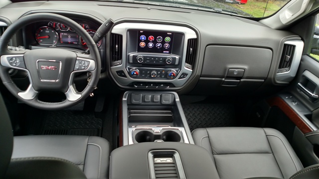

  16. Im still on the fence about this. I would love to do it, but I want to be exactly sure of what I am doing before i break into the dash of my brand new truck. So after reading this like million times...I think I am closer to understanding what was done here, lol I have pedals, TC, and cargo lights/bedlights. (3 switches, it is an SLT). It would be perfectly convenient if I could just buy the first upfitter switch bank with that blank one in the third spot and the 4 AUX switches. But can I use the blank spot for a switch (my 3rd position is cargo lights), or is it just a blank? Otherwise I would have to buy the other one and do what you did here. And on another note, why did you bother soldering anything to the board and bothering with those special terminals and using the OEM plug? I dont understand where you are going to plug in those small plugs with red/bk wires going towards switches?

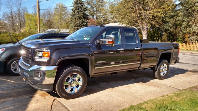

  18. 2016 2500HD SLT Iridium Metallic: Besides what you can see, installed hidden bed step from AMP and AMP power steps(Best buy ever).

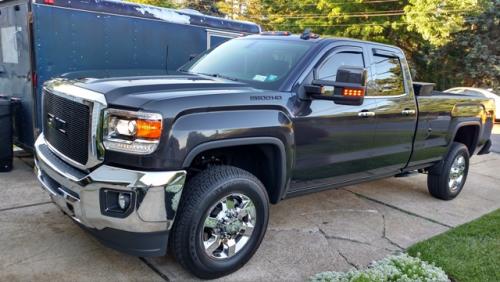

  20. Here it is, sorry thought it loaded. I cant believe how much bigger it looks and feels than my 2006 2500 Sierra. These things are soo luxurious, I'm not used to it... feels like i'm driving someone else truck.lol That factory spray in bed liner it killer! Its no match to the consumer products. And I love all the electronic convenience that come with the SLT package. Like the auto fold in mirrors that angle down when put in reverse, and factory remote start and lower windows...I feel spoiled! Just have to install the Iron Cross steps i got.
  21. 2016 GMC SIERRA 2500HD SLT, DOUBLE CAB, 8' BED, IRIDIUM METALLIC, BLACK LEATHER
