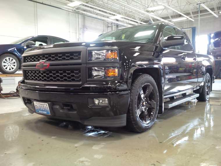

    blings 14
  5. From the album: blings 14
    ordered with black tips
