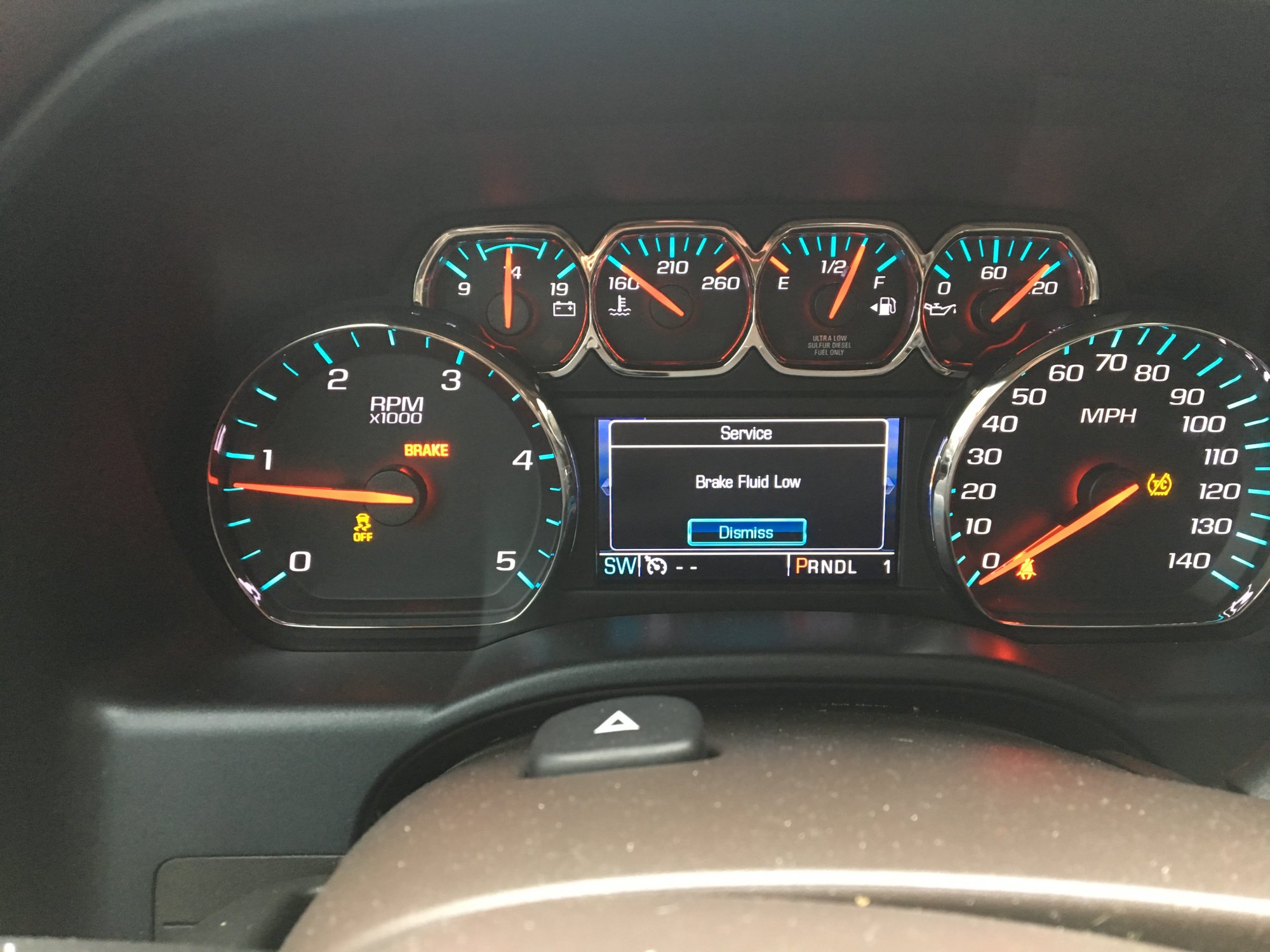

  2. I have a 2017 Silverado 1500 and just this year when the cold weather started, in the mornings when I start driving I get traction control off, stabilitrak off, and brake fluid low messages. I don't lose power and nothing else happens. After the sequence the traction control turns back on. It does it when I start accelerating and sometimes just random while driving. Anyone having this problem?

  5. My warning lights come on when temp outside is in the 40’s and below. It says “ Low Brake Fluid, Stabilitrak Off, Traction Control Off” and this morning it also said low coolant. I live in south Florida so this happened last year when I went to Ohio in December, the truck had 12,000 miles on it. Got back to Florida and it happened one cold morning so I took it to dealership. They could not find anything wrong. Later with 38,000 miles the low coolant light came on. I took it to dealership again, they could not find anything. Now I am back in Ohio for Christmas and the lights started coming on again when I got into colder weather. They do go off at times while driving but come back on within 10 minutes if the temp outside is still below 40. It is very annoying as the warning bell starts going off and the lights flash. Any advice?
