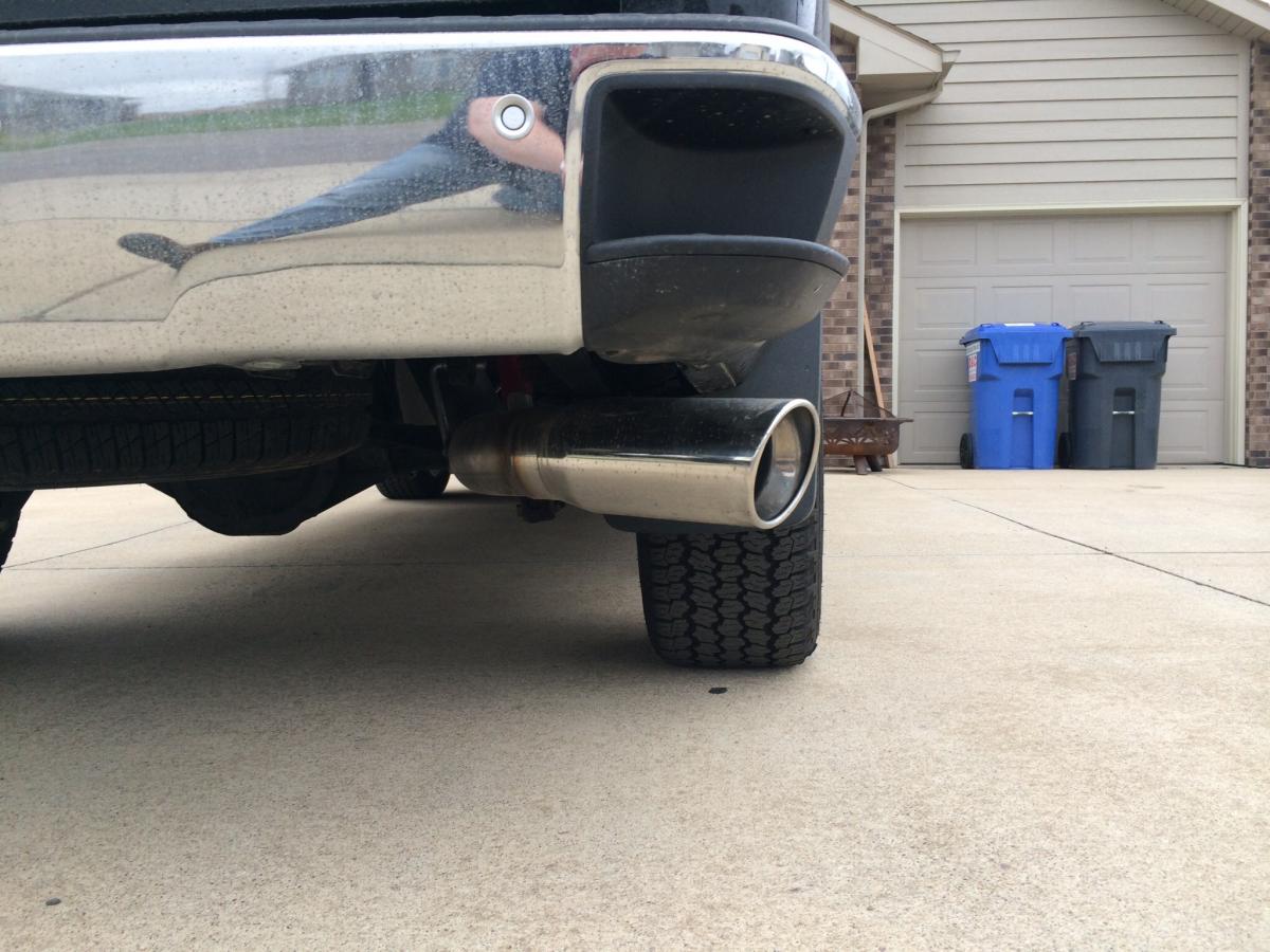

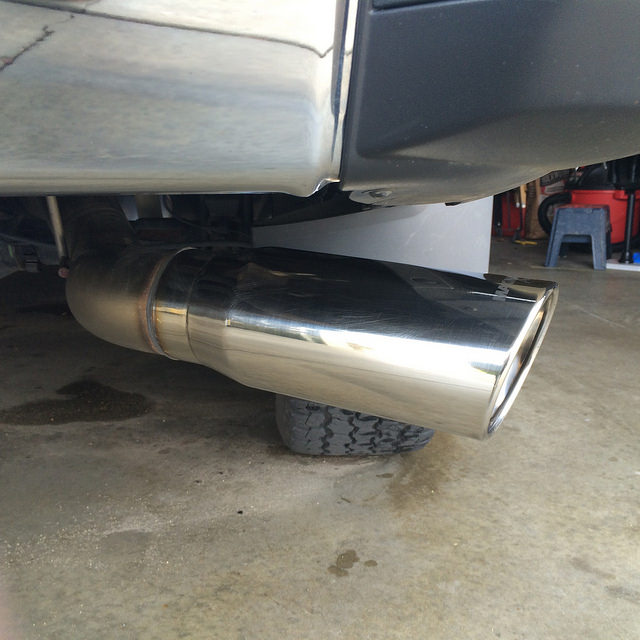

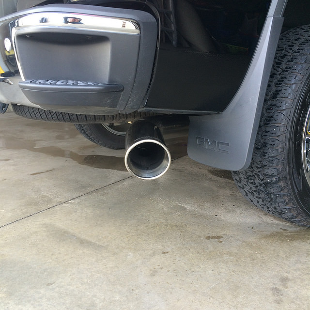

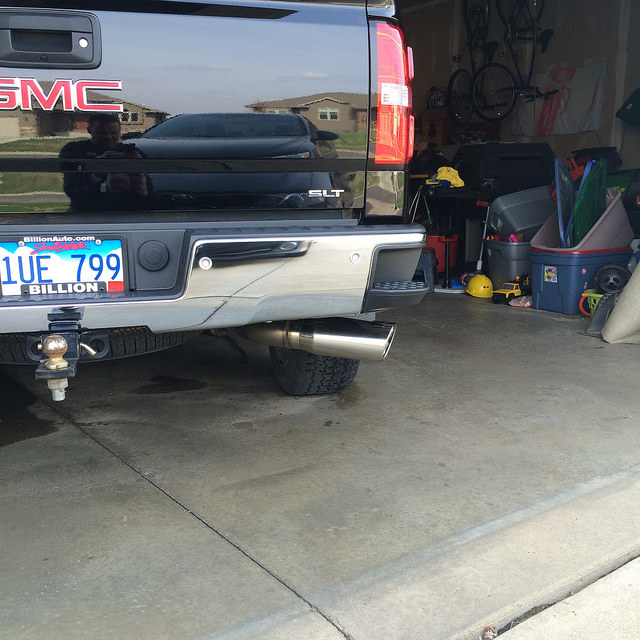

  11. The Magnaflow #15318 exhaust with the kenworth stack has been removed! I now have my factory 6.2 exhaust back with a 22" Magnaflow muffler and a custom tail pipe w/ no flapper or resonator and I'm happy as a pig in sh-t! Sounds awesome not to loud, no drone except an annoying flutter sound in V4 which I had with the cat back exhaust. The only thing that sounds like crap is my Volant CIA. I ordered a airaid MIT 200-996 tube and a couple of threaded PVC adapters so hopefully the factory air box is quieter.

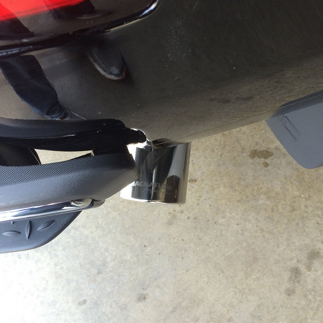

  13. Have them cut the flapper valve out it's restrictive even when clamped open, it shouldn't cost you anymore as its right behind the factory muffler.
  14. Billion GMC where I bought my truck, they are a Magnaflow dealer. If the flange doesn't fit have Missle Muffler call Magnaflow..do not cut the flange off the factory exhaust to make it work. I'm going back to the factory exhaust with a 22' Magnaflow muffler minus the flapper valve.

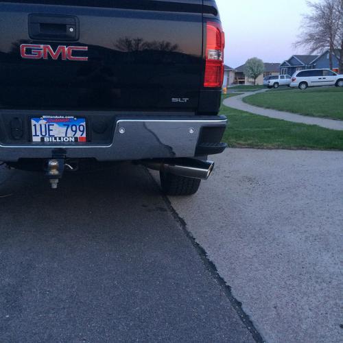

  17. I think the 6.2L 15318 kit sounds Fing amazing!..Just looks like sh!t..maybe it would look better if the five inch tip came straight out the top of the hood! Then I could hang a bulls nut sack off my hitch.
  18. I will post some pics tonight so you can see how hideous it looks. I ordered it because their website specs said the Tip was 4 inches. My 2009 GMC 6.2 factory exhaust was 3.5 OD with a 4 inch tip, I liked that look. The 14 factory exhaust is 3.5 like my 09 was the only difference is the goofy flapper valve and the exhaust is reduced to 3 after the resonator on the 14, and like others have pointed out the 14 exhaust is pretty stout. My accessory guy at my GMC dealership recommended adding the 22" Magnaflow and deleting the flapper valve from the beginning, but I insisted I wanted the 15318 kit..wish I would have listened to his recommendations.
