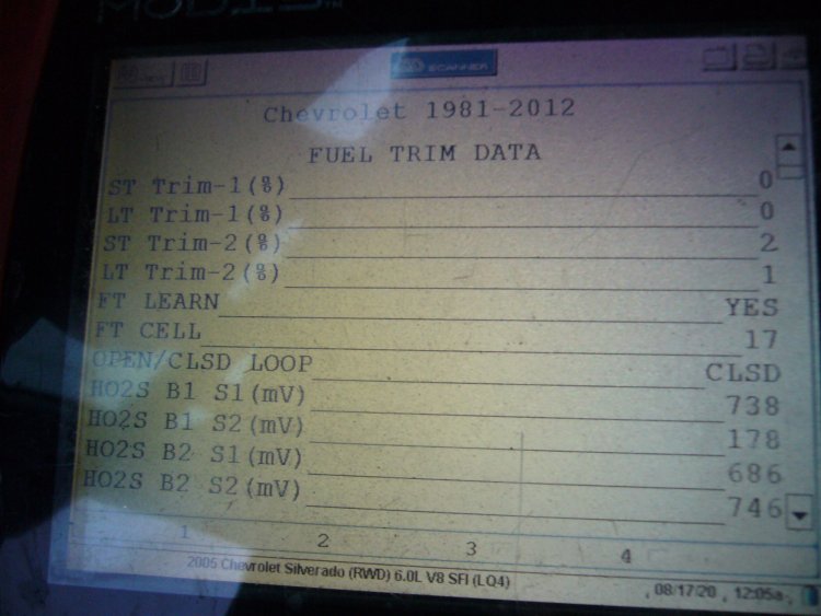

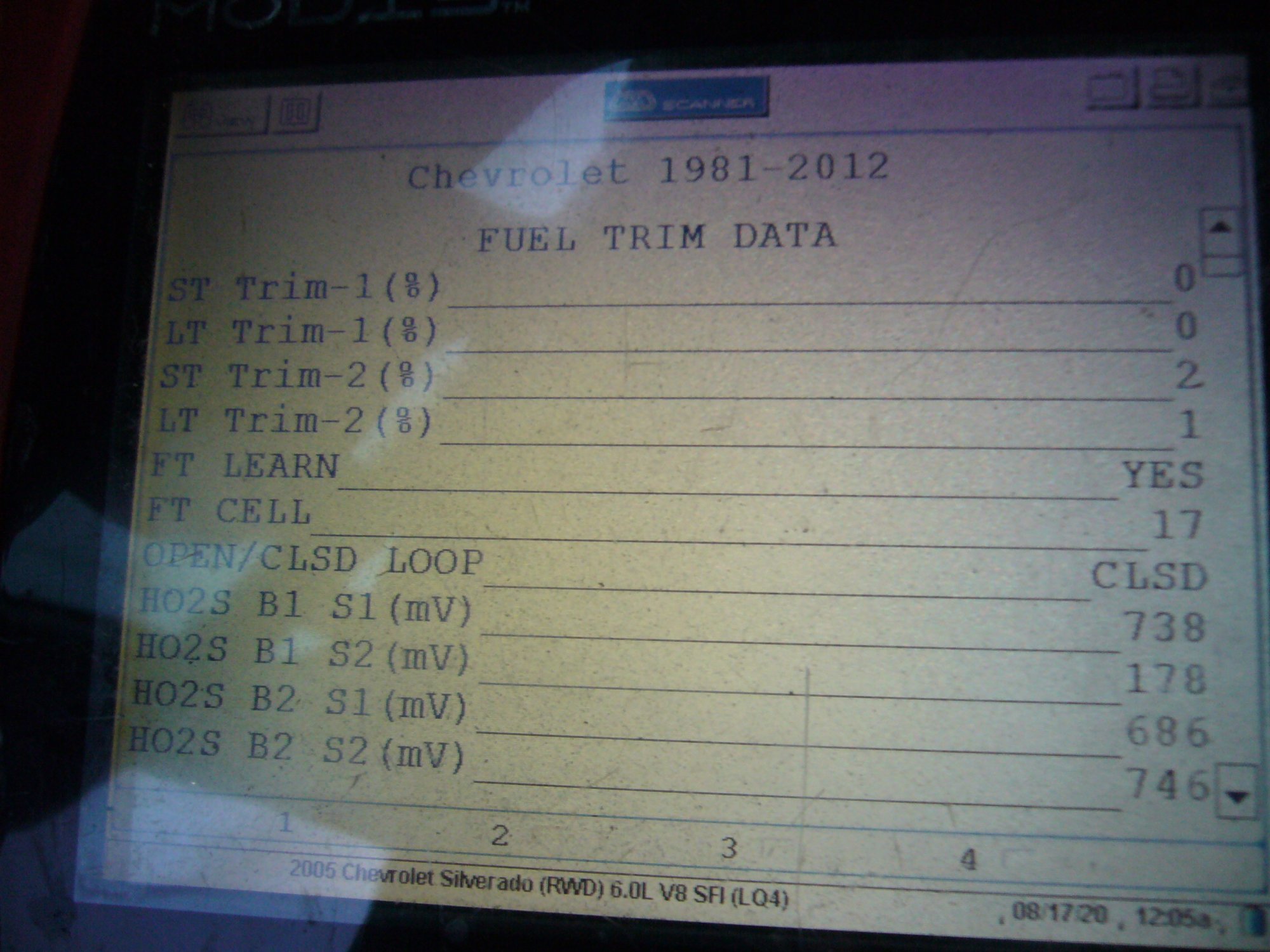

  9. ok, my truck sometimes misses at low rpm parked or stopped in drive(at a light), its a 05 silverado 2500hd 6.0 base 2 door rwd, 86,000 miles. i've changed (using all ac delco or delphi electric products except) msd coils , msd wires, ac delco platinum spark plugs, crank sensor, cam sensor, map sensor, cleaned the throttle body and mass air flow sensor (with correct fluids), exhaust manifold gaskets and broken bolts, gas cap vapor canister purge valve, vapor canister vent valve, ac delco knock sensors with gaskets (few years ago), cleaned the grounds (i could find), fuel pressure is good, no dtc codes. still at idle the engine will kick down to about 560 rpms and will have a miss or sometimes not (but the miss will come it will come than stop than start), rain or dry, hot or cold outside. RUNS STRONG other than that and using high test gas 93 octane. i have a hyper tech mpg programmer but same miss happens programmed or back to stock. thanks for your time!
  10. I use hypertext in my 05 silverado, plug it in, asks questions, runs programs on truck computer and unplug when qued too.
