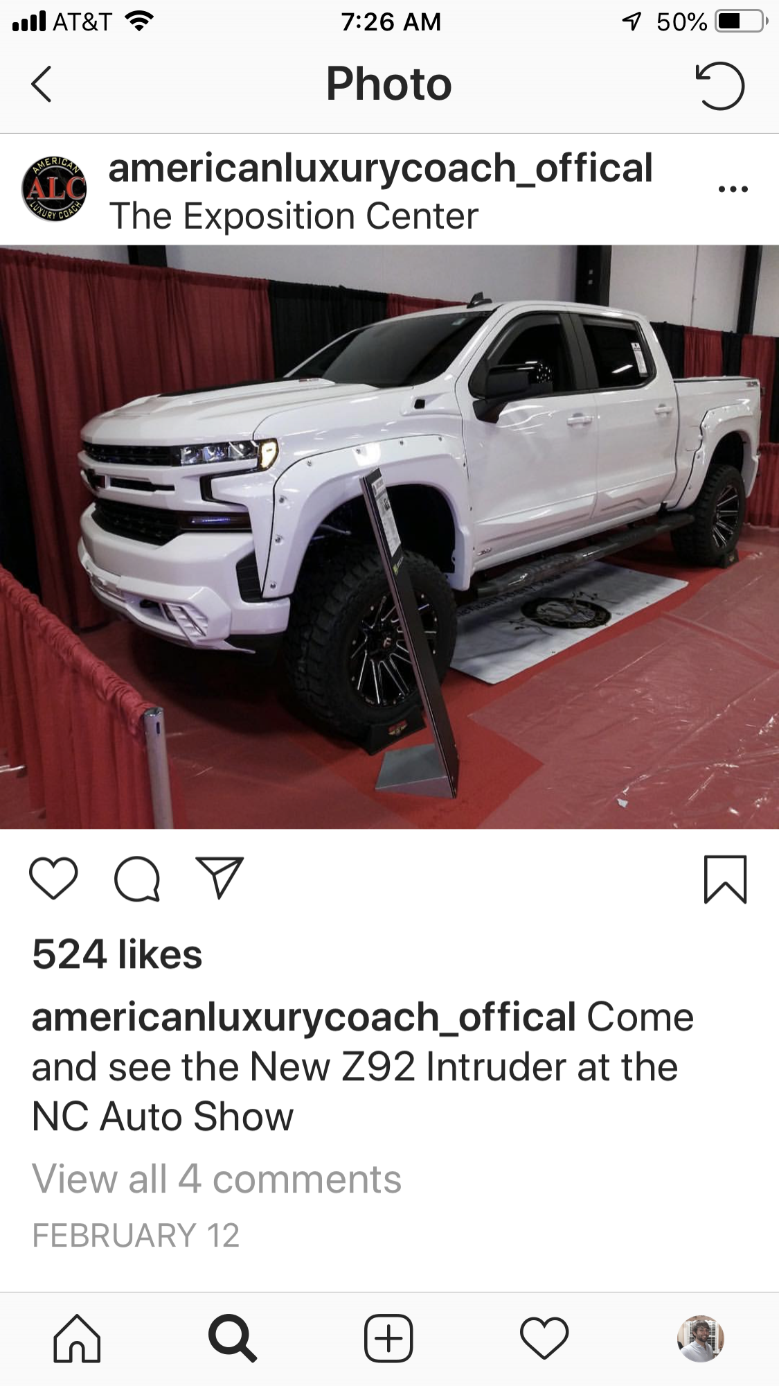

  21. I think I found the conversion package from American Luxury Coach
