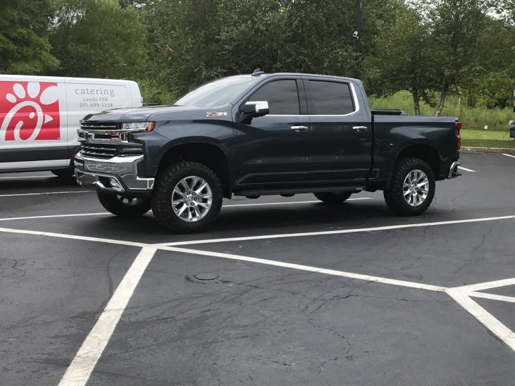

  8. I measured and mine is about half an inch too tall in the front. I am going to contact Readylift about that. Any chance you can send a picture of the angle of your cv axle?
  9. The 2 inch GM kit is a taller strut... no spacers. That is where they get the 2 inches. This isn't stacking spacers on spacers. This kit from Readylift was specifically designed for the Trailboss and AT4
  10. Yeah man that looks good! You are right... it does look level. I will measure mine when i get a chance and let you know what it measures. You measuring from the ground to top of wheel well?
  11. Thank you! I haven't measured but it looks to me like the front is just a hair taller but hopefully it will settle over time. If it doesn't, i might take out the bottom strut spacer and see. I am running a 275/65/20 Nitto Trailgrappler. Can you send me a picture of your truck? Do you have on looking straight on to the front?
  12. 2019 Silverado LTZ with Factory 2 inch Trailboss kit... additionally, I leveled it with a 1.75 inch kit from Readylift. Stock number on www.readylift.com is 66-3921
  13. I know my truck is an LTZ but I had GM add the factory Trailboss lift a few months ago. Today, I installed the 1.75 inch leveling kit from Readylift and love the stance. I hope this kit works out with no issues. The product number on Readylift's site is 66-3921
