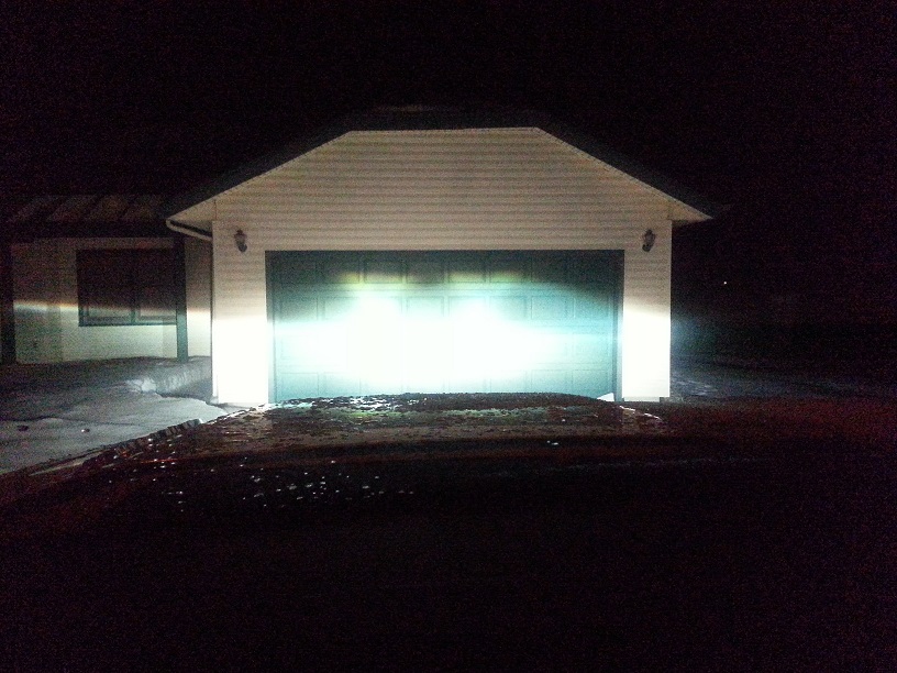

HID Headlight Bulbs / HID Projector Retrofit
onsteder replied to MotoMedic's topic in Modifications & Accessories
I'm not even sure mine are on left to right...i was mostly concerned bout getting them level on the horizontal plane. When I pulled up to the neighbors garage from about 20-25ft away it appeared as if they were shining about waist high and the distance between lights seemed to be about the same distance the lights are spaced on the grill. I'll try to get some pix tonight when it gets dark.- 3,363 replies

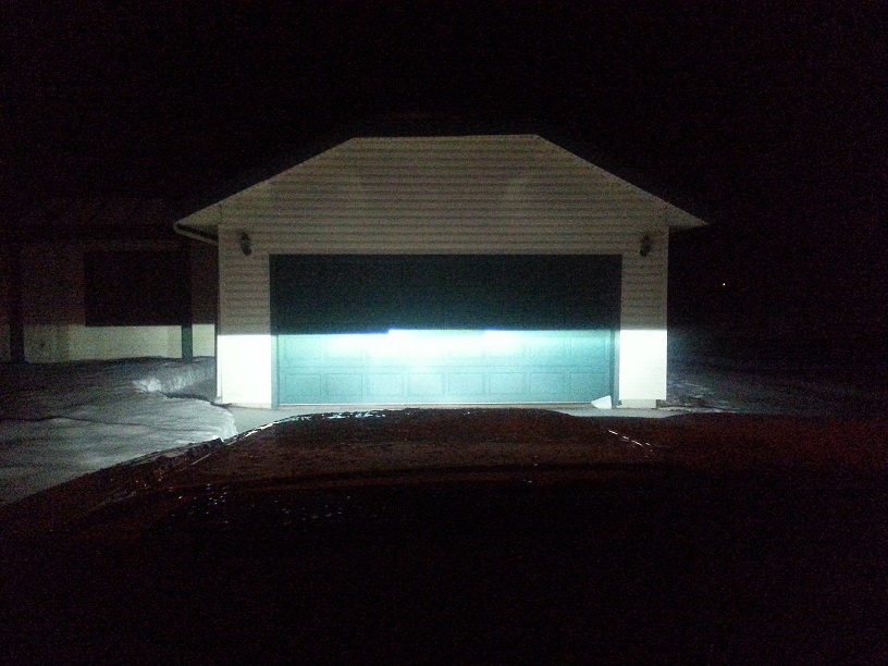

Not sure how the rest of you leveled your projectors in the housing but I had a hard time getting them level. I had to keep taking them apart and making adjustments until it was just right. The output looks absolutely awful if both lights are not perfectly level. Now that I have it all leveled and aimed, the output is amazing compared to stock. I think I need to find some cooler running high beams now because when I flip them on they look like yellow candles Any recommendations on high beams that would match up with XB35 -5500K?- 3,363 replies
