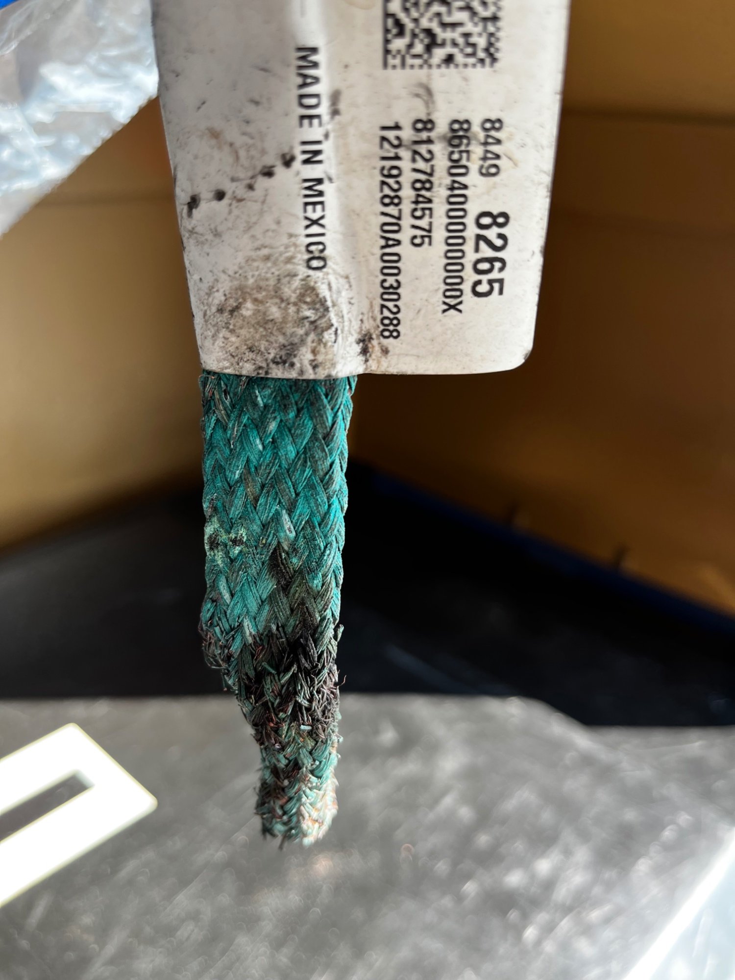

  8. 2020 Sierra 1500 Denali 6.2 About a week ago I had a strange bunch of error issues, no power steering, running boards going backwards when the door was opened etc. Never tried other features like active cruise control or lane assist. I thought it was an old battery issue, but found out on this forum that it could be a bad grounding strap -that was what the problem was and it seemed to fix all of the problems. It was the braided one on ps from the frame to the firewall. Since many on here and on the Corvette forum says to change the battery in 3-5 years to keep from having problems, I decided to change the battery. Replaced with the correct ac/ delco battery and everything still seemed fine. But, I just took it on the first highway trip and I have two problems: 1 adaptive cruise control temporarily unavailable and when I try regular cruise I get nothing. 2 lane assist is not working and when I use the switch it does nothing -no message regarding on or off. I didn’t time how long the cables were off, but I’m thinking that it wasn’t long enough to do a reset ? Maybe the voltage drops that happened before I replaced the grounding strap, had also goofed up acc and lane assist? Should I take off the battery ground cable for 15 minutes to see if that resets it or is there something else that I should try?
  9. I actually bought the factory replacement. It’s GM pn 84498265. My local dealer had it in stock -it was $22.00.
  10. Installed the new cab to chassis grounding strap and ALL gremlins are gone, Like others, the braided strap was oxidized to just about powder -only a about 1/4 of the strands were left, but all were toast. Thanks to all that pointed me in the right direction!

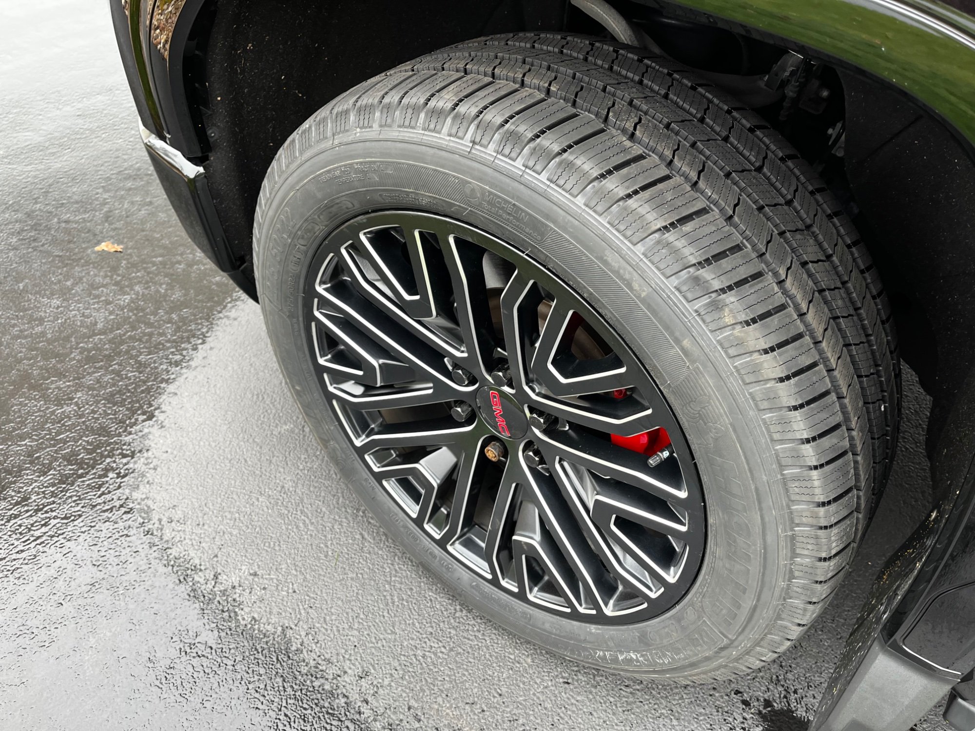

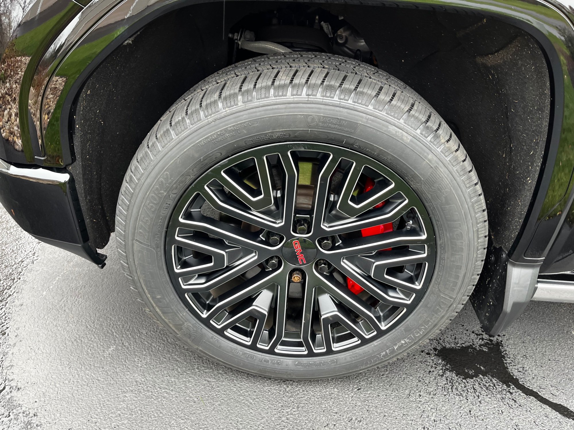

  11. EddDee, That’s exactly what I found when I looked at the braided ground strap on my truck. Haven’t changed it out yet hopefully in the next day or two. I’ll get back with the results. THANKS!!

  16. I have a 2020 Denali that came with the Bridgestone 22” tires, which were pretty shot by only 35k miles. Went with Michelin Defenders as the best AS option I could find. Have about 2,500 miles on them now and they are great. Much better wet traction and handling.
