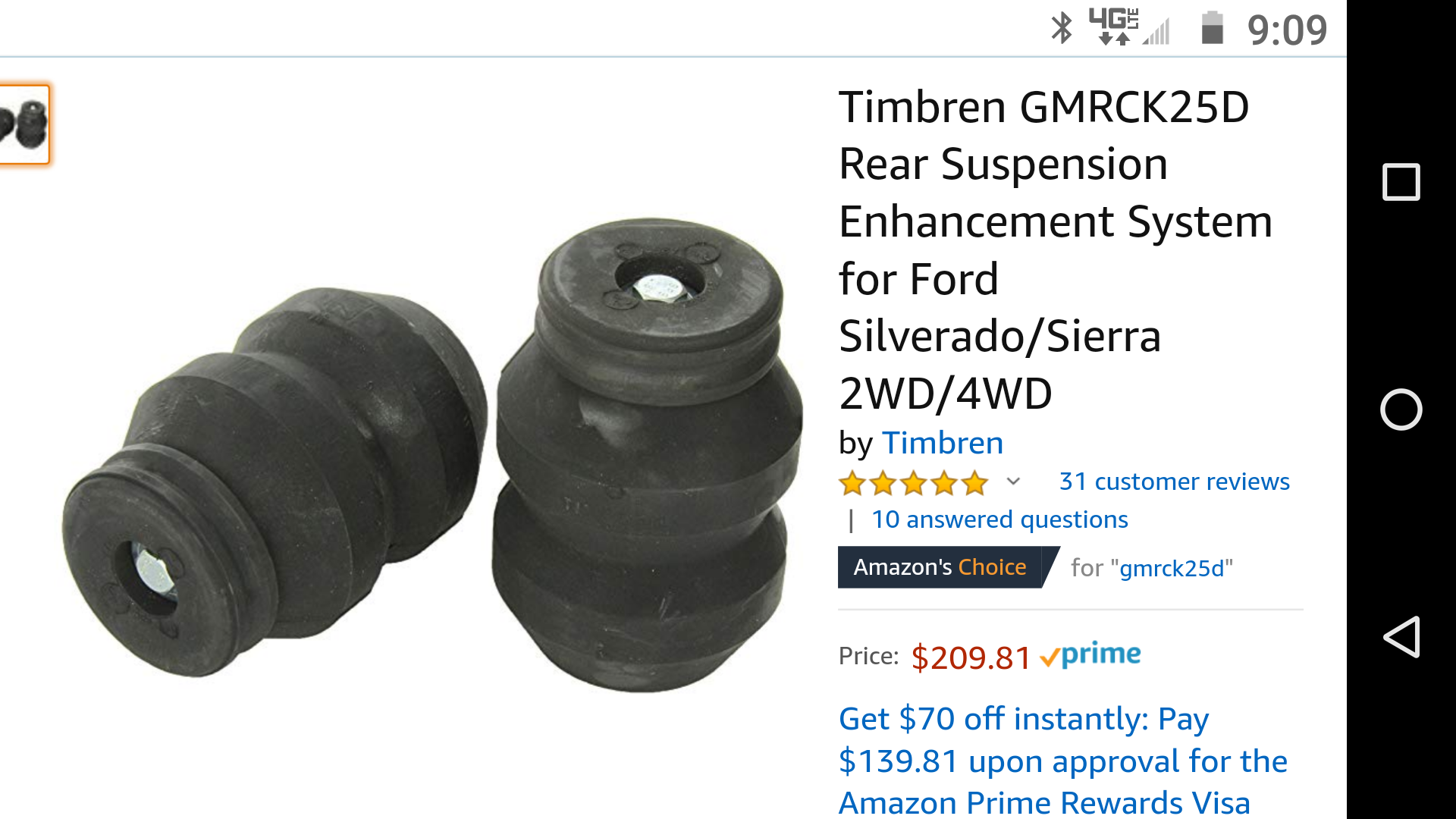

  2. They make a heavy duty bump stop. It's in here somewhere. I have them and right around 2500lb pin weight. They help for sure.

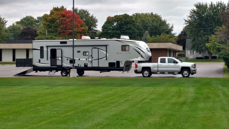

  4. I'm sorry. Been busy...... T Yes hauler, yes. Trailer pushes the boundaries of the truck. Trailer weight is 10,800 unloaded. Pin weight is appx. 2500lbs, yikes! So with Harley and goodies. I'm close to adding 1800lbs. I spent weeks trying to sort out trailers. They are a nightmare that you would never believe.

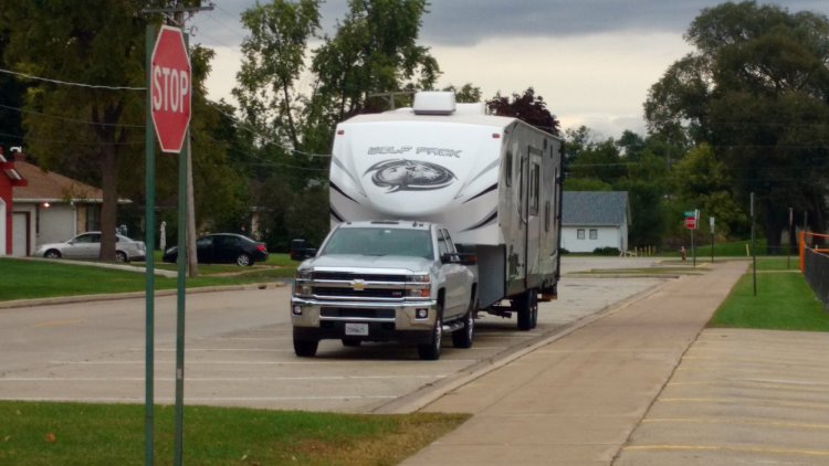

  5. 500+ miles today. Truck was flawless towing the flatlands of the Midwest. Only one issue....6.4mpg @ 65mph. No way possible to get any better. Going to take a detour thru Tennessee. I think I'd be really pushing things going from Nashville to Chattanooga. Where the elevation changes drastically.
  6. Brclark82, kinda just thoughts based on numbers. (Not exact) glad I threw those timbrens in there. I'll get a feel for it Saturday & Sunday. And report back. Brakes on both truck & trailer feel extremely good. 8.5 on gain. Seems to be working.
  7. Road trip.......poor little guy....he's a hurtin'.

  12. Timbrens installed. More clearance then expected. About 1 1/2" +/-

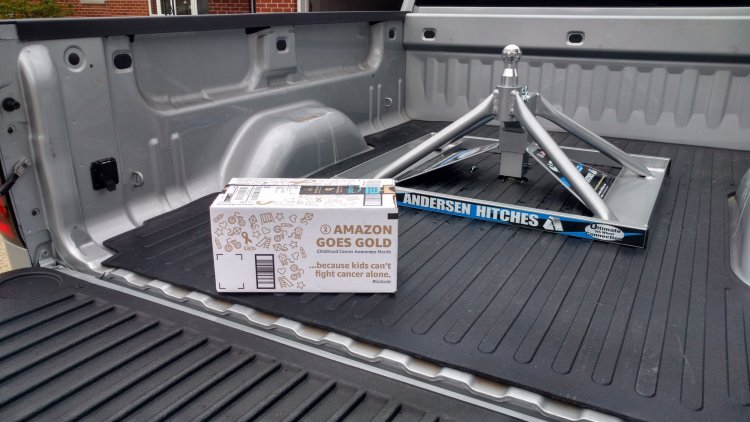

  14. Brclark82, everything is perfect. I had dealer install 7way in bed. All I have to do is pop the timbrens in. Note: I have a nice Kryptonite cable lock that I can use to secure hitch inside of truck. Just one more thing the theif would have to undo. I hate making things easy for them Thanks for all your insight. Anything else, let me know.....
  15. Sorry to hear! I just ordered the timberns.......after I found out I made a mistake. Load in bed will be 2500lbs. My bad. IDK.......

  17. I went with the B&W turnable ball w/Andersen aluminum hitch. Very light and easy to remove. That decision took time. As it's relatively new and unconventional, to me. I'll keep you posted.......
  18. Pot calling the kettle black?? Lol! Going to get hitch installed tomorrow. And loading trailer. Bringing a tape with me to measure the sag. What should I be looking for, as far as what's acceptable amount of drop? Will add your suggestion on helpers if needed. Joe
  19. Brclark82, Trailer is a toy hauler. To be honest, the trailer was an afterthought. And trailer shopping is very difficult. A very long bumper pull seems extremely sketchy to say the least. So, my options were a toy hauler where the bike sits in the kitchen and/or living space area, which I couldn't do. Or a very small 5th wheel with separate garage space. Obviously larger then the bumper pull. I was trying to figure things out on my own. Didn't want to rely on RV sales guy advise. You know how that goes. Lol! I knew I was cutting it close. Thank you for sharing your wisdom on this matter. I'm very great full........joe
