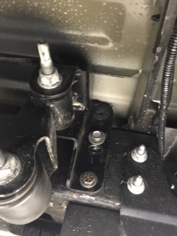

  4. Ok I got my truck back and this is how it is setting. The kit they used was McGaughy #34170 which shows 3/5 4/6 deluxe drop kit. When I went back to get it the first time they had the bracket mounted in the upper hole position on the bracket and it had a huge rake. I had them change it to the mounting position that it is in now and it has a little rake. What can I do to make it set a little more level?

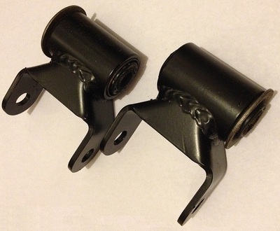

  5. So in darths picture that is set for a 5" drop and the other holes would make 6" or 7"?
  6. So if they turn the brackets the correct way and mount them in either set of holes one way I will have a 5" drop and the other a 7" drop is what I'm thinking. At 5" it would have a rake and 7" I would be in the same spot I'm in I believe.
  7. Is this the bracket I need to get to 6"?

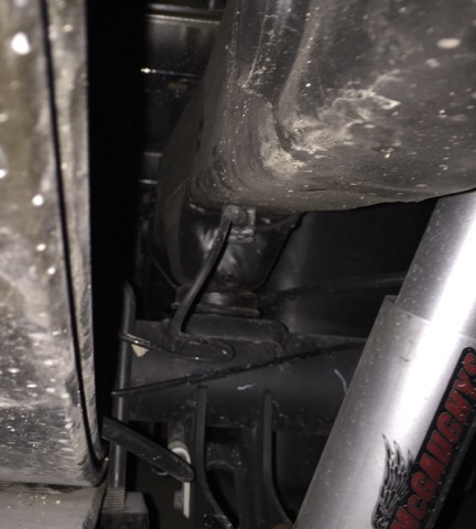

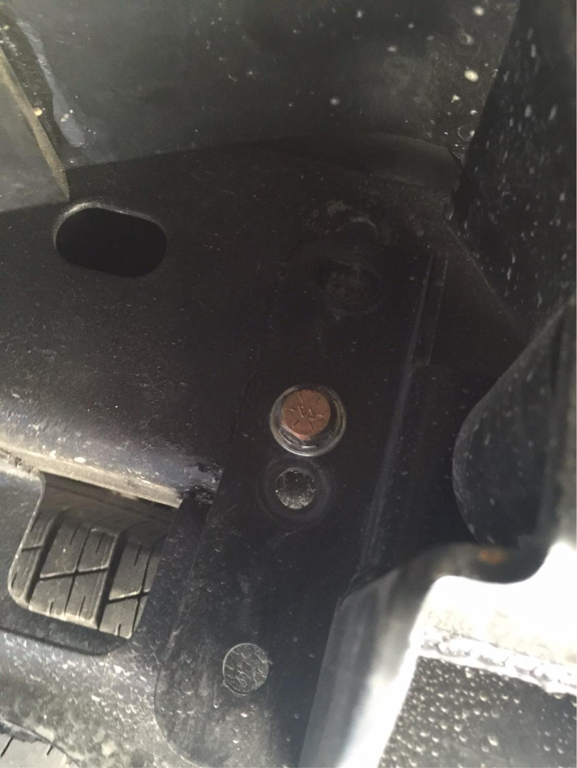

  9. Thanks for your help guys. Now I have cut off the bumpstop mount and put in small stops. I had to take it back to the dealership because it was sitting on the stops. Now it's off them like 1". When they cut them off the rear off the truck set a full inch lower than the front so I told them I wanted it level and they move the rear bracket down all the way and it brought it pretty close to lever. I'm a little confused on how to get the back up another inch or two.Here is how it's setting now...said they had to drill the bracket and frame. Also my shackle measures 4" between bolts so I'm assuming its stock

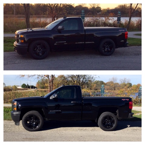

  10. Here it is bone stock then 3/6 drop. Love the look hate the ride...but I'm working on that part!
  11. Seems to me the rear shackle only has one option for the rear drop which they say is 6"? Does that seem right?
  12. Ok so I am going crazy with the ride in my truck and the shop can't get it in till Friday. So today I jacked it up and it was setting on the bump stops before I raised it. I cut the bump stops off as much as I could and reinstalled the tire. Now when I lowered it back down it still seems like it is setting on them but driving it gets a slam noise over every bump. So when I have them instal the new energy suspension ultra low bump stops do they cut out the part hanging from the frame. It looks to me if that stayed on I would be in the same basic position with maybe 1/4" more clearance.
