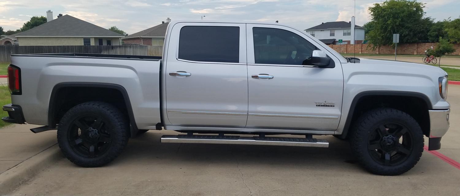

  2. I can tell you I have been dealing woth this for 2 months now. I went to a much more extreme on upgrade size with s 295/55/20 and had rub,So i don't like having this problem, I took to a chevy dealer who puts lots of after market wheels and tires. He could not explain it either. He has been having to make all kinds of mods to make lifts and tires work on trucks with Stamped arms.... Went to local 4wd off road parts and they advised need more off set to correct. So picked a wheel changed. This corrected the rub on a-frame, but just moved it to the sway bar. FInal solution was 285/55/20 with +18 offset wheels. Have spoken to multiple LIft mfg and they are still trying to get a grip on the whole stamped arm issue... Lots of things that worked before don't work not with different ball joint geometry. I added a ready lift 2.25 to front, but really want a 4". Waiting on more lift companies to come up with 2wd spindle lifts before making that jump.
  3. Ok so have finally got my rubbing issue fixed. After installing 295/55r20 Toyo open contry AT tires had rubbing on the a frame, So I installed 20 x9 XD Rockstar II with 18 offset. The tires now rubbing on Sway bar. So when back and replaced tires with 285/55r20 BFG AT K02's and all is well in the world. NO rubbing!... Satyed with just front lifted with ready lift 2.25" level kit, stock rear blocks.... Ground to fender edge in front 38 3/4" rears at 39 1/2 so only have a 3/4" rake... Here are some pics.....
  4. So here is the beast.... 2016 Stamped control arms 2wd 295/55r20 2.25 ready lift, tire hit and rub on sway bar..... going to 285/55r20

  6. 20x9 +18 offset LT295/55r20 Toyo Open Country AT 2
  7. 2016 GMC 1500 SLT 2wd 2.25 Readylift Level kit KMC XD Rockstar II 20x9 295/55r20 Toyo open Country AT II GM CAI ARE Z series Camper shell Ordered
