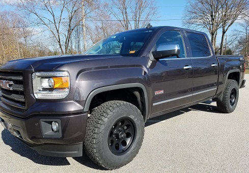

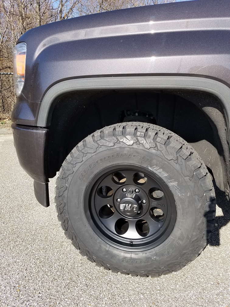

  7. 285 70 r17 BFG KO2s on Mickey Thompson 17x9 Classic Black (-12 offset). Rough Country 2" leveling kit. No rubbing anywhere. Ride is excellent and nearly as quiet as OEM tires/wheels. Very happy with this setup.
  8. I think that looks sharp! I'm going to try the Mickey Thompson Classic III in black (my truck is Iridium), 17x9 with probably 285 70 R17 and a 2" RC level. That's also a -12 offset wheel; your setup gives me confidence it will come out looking good and working fine! Did you try the Bilsteins?
  9. Nice looking truck! I'd like to use some 17" Mickey Thompson wheels and maybe the same tires you're using. What lift/level are you using? What's the offset of those wheels? Any rubbing? Thanks!
  10. Do you think the 2" leveling is necessary, or could one get by with less or no leveling?
