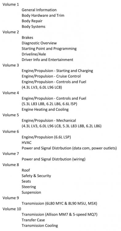

  5. More Information: The 9 of 10 volume set weights 50 plus lbs. Everything is still available. Pickup location would be East Bay, CA. My better half has requested, that get this project out of here, so I will entertain any offers. picture attached to show what is available
  6. I have extra 2017 service manuals volumes from my HELM purchase of GMT17CKPU ten volumes set. I have volumes 1,3,6,8 available along with almost complete 9 of 10 volumes set which is missing volume 5 available. All of them are as they arrived from HELM, which unfortunately mean the paper covers have light damage. It is long story about my purchase, and I how I ended up with them, but HELM is disaster in how they currently operate. I will add information to post depending on what the interest is in them.
