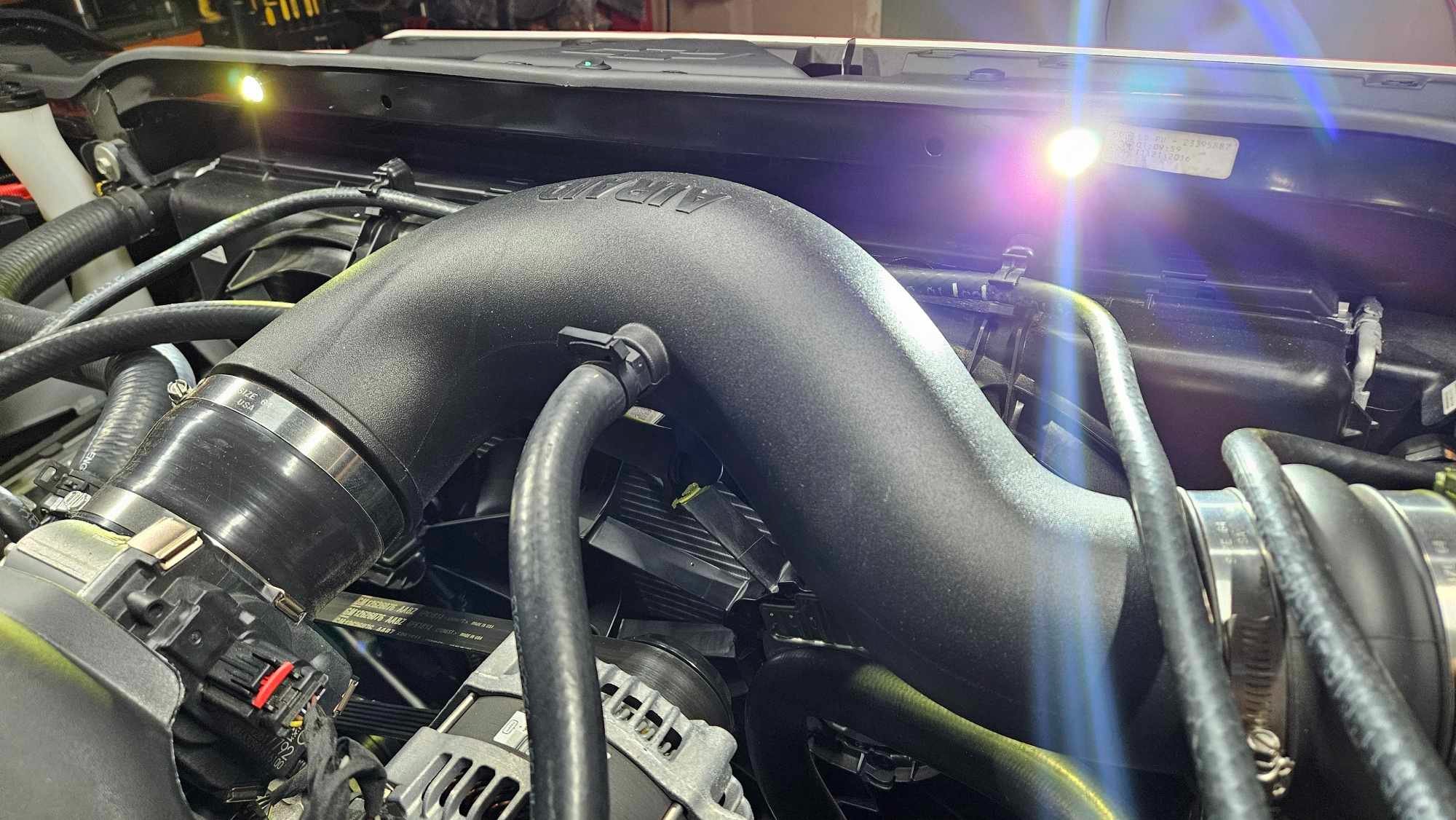

Finished up my aux battery install and LED strip engine bay add-on. Red wire-loom makes for contrast, but I might switch it back to black. My original LED engine bay lights were ok, used 2 Eagle eye LED in the front radiator frame, they fit perfectly(pain to put in). I just needed more light I use the Keyline 300amp Isolator for future upgrades down the road. H6 Interstate battery from Costco, MTA 0300839 positive bus bar, but will also be adding a 4-relay/12 fuse block, just need to make a mounting plate for it. Not finish with all the final routing, need to make it cleaner. Will probably also move the fuse that's hanging onto the back firewall. Just used the previous spot I had my fuse for my amp mounted. LED strips off And after turning them on... -

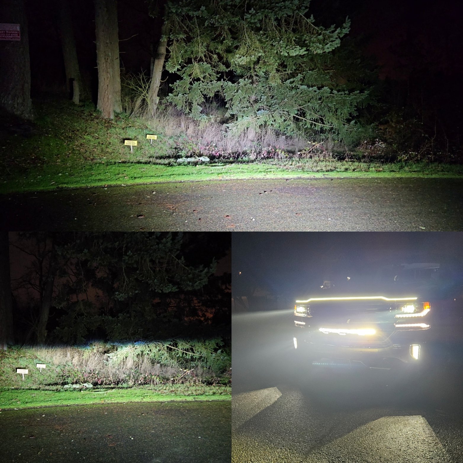

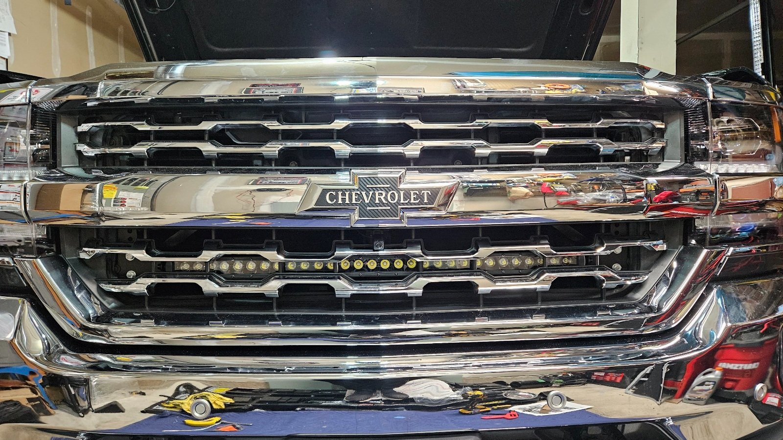

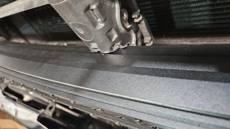

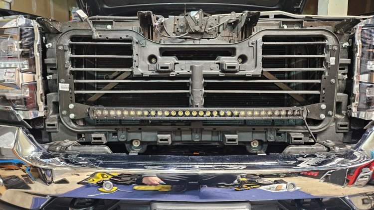

Installed the RC 30" Blackout single row curved LED light bar the other day. Still waiting on the OEM light switch with the fog light option to arrive so I can wire that in.Impressed with the light output. Had to do a little mod on the active shutters, backside of the grill and the bracket, but it worked out nicely. Going to swap the stainless steel bracket mounting bolts with some black stainless steel ones. They stick out against that black bracket. Should have packaged it with black bolts. -

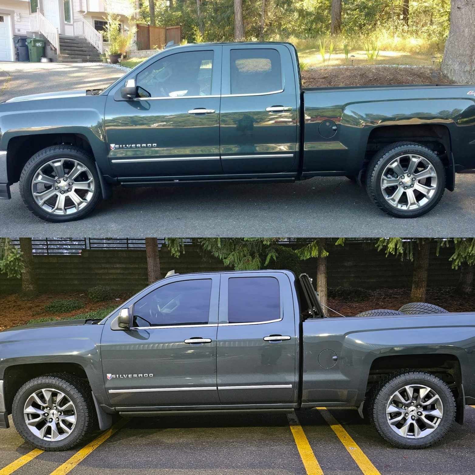

Picked up some RST 20" take-offs(eBay, claimed to only had 10/miles on it) and slapped on some new rubber. Went with 285/55R20, to keep as close to my OEM 285/45R22. Will use these for Fall/Winter and switch back to my 22s for Spring/Summer. Don't mine the bottom after picture, hasn't been washed all summer and it was taken at dusk right after install.. -
