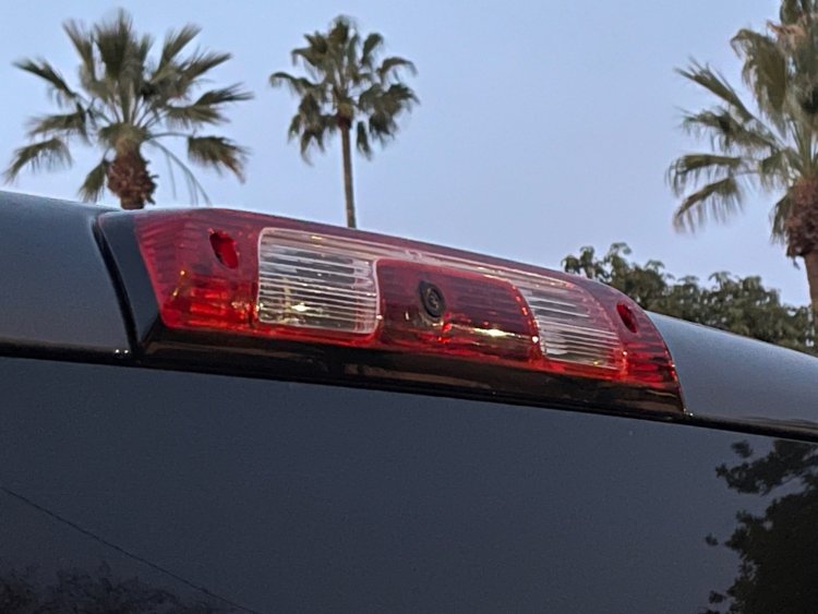

  1. Alright finally had time to work on this MOD to start off when installing the camera on the 3rd brake light I went oversized on the diameter my mistake. Next when bonding the camera to the light try to use a thick adhesive instead of using crazy glue this will help the camera sit more securely. I bought a 3rd brake light from offer up for 20 dollars OEM which I used as a mock up. Overall I like the MOD at the end I sealed the hole with black RTV to cover the oversized diameter I will attach photos let me know if y’all have any questions I’ll be more than gladly to help.

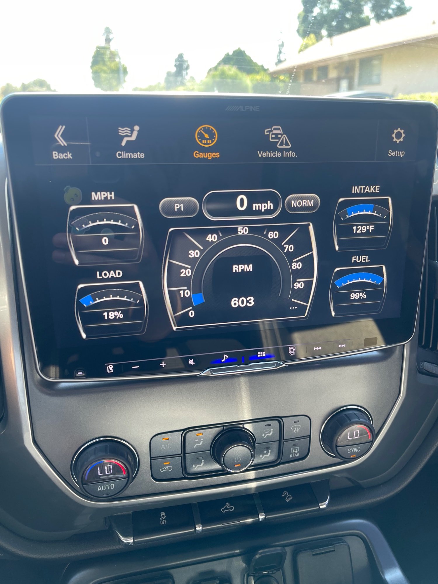

  2. Gents we are all entitled to what we like however I went on and got the alpine ilx-f511 and oh boy it’s beautiful y’all can take a look it it I’ll add some pics. Also you can retain all of your onstar features and steering wheel controls including your back up camera.

  4. Yes no onstar button I got rid of my onstar when I upgraded my stereo head unit.
