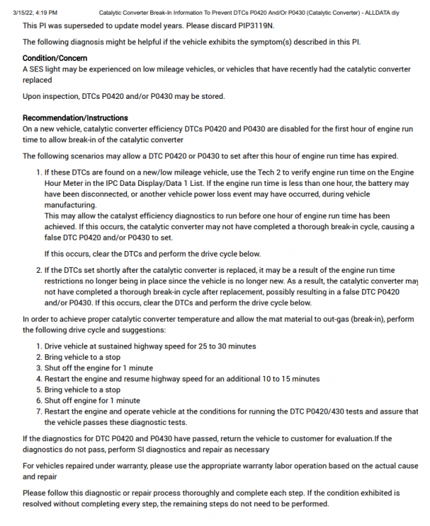

  4. I will add this, since I've installed the new OEM y-pipe assembly, I've driven approximately 300 miles. My miles per gallon have gone up about 1- 1.5 mpg since then. Even lifted on 35s with 4.56 gears, I'm now averaging about 15.5-16mpg around town (slightly lower on the highway.) Yes, the speedometer is corrected for the gears and tires. I dialed it in perfectly based on GPS speeds and GPS distance driven. I know the computer is a little exaggerated with the mpg claims, and based on previous calculations it reads approximately 0.5 mpg better than actual. So realistically I'm getting about 15-15.5mpg. Still better than 13.5-14 mpg (hand calculated) when I had the 420/ 430 codes logged in the computer. Need to take it into a shop and get this emissions test done finally

  8. Well, installed the new sensors last week and no dice (wasn't getting my hopes up on that one.) So, I ordered a new OEM catalytic converter y-pipe assembly (part #: 19420276) that I picked up from my local dealership. Just installed it this morning before a couple graduation parties I had to attend. No check engine light all day and stuck the code reader on it to see if the permanent codes that were stored had self cleared. Sure enough, all DTC codes are cleared and only one monitor hasn't run it's drive cycle and that's the EVAP system. It's looking like the OEM catalytic converter assembly did the trick for me. After wasting so much time and money on this issue, it seems like I have finally resolved the issue. A couple take aways I learned from this: 1) When having to replace catalytic converters, just go straight to the OEM part and don't waste your money on aftermarket cats (between install and the cost of the cats, I would have almost paid for the OEM converter assy with me installing it on my own) 2) Find a reputable shop that can properly diagnose the issue. Turns out the dealership was correct when they told me the aftermarket catalytic converters were not performing their duties properly, thus the codes remained set. But, the first shop I took it to said the aftermarket cats were performing their duties properly and thus they never revisited them as a potential issue. I'm a little upset I had to pay for not only the OEM cat assy but also the aftermarket cats as well, and labor to install them, but I learned a valuable lesson for future vehicles. I can finally quit riding around on dead tags and not be worried about possibly getting a ticket for them. Definitely a learning experience that I hope I never have to go back through again. I hope someone in the future finds this thread and it helps them out before they throw a bunch of money at their truck like I did. Thank you all for chiming in with your thoughts and opinions along the way as I struggled (along with an independent shop) to diagnose this issue!
