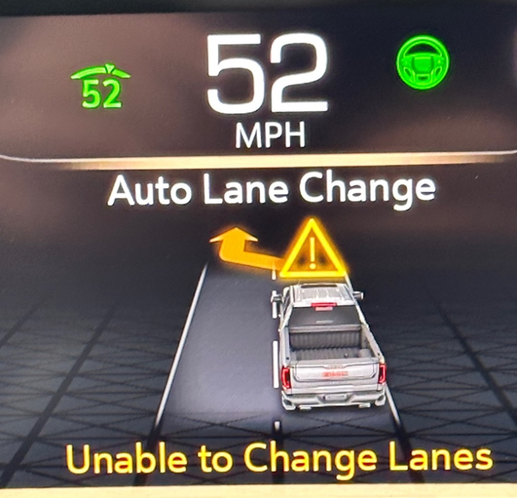

  6. Thanks. Do I do that through the local dealer? Or do I get a hold of GM? The service advisor was very frustrating with this. When I picked up the car I was able to speak the mechanic working on it when he brought the keys to the advisor. He was more reasonable to speak to but only said all he can do is what GM is telling him to do and next step would be to take the console off to find the part number for the image processing module which they have to order and wont know if it is back ordered until they get the part number from the existing module. I called Onstar just now and they are sending a refresh to the truck. I doubt that will work. They said call back tomorrow during regular business hours and they will connect me to GM. I will ask them about the Factory Service Rep.
  7. I have a 2023 Sierra Denali Ultimate produced 1/10/23 and finally took delivery on 4/28/23. Yesterday I got the update GM N22-2379480. I have Super Cruise and Lane Change does not work at all (I have another thread on this). Either manual or automatic. Both before and after this update. Perhaps now that I have GM N22-2379480, I will get the next update and maybe that will fix Super Cruise and it is not a hardware issue! Dealer and GM apparently have no clue what the issue is and just guessing.

  10. Picked up the truck from the dealer after two days. Lane Change issue Not fixed. For the Service driver assist system message the service advisor said they program several modules. The RO printout noted they programmed the driver presence module. They said it fixed the issue. However, since this was sporadic and happened three or four times in the 700 miles I drove it, I will keep an eye on it to see if it comes back. For the Unable to change lanes with Super Cruise, they said they tried to program the image processing module but it did not program. GM requested they get the part number of the existing module and then order a new one. Issue is to get the part number, they need to take the console apart. Advisor made it sound like a big deal. My concern is what do they damage doing this! Further issue is when they finally get the part number, the part may be back ordered. I am a bit baffled that they have to get the part number off the part and not just order it. This may not even be the issue. Considering they had the car for two days and I need it, I decided to take the car tonight. I am reaching out to @GMCustomerService and see if they can assist.

  18. I called onstar and they put me in touch with a GMC rep. Rep just stated the standard that sometimes it will not work depending on what it sees. Then stated it could be a road where the super cruise works but not the lane Chane. I tried on three roads. Same thing. I need to schedule. everything else seems to work. my concern is the dealer will just not know. I wonder if it is a software update that is needed. Right now system does not show any update is available.

  21. I have a 2023 GMC Sierra Denali Ultimate with Supercruise. The Supercruise works but not the lane change. I am not in Haul Mode. When trying to change lanes I get the message that shows an Exclamation mark and says "Unable to change Lanes" I tried with Lane Change setting on Automatic and also when I manually hit the blinker. When I tried yesterday it was raining out and I tried this morning not raining but dark. I have not had a chance to try during the day with better weather. thanks, Mike
