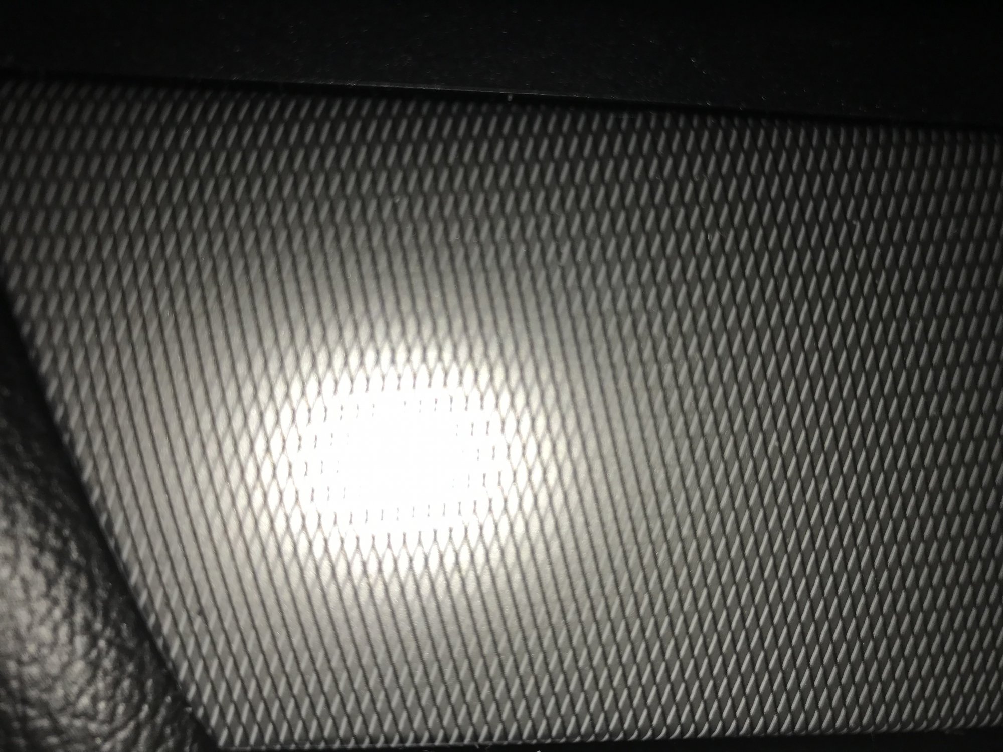

The first picture is my door trim and the second is the floor console trim. It is silver. Smooth finish. The console is black. I would say it is the same as what you have.trim wish

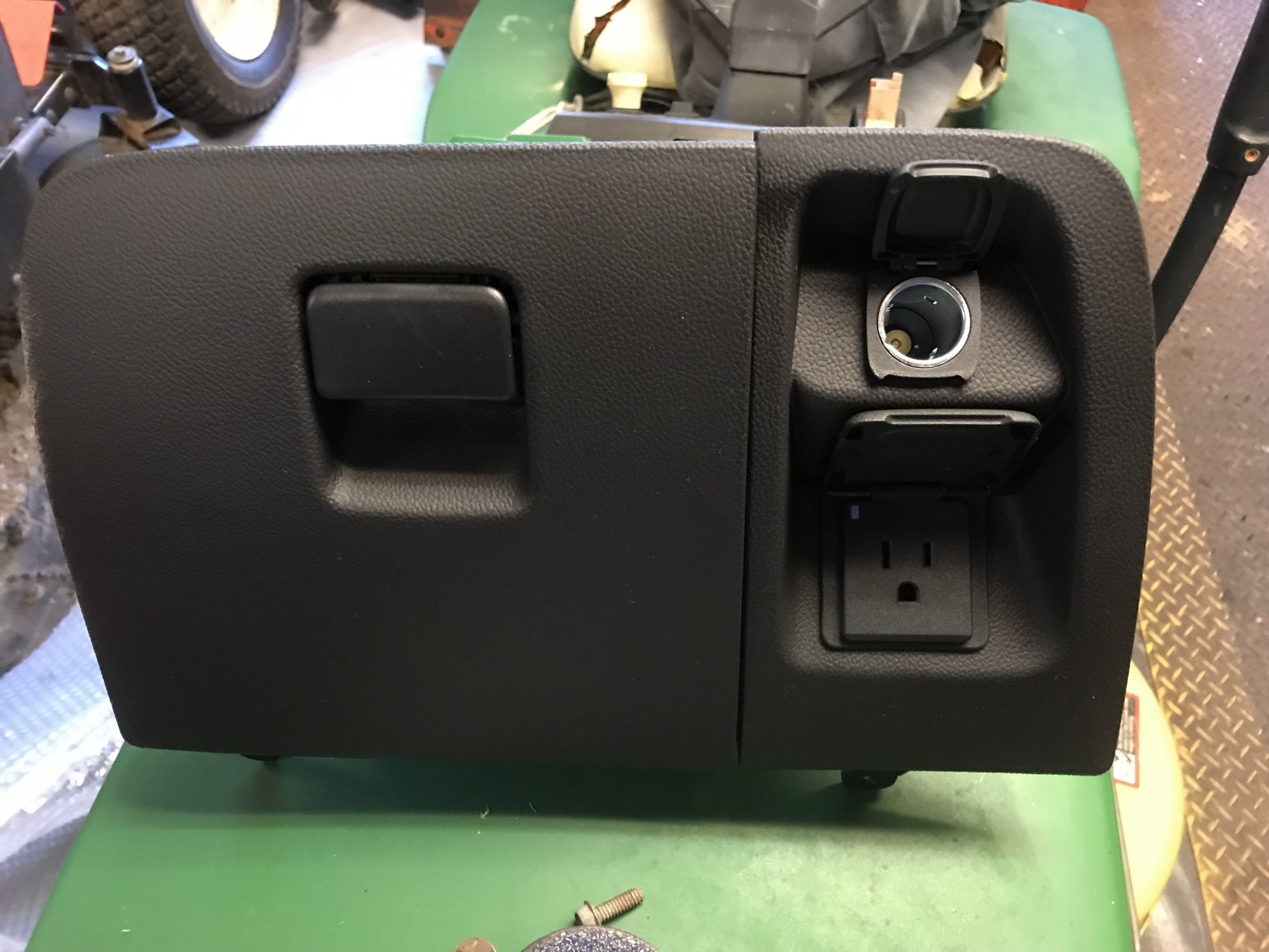

Is this what you have on your dash? cig /port and a 110 outlet? If it is then you need to order 2 USB cables as follows # 19303285 and # 19119050 IMG_0176.MOV

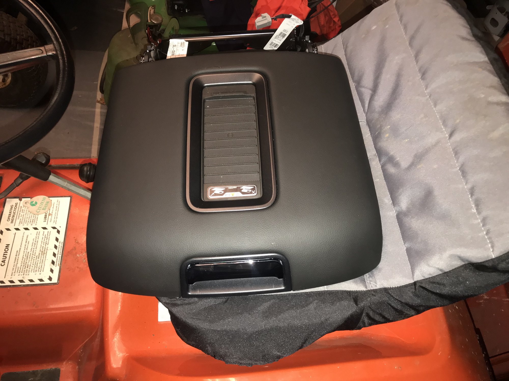

They are selling you to much stuff. Bolts you can reuse from your console now. The only bolts you will need is the 2 bolts that bolt to the front bracket. Yes my console is black with silver trim. Yes it came with the back panel and yes it did come with the wireless charger. If you want what I have then use these part numbers. Console with back and arm rest with wireless charger # 84199886 upper front trim panel # 84042079 front mounting bracket # 22776807 side trim right and left # 23467516 and # 22817347 That's it. Now for your USB cables Need to know if you have a cig/ lighter port on dash and 110 out let. This will depend on what USB cables you need. and Phil PnP cable. I used gmpartsonline.net they gave me the best price after checking over 6 sites. They will have to order the console and it will take them 3 to 4 days to get. 1-866-423-9926

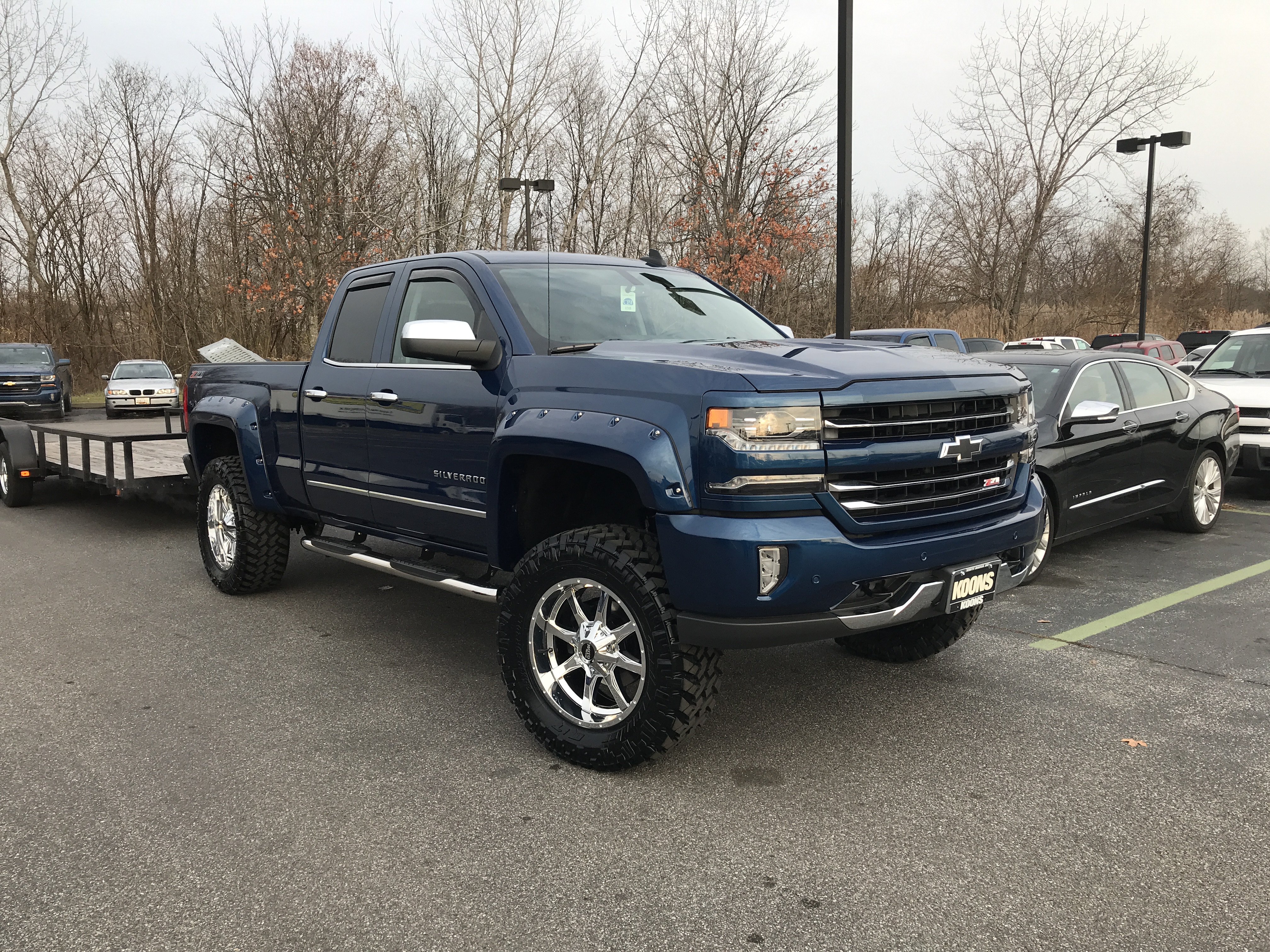

Just finished installing. A big thanks to Phil video . Here is the picture you asked for devonb. I even added some blue led lights that come on when you open the door.
