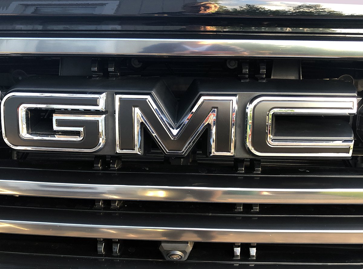

  2. You can do the emblem blackout. Just take the vinyl, cut squares of it that cover the entire letter including the chrome. Lay it on evenly with no bubbles (simple on such a small thing). Take an xacto knife or similar and carefully slide it along the inside edge of the chrome outline. That will leave just enough vinyl after you've got the letter cut out to tuck into the gap between the letter & chrome outline. If it doesn't want to tuck cleanly, use a bit of heat from a heat gun or hairdryer. You could probably even just do it in the sun to make it conform. If it doesn't turn out, just do it again until you get it right. Vinyl is cheap.

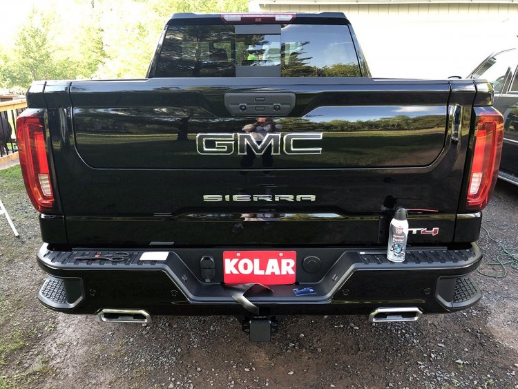

  10. So, today I blacked out the GMC emblems on the grille & tailgate on my '19 AT4. My truck is black and I like the sleek black look. This was a simple, subtle mod in that direction. I used 3M 1080 wrap vinyl & a little heat. They came out nice and if I decide I want them red again, for some reason, I can just remove the vinyl.
