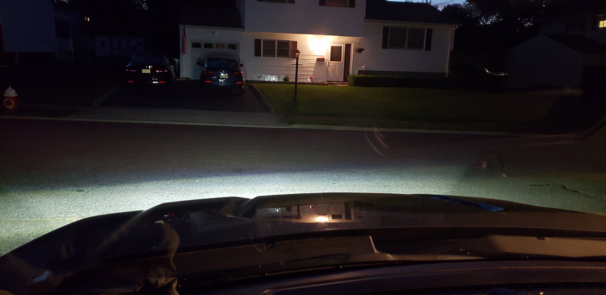

  4. This is what I took tonight. Just bear in mind I'm on a slight downward angle and the might need to be aimed. Also, headlights are turned off.

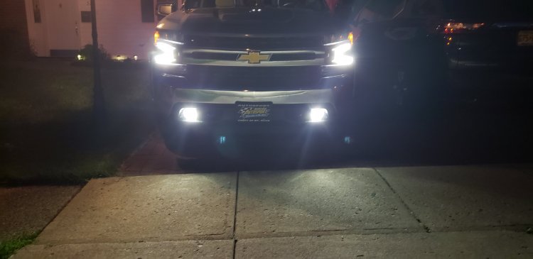

  5. I got mine programmed today, so tonight I'll get some night pics up.
