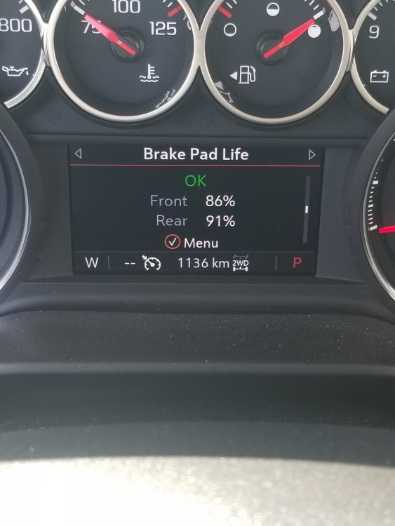

  17. Sorry to revive this thread, but I am in the same boat. 2019 RST 1500, 1100km's (680miles) purchased April 2 2019. My front reads 86% and my rear reads 91%. Co-worker of mine, same vehicle 2019 1500 RST purchased 1 week prior to me, has 6000kms (3700miles) and fronts read 91% and 95% rear... I think there is definitely a software issue or a sensor issue (shocker it's a chevy). I drive very conservative, and will often coast before braking. Thinkin' I'll take it in at some point and see whatsup. Anyone else have any answers since the last comment on this thread dated may 9?
