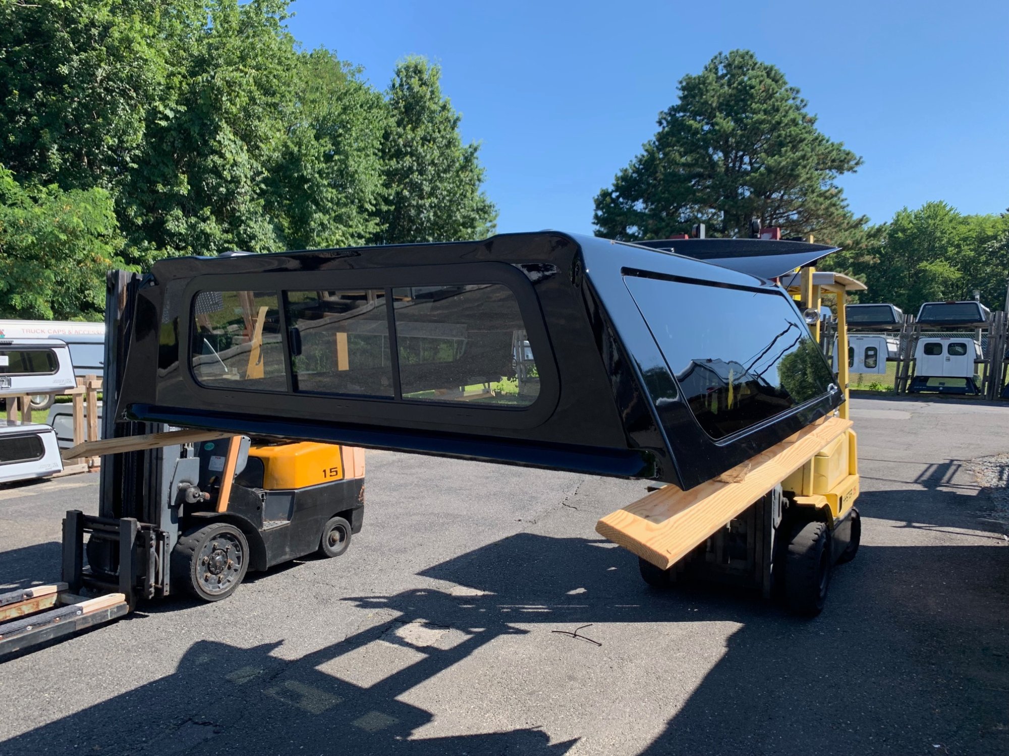

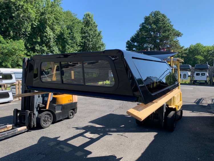

  1. Available for pick-up immediately. Excellent condition. Installed two years ago, right after truck purchase (6/2019). Installed by Suburban Caps in New Jersey. Price: $1500 Specific for: 2019 Sierra 1500 (New Body) Truck Bed Length: Standard Bed (79.2") Color: Black (matches GMC factory black) Options include: Yakima Roof Rails, lined interior sliding front window, ability to drop down entire front glass (on latches, allows you to clean/ access the truck cab rear window). Includes two keys. Outward facing windows have been tinted 20% over the ARE factory tint for additional privacy. PM me if you have any questions or if you'd like to make an offer. Buyer will need to come to West Chester, PA for pickup & bring someone to help with the lift.

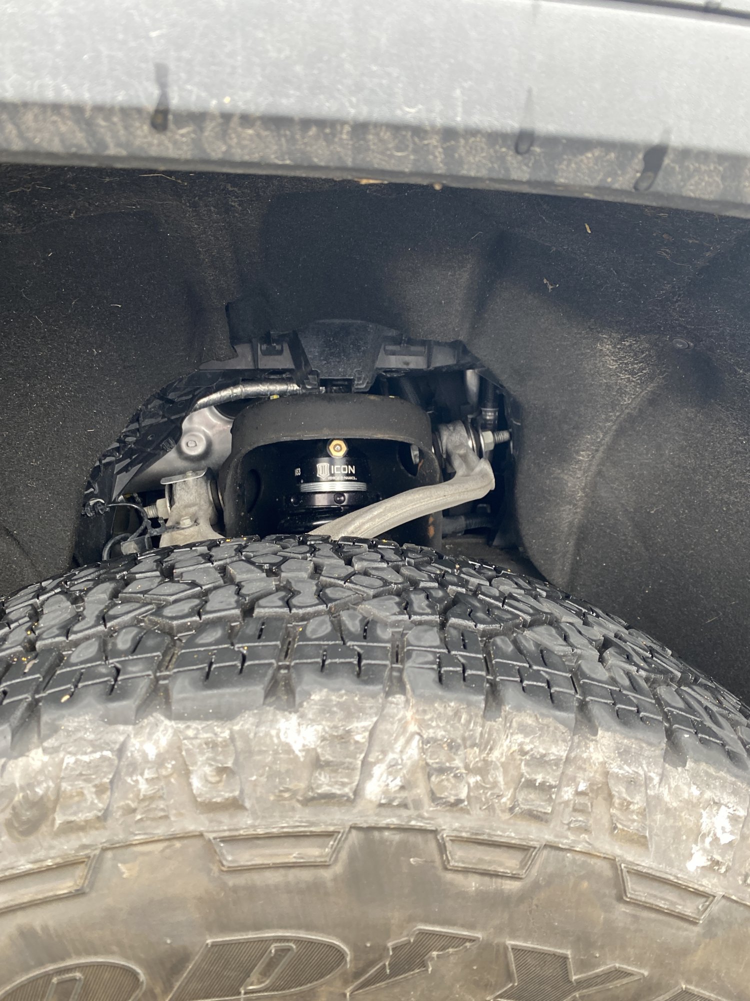

  2. The stage 1 icons are longer than the factory struts. I had to remove all of the preload on my icons to get it to sit right (I have an ARE cap). For towing, I ended up installing bags, to keep it level.
  3. I still have my stock struts. I'm trying to minimize my down time, so I asked ICON to ship me the parts for the rebuild & found a shop in the Philly area to do the re-build. Also found a race suspension shop out on Long Island, NY & this sort of work looks like their bread and butter. Unfortunately, I don't have the tools or space (or experience) to perform this work, otherwise I would totally take the time to tackle it. I had also asked ICON if they would sell just the shock (without the spring) & they weren't up for it. I was thinking of keeping a spare shock & swap out the spring for these sort of situations. They double checked and with a modification the passenger side can be used on the driver side. However, they will only sell the complete coilover for $800. Thank you for the offer!
  4. 5k miles! Sounds like I'm lucky mine lasted this long (6 months, 14k miles). My issue is that it's my daily driver & I can't just leave it sitting on stands. So I'm thinking of having it rebuilt locally. Planning to have that conversation with ICON today to see if they'll honor it. I'm between NYC and Philly, so I figured there's got to be somebody who'd be willing to do the rebuild. Do you know anybody?
  5. @Flatblack83 Wondering how many miles you have on your stage 1 ICON coilovers thus far? After about 14,000 miles my passenger side coilover has started to leak fluid. I've started the warranty process with ICON...

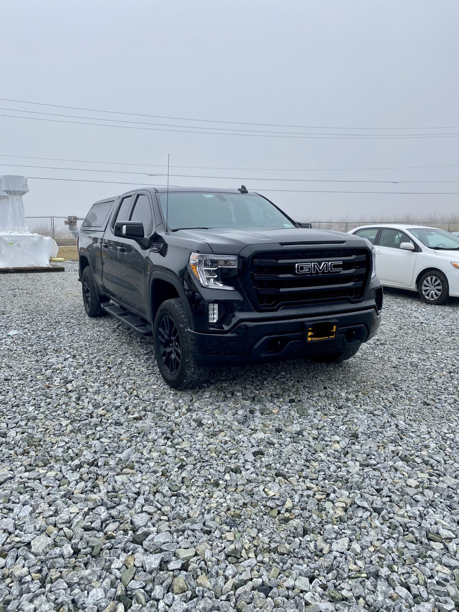

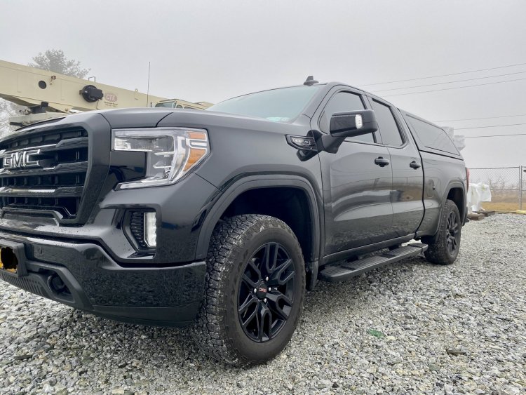

  12. My truck was leveled out at about 1.5”. It actually sits 1/4” higher in the front right now, so I’m due back at the shop on Monday for a re-torque, final measurements, and any other needed adjustments. I actually stopped by the dealership yesterday & got a copy of the recommended alignment specs for my specific vehicle. I was curious to see how it differed from alignment after the kit was installed. So there are some slight discrepancies in caster and toe. The steering kind of settled in over the last day, but I feel like the steering is stiffer than what it used to be, prior to the install. Anyway here are some pics of how it came out. It’s sitting on a decline and looks good. It’s only when I park it on a bit of an incline Does it begin to look nose high & so I begin to wonder if I should have them bring it down to 1” of lift in the front. It’s weird with the GMCs because of the way the wheel well is designed and the aggressive grill, with the slightest lift It looks nose high.
  13. My experience is about the same with the improved handling (also on PA roads - had the kit installed in Dover, PA). Its about 4-5 threads above the spring collar (haven't taken a measurement - but just eyeballed it). I'm assuming it came set that way from the factory. Does that sound right to you? I'm still learning....Will take some pictures tomorrow
  14. @Flatblack83 I just had the ICON stage 1 kit installed on my 2019 Elevation Double Cab - with the front set at about 1.5" level. Loving the kit & how it rides. But I'm finding that the the it wanders a bit at highway speeds & the steering is a bit dull. What has been your experience with steering? Do you still have a copy of the alignment report? Thanks!
