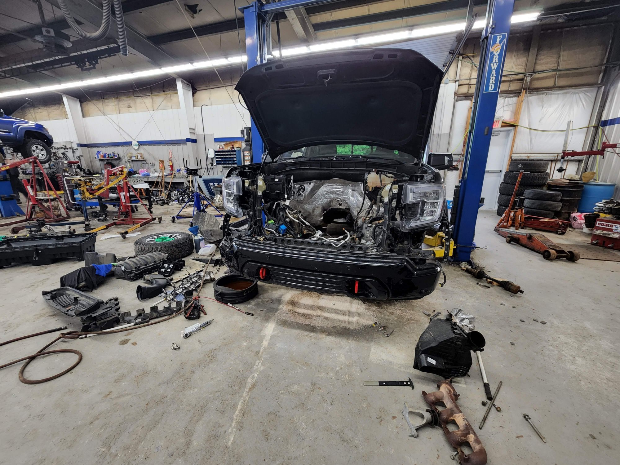

  9. So just yesterday they let me know that it threw a rod. I said how did it take that long to figure it out. They said that for warranty work they are forced to follow GMC's troubleshooting steps, and have to get approval before everything new they attempt it. They said parts are on order. I said if the motor imploded, I don't want it fixed it should atleast be a new motor. They said again they have to do what GMC tells them. I have phoned GMC Canada and a supervisor is supposed to be phoning me back today. I'll fight for a new truck (which seems unlikely), then a new motor plus extended warranty. How is a vehicle disassembled and re-assembled in a dealership supposed to be the same as one put together in a factory is my argument. For an $80k I need to be able to trust the vehicle. The is what I saw when I walked into the dealership today...
