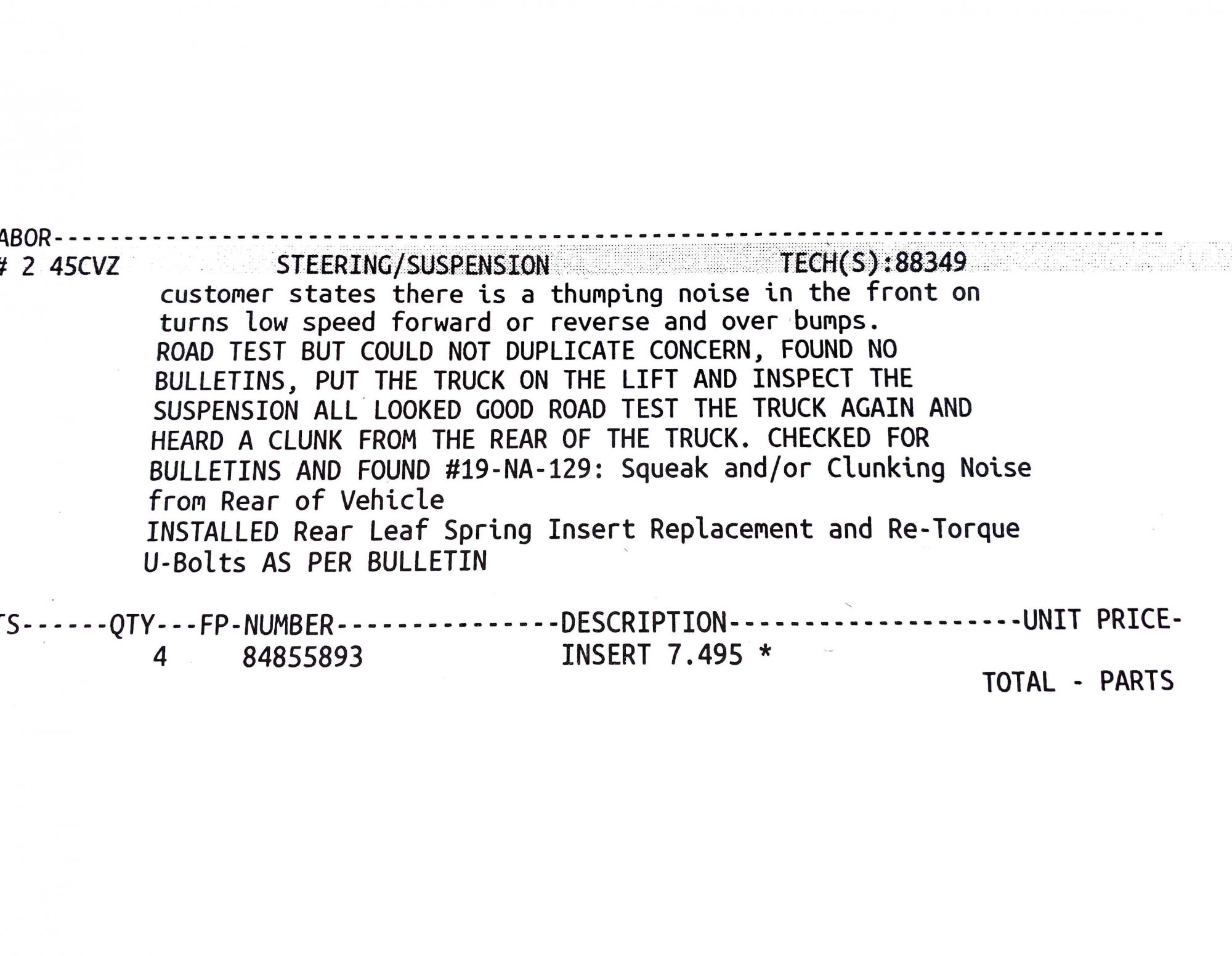

  3. Initially I thought it was from the front. So did the tech. Closer inspection and he was able to find it in the back.

  5. Not entirely true. My 2020 has 2260 miles on it. Built in 8/19. Picked it up in the beginning of December. I don't drive it that much, which is to say a few miles a day maybe to the gym and back, no really long trips. Last week, I was driving around all morning and started hearing a thunking sound. So while I had the radio off listening to that, I heard the dreaded jingle. Jumped on here and they symptoms are exactly the same. Starts around 15-20 miles, only in 2wd, goes away in 4x4. It does have the SU4 axle. Anyway, took it in and first they didn't hear it. Went back the next day while it was warm and took the tech for a ride. He heard it. It goes back in Tuesday. As far as the thunking noise, it sounded like the front but closer inspection showed it was coming from the rear leaf springs. They said installed "Rear Leaf Spring Insert Replacement and Re-torque u-blots as per bulletin"
