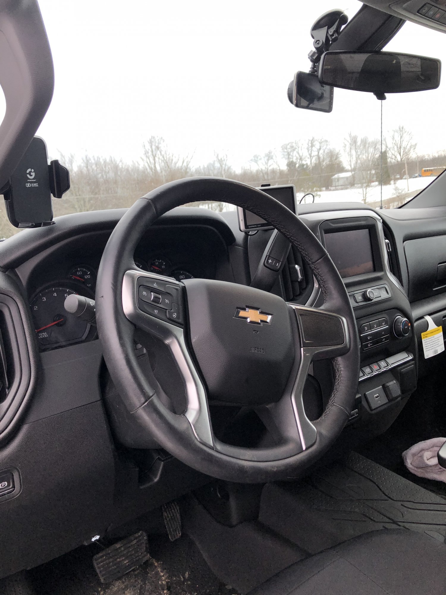

  5. I have swapped the steering wheel on my 2020 custom for a wheel from a 2020 LTZ. The wiring does not exist in the custom or WT trim trucks. to make the radio/phone controls work here are the things that are needed: 1. A replacement steering wheel with controls, 2. Replaced wire harness in the column, and to the DIC and Headunit. (Possibly the clockspring, but I cannot conform that), 3. A replacement gauge cluster with the upgraded DIC, 4. A replacement head unit that allows for the steering wheel control input. on top of that.... most likely going to need some programming for the ECU/DIC ..... at this time (2/19/2020) I don't believe anyone has actually completed a full swap of all these components to make it all work. I really just wanted the leather wrapped wheel and used all the "guts/wiring" from my existing wheel to put into the leather wrapped shell.

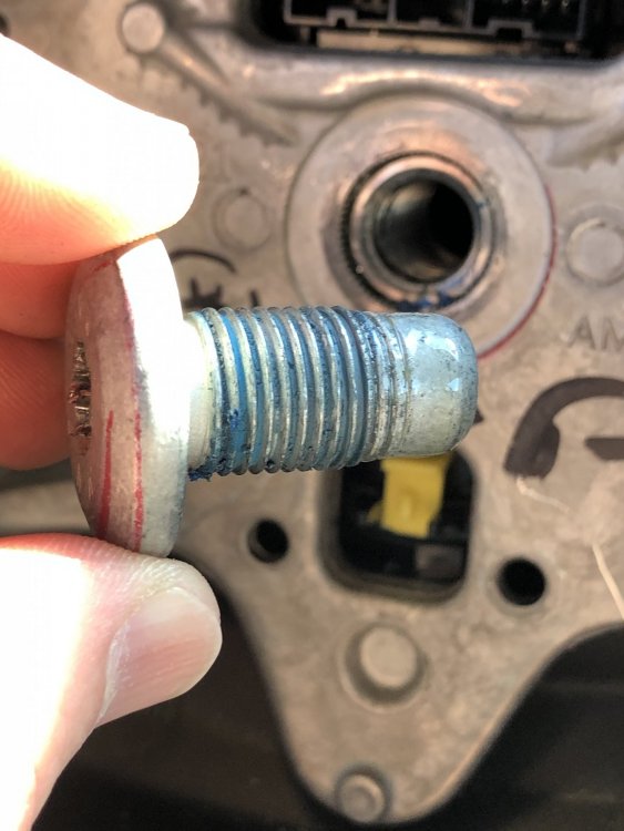

  7. Replaced my plastic/rubber steering wheel today with a leather one off of an LT trim level truck. As noted in a few other posts, the controls from the replacement wheel will not work to control radio and DIC.... but I was really just wanting the leather. Since the replacement wheel came from a wrecked truck (blown airbag) I decided to move all the wiring from inside my steering wheel to the replacement one. Removing the airbag requires removing a 10mm bolt from each side of the steering wheel (behind plastic covers)..... but much easier than older models. The bolt holding the steering wheel on is a T50 torx.... and to remove it, you need to apply some heat (hair dryer worked good) because it has locktite on the bolt.
