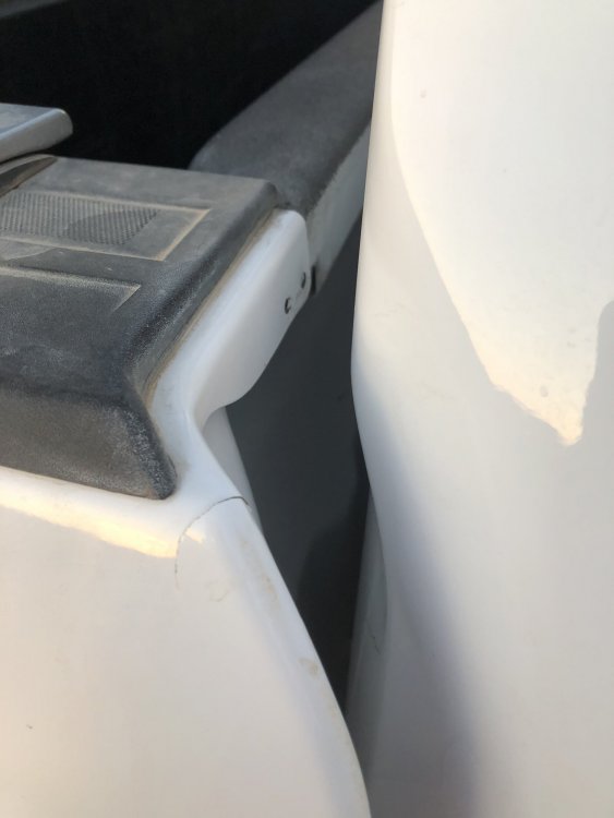

Update: After a long wait and the dealership going back and forth with GM, they have decided to completely replace the bed. It should arrive in 3 weeks. I suggest anyone considering a ladder rack or other accessory that attaches to the bed rails to be very careful and try not to drive the truck on rough or bumpy roads. I looked at one of our subcontractor's 90s Toyota and the bed metal is significantly thicker - makes me jealous. -

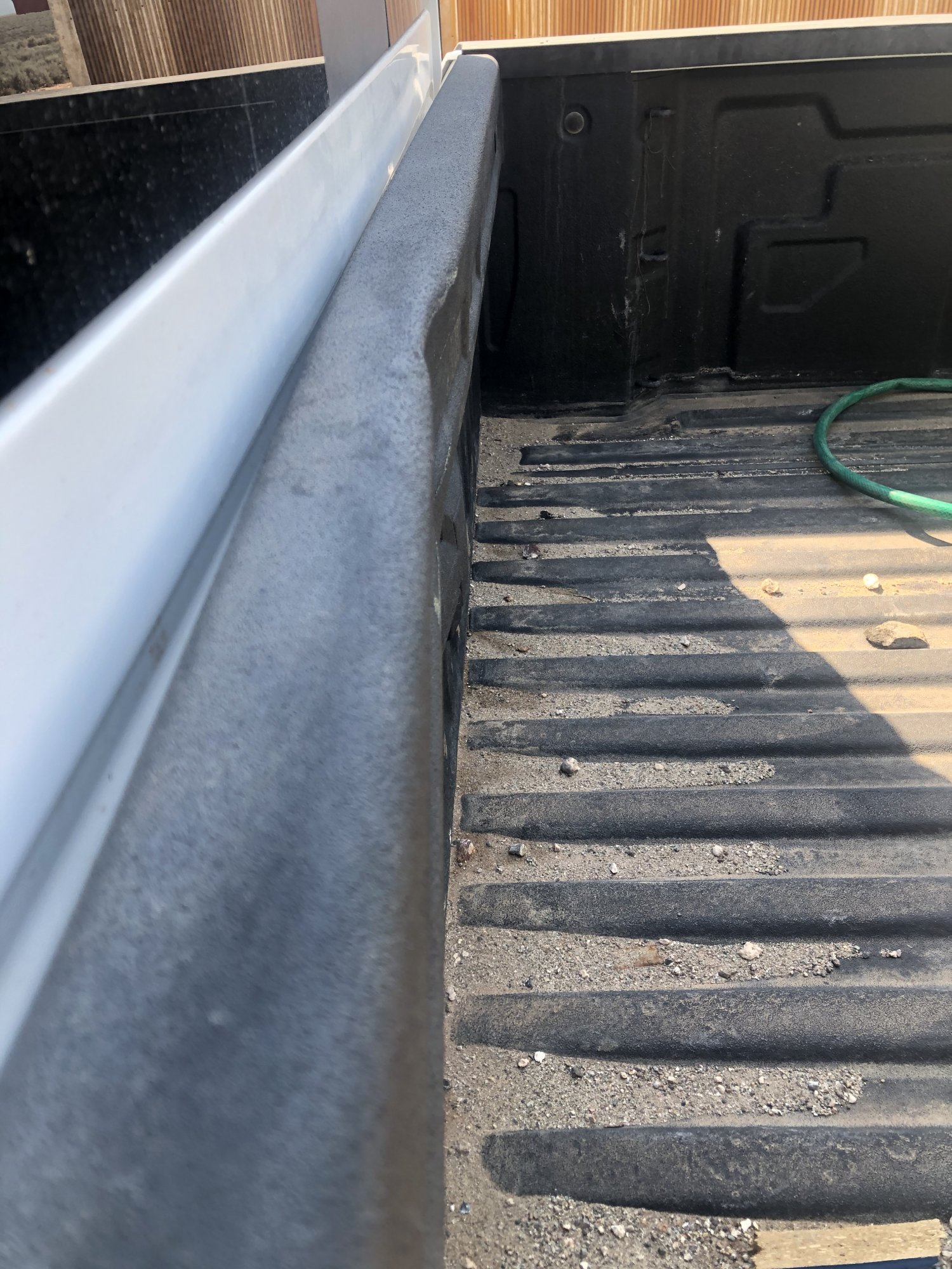

i think this is what you are asking for. dealer said they can pull it out when they do the other work. -

I haven't spoken with Thule. I am still waiting, according to the dealer, for GM to decide how to proceed with the repair. Apparently, another truck in the area has had it happen too, according to the dealer. I've never had the rack with more than 100 lbs on a dirt road and maybe a max of 150 lbs on pavement, all short distances. Body shop and I believe it is the cantilevered portion flexing the rack down to the bed rails. I don't think I would have had this problem if I was always on pavement. Thule only recommends lowering the carrying weight if you go off road and supposedly it holds 500 to 1000 lbs depending on what you read. however, i just keep having bad luck with this truck as a load i was carrying damaged the front of the bed. how it happened is almost unbelievable. essentially as i was braking normal and coming down a hill when the truck violently downshifted causing light lock up of the rear and sending stuff flying / breaking my tie down straps. after that it was back to normal. i take ultimate responsibility for not securing the load properly but strange. no CEL, no abnormal stuff afterwards, just carrying about 3000lbs in the bed. -

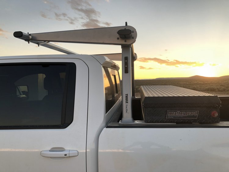

they are attached to the bed rails with clamps. they are hard to see in the pic but they go over the base (which has a groove/slot in it) and attach underneath with a foot that rests on the top of the clamp screw. i drove 150 miles to drop it off a dealer with iCar certification. they are telling me they have to call GM. -

it was always over the cab as shown. at the body shop, just grabbing the end of the cantilevered part resulted in flexing the bedrails and slightly moving the metal by the welds. we only put about 20lbs of force on it. i have never actually loaded the cantilever portion as i haven't had anything long enough yet. body shop believed damage could be done just by the jostling of the upper cantilever on the bumpy roads. -

no. there's another tower and cross bar and the back. -

almost never. did once or twice to carry some long boards and was on pavement 95% of the time. -

body shop mentioned used beds also but it is cheaper to fix existing bed and we discussed them reinforcing it better. i am weighing two options and probably will be based on what GM does or if I file an insurance claim. Get bed fixed or replaced and buy a roof rack that I will use with the rear 1/2 of the existing rack as a ladder rack. I believe if I mount any rack that flexes and puts excessive pressure at the front of the bed I will have the same problem again. Get a utility bed and consider selling existing bed even with damage (body shop said it's a few hours to fix and there will still be demand for it). I would like to mount the backup sensors and camera on it. Not enthralled with the look of it but this maybe a better solution for my needs. (construction). -

Curious if anyone is experiencing this. The sheet metal on the upper forward outer corners is tearing and my spot welds (4 of them) nearby have popped apart. The truck has a ladder rack installed, that was purchased through the GM accessory catalog and included with the total purchase price of the truck when bought new. I do live on a mild-moderate bumpy dirt road and maybe the rack isn't allowing the bed to flex. Not sure. Also, I have never come close to the max capacity of the rack. I am taking it to the dealer for them to look at, but may have to call my insurance company. My belief is that since it is a GM accessory that was sold with the vehicle, then it's on GM. Photos show small tears starting on both sides. You can see two holes in each corner pic, the metal is loose and the weld is no loner intact, other pic shows roof rack, corner where tears are starting is a few inches in front of base. Any advice is appreciated.
