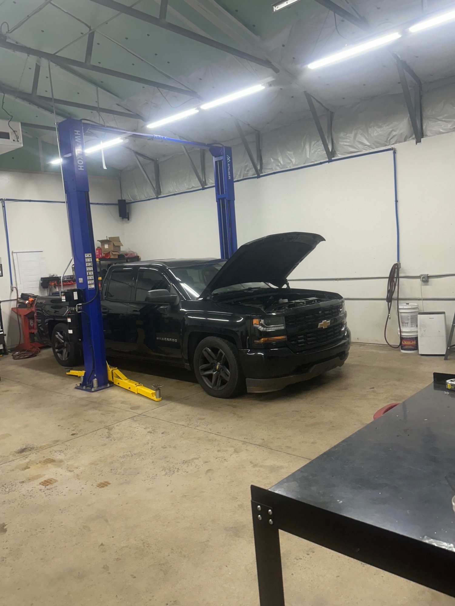

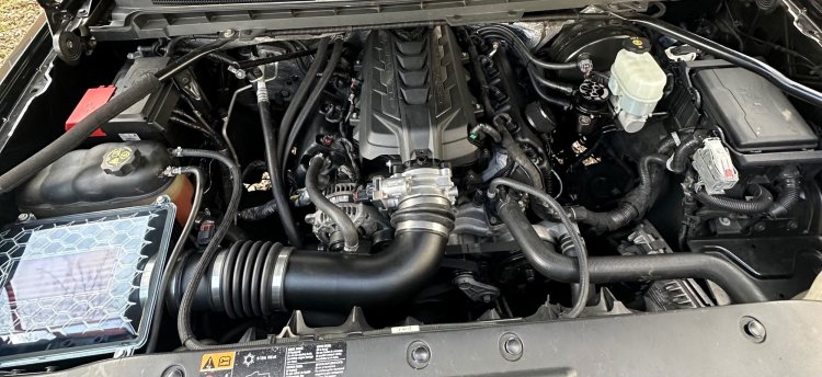

  1. Got it dynoed last month made 534/508 on e50 and on 93 it made 518/490. We never got it higher than e50 on the dyno because i came with too much 93 in the tank but i suspect theres not much power left between e50&e85. I put the gm performance truck intake on before going it needed to be modified some to work with the lt2 intake and lt5 tb. Overall im very happy with the numbers but coming from a turbo setup to this was somewhat underwhelming because of the stock converter the truck gets out of the hole hard but nothing like the old turbo setup.. nothing a 3600 stall shouldnt help ive got it sitting in my garage waiting to be installed. with the tight converter this setup ran 12.3 at 113 with a 1.87 60’.. the old turbo setup ran a 11.49 at 120 mph with a 1.71 60’. The turbo setup was able to stall the zl1 converter much higher being that the torque was instant when building boost on the brake. I look for this setup to run about an 11.9 at 116 and a 1.7 60’ once the converter is in.. we shall see.. still great times for a stock motor with just a cam and boltons im very satisfied with it. Ps the burnouts are much more vicious in the na setup for some reason

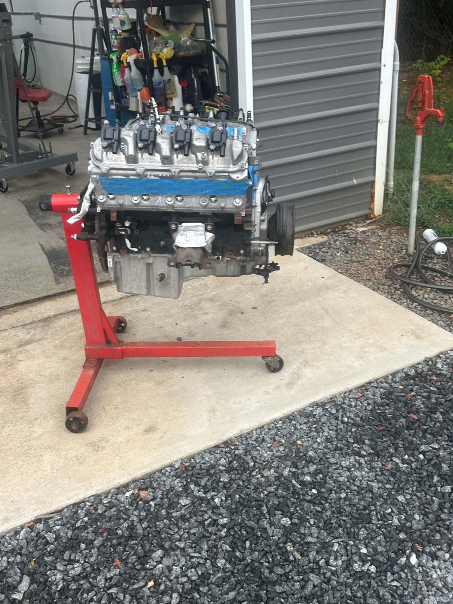

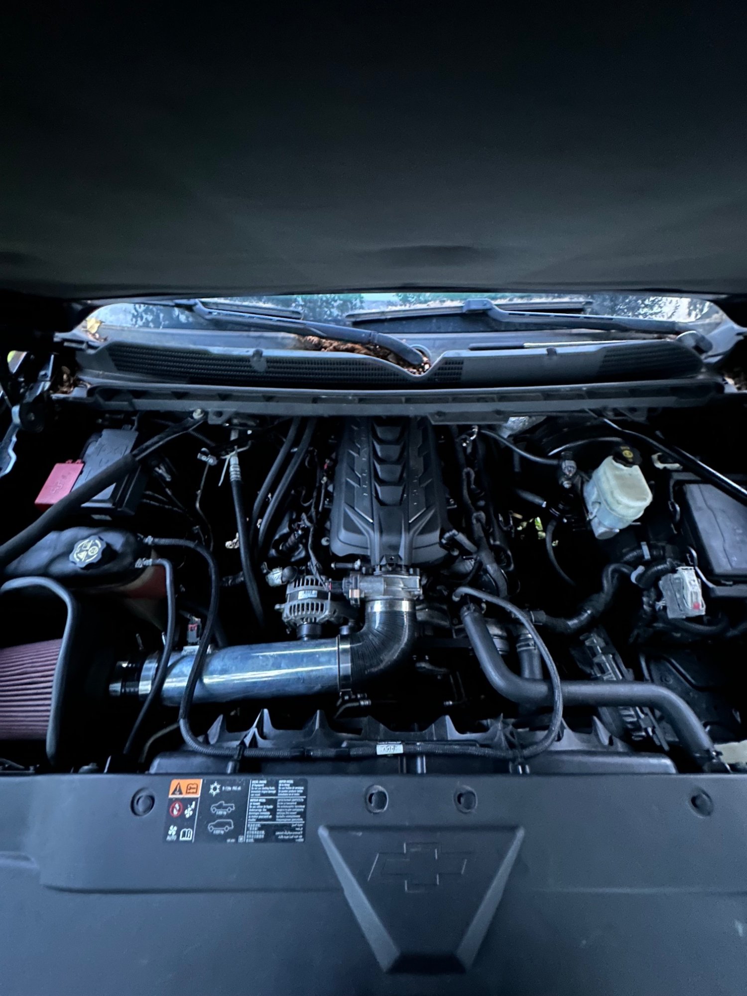

  4. Been a while since i replied… You all are wrong while it was designed off the lt2 cam it is not the same and has considerably more duration than the normal lt2 cam. Also the lt2 cam has afm the l8p cam does not.. With that being said I wasnt able to keep waiting around for it to drop i went with the btr 225 cam instead. Should make better power but wont have the poor mans l8p i had oh well will be evn rowdier. Engine is going in this weekend. Final Setup will be l8t btr 225 cam btr pushrods btr 660 springs che trunion kit lt2 intake manifold lt5 tb 4” custom intake speed engineering longtubes 3.5” custom exhaust and a udp underdrive pulley will be on e85 should clear 500 wheel na

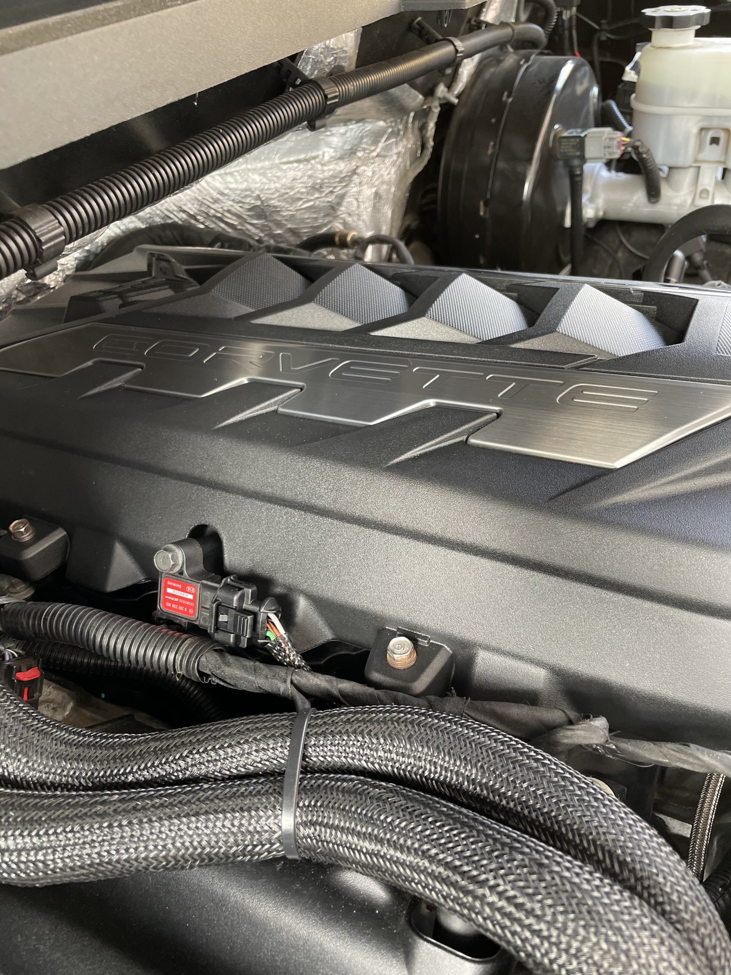

  6. Longtube headers L86 or lt2 manifold anything is better than the l83 manifold LT5 throttlebody underdrive pulley if youre willing to spend ported head money just boost it

  11. thatll work my man thats what gwatney reccomends you do if you go to a larger tb i know of a guy with the lt2 manifold with a 103 mm tb and a 200 shot of nitrous so they must be able to withstand some torture
  12. l86 87mm. wanted to go with the lt5 but gwatney said porting it wasnt a good idea with boost because the remaining material was so thin
  13. contrary to what all the know it alls with stock trucks above say it performs about the same as the l86 manifold from what i can tell on the butt dyno the only noticeable difference is the vacuum it pulls on the boost gauge. Truck still fries tires through 3rd gear
