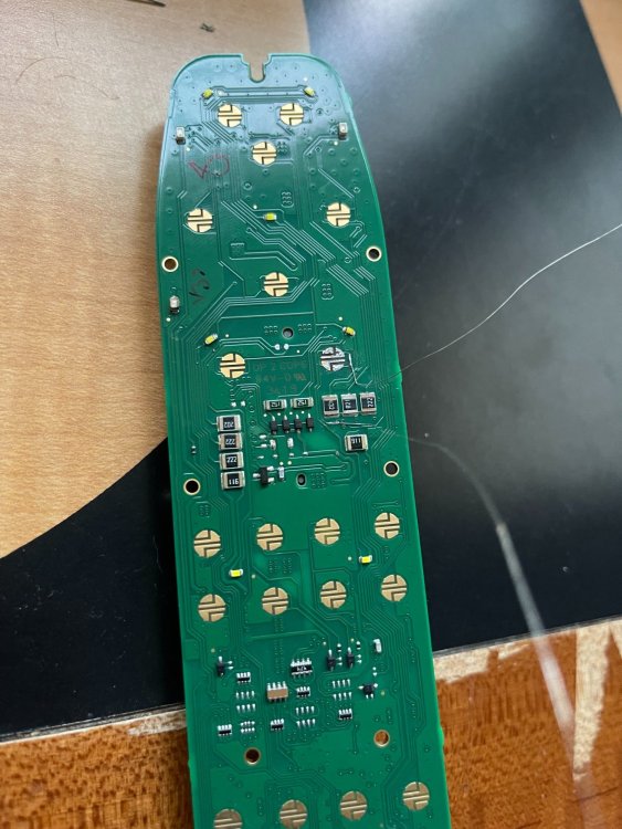

The door switches communicate using a canbus or GM LAN connection. When i changed my switch it did not work, not a single function. I tried many different things including soldering wires to the pad for the mirror fold button, but was not able to make a relay circuit that stayed on long enough to fold or unfold the mirrors. I did give up on the door switch and put my old one back.

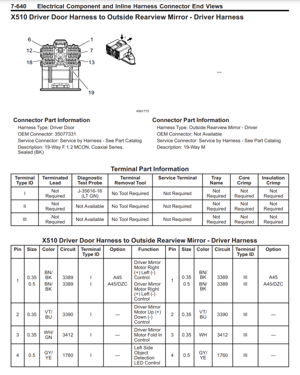

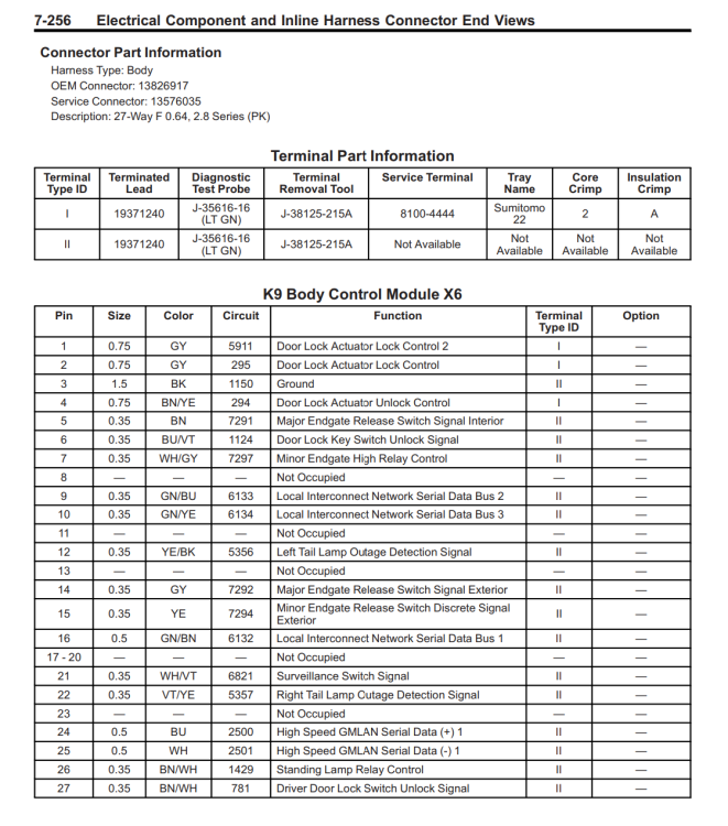

The pins from the BCM are going straight to the drivers door actuator(solenoid), these are the actual High Low signals for the actuator, no relay needed. I did this so that I can unlock and lock my bed mount toolbox from the OEM truck remote key fob. The current from these actuation signals should be plenty for a second actuator in parallel, as it has worked perfectly fine for my toolbox as well as the power folding mirrors. if the new actuator moves the wrong direction just reverse the polarity and it will move the other direction.

Haha I wish I had somebody to give me this information back then… pin 2 and 4 are actually for the drivers door lock actuator, I used these for a lock actuator inside my bed tool box so I can lock and unlock the toolbox from my remote just as you are trying to do for the tonneau cover. you can use the GM Upfitter or body builders manual to find these connectors and pin outs https://www.gmupfitter.com/wp-content/uploads/2021/05/20_Sierra_1500_Electrical_Body_Builder_2019JUN20.pdf pg.413 is where the BCM connectors start. good luck
