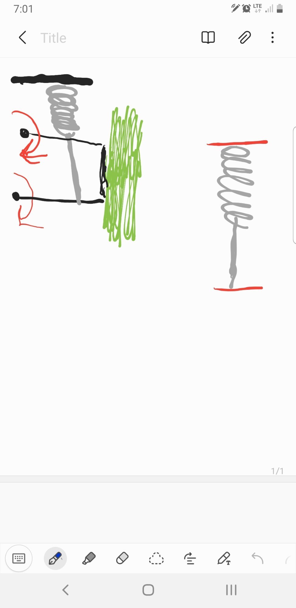

  11. Regarding spacers... Back to your comment "not extending the length, just moving the arm further down"...How can you say adding X spacer doesnt alter the coilovers length?? Again, talking spacers and stock coilovers... Static ride height - the only way to increase leverage is to increase the coilover assemblies length as can be seen in the attached drawing. Adding a 1" spacer on the top or under increases the assembly length which is why you gain lift. You have not alter the coilover preload therefor no change to the coilovers spring rate. Same concept as if you look a stock truck. Jack up the front an inch or two with a floor jack - you have reduced load on the coilover assembly making it longer than it was before. Let's say the spring rates 600lbs per inch, jacking up the front removes weight off the assembly so it is no longer compressed by X amount of inches due to a lack of weight to compress.

  13. When using spacers - How do you move something further down without extending the length of something fixed at the other end?
  14. With the over under you are asking about originally, those spacers ADD to the overall length of the stock coilover assembly as they are an auxiliary addition to. So if your doing a 3" lift, the spacer will be somewhere between 1-1.5" thick. So if the factory coilover assembly is 22", the new length will be 23-23.5" OAL. The 5100s preload the coil. They will be the same or close to the factory assembly length.
  15. They have different settings built into the shock body and you place the circlip at the height you want, preloads the coil to provide lift. Same concept as a coilover assembly with a threaded body, but the adjustment requires removing the top hat.
