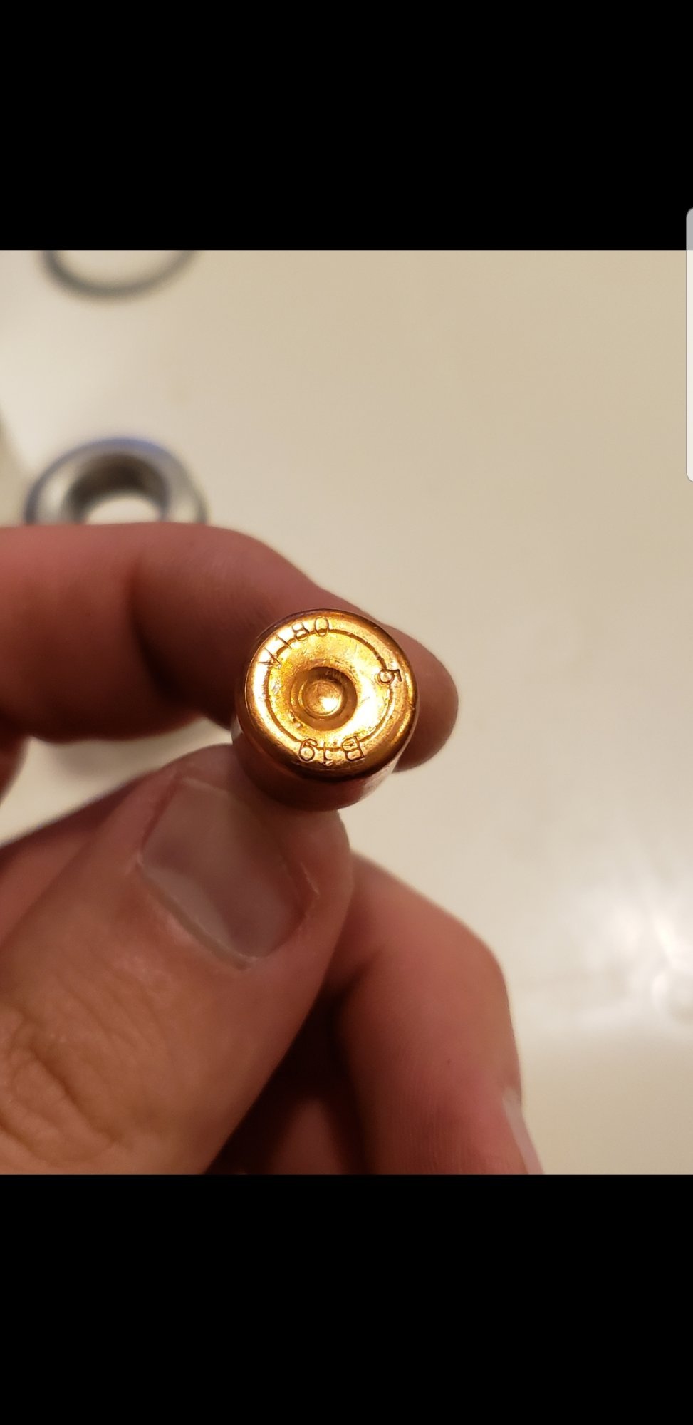

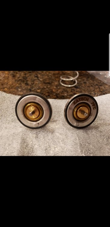

  14. The new tstat is stamped 135 vs the original 180 FYI
  15. My condenser cooled ATF is built with shutters.
  16. Thank you for checking and confirming this, the more we know!
  17. So I'm led even more so believe that the 180 marked on the OE stat is start to open when stats have historically been about 15 or so start to full (194 -15 = 179). The stamped 70 reverses this role obviously as 70c = 158f. You can disassemble the new housing and reporting what's stamped on the stat, disassembly is extremely easy. Iv been a believer that the thermostat is labeled start to open temps.

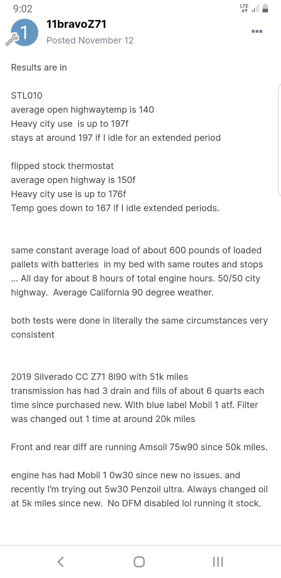

  18. I'm under the understanding the start to open temp on the original stat is 180. My katech engine thermostat is labeled 79C which is its start to open temp.
  19. Original stat from my 19 Tahoe.
