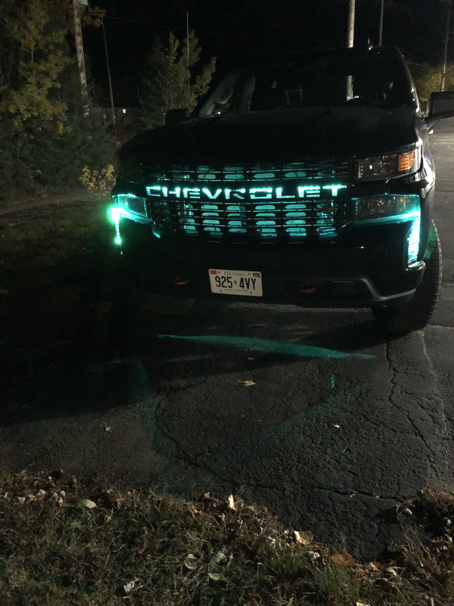

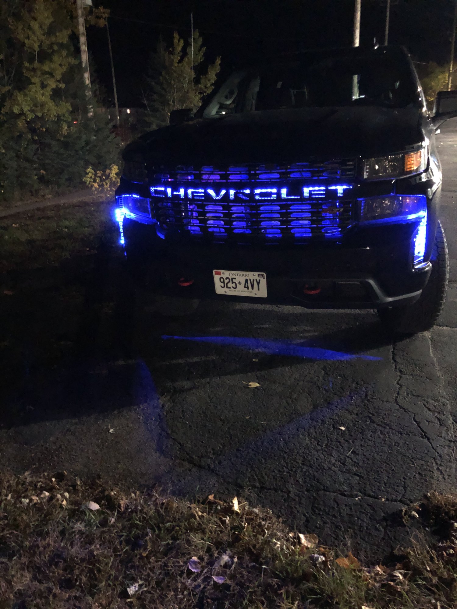

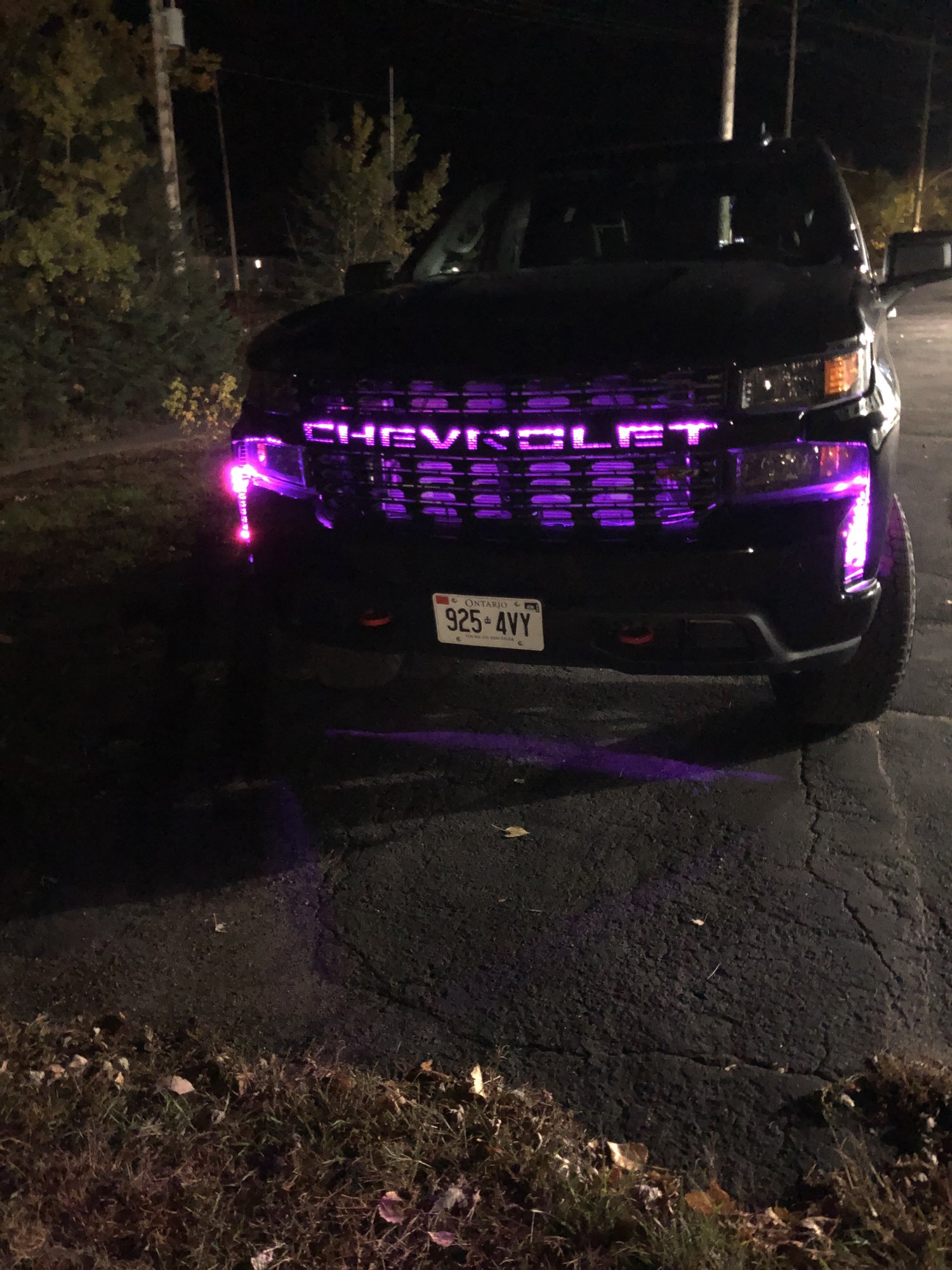

  10. I started with a led glow system and used the interior tubes for this install. Silicone the ends for water profing used 4 of the 12 inch led tubes . Led glow includes brackets for the tubes so I was able to use them and it makes it easier to angle the lights correctly. In those vents I used a couple 9 inch led strips with 3m on the back I just needed to integrate them into the led glow system . I removed my grille for easier installation just remove piece between grille and rad make sure you take off the hood release then 4 10mil bolts and about 6 clips once you have the bolts out just grab the grille and pull straight back. They are installed on the top edge of the letter cutout and angled towards the letters. I’m not big on all the light lighting up behind grille so I might block that to prevent light from spilling back.
  11. Other then a flow master muffler this is my first mod on the truck.
