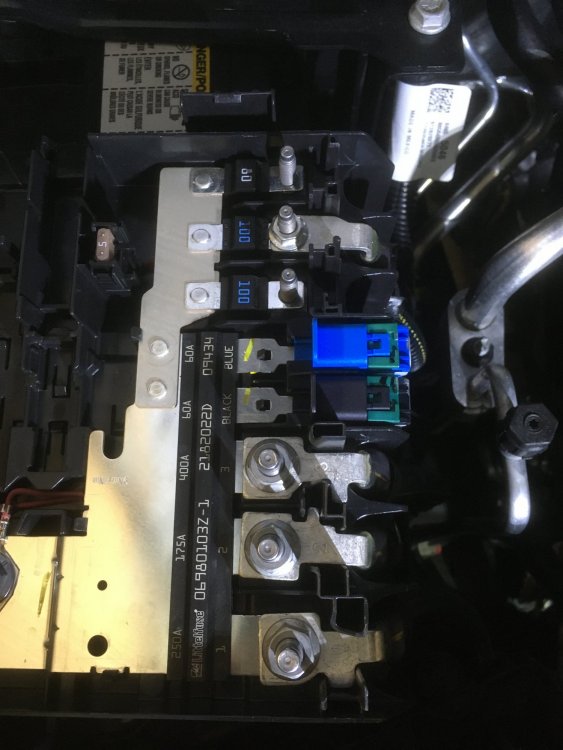

  9. If you’re not pulling from the truck battery you shouldn’t have to worry. If so, it draws from the secondary battery and leaves the primary fully charged
  10. I'm just guessing now because the wiring harness is all a big bundle. But it would make sense that the 100A is the 100A at the other end at the secondary battery. Also, the 175A probably goes to the main fuse box. There's a heavy gauge line that hooks up there.
  11. My 2018 2500 Ram beat me to death. My new 3500 double cab long bed with snow plow package rides like a Cadillac compared to the Ram. I guess it's relative.
  12. To confirm what George said I checked the power lead in the 7 pin with and without the 30 amp connection off the secondary battery being connected. Just like was described, the 30 amp lug off the secondary battery supplies the power to the camper with the battery isolated with the truck off. Thanks everybody. I think this is solved.
  13. If the starter battery is drained by my camper with the truck off I don’t see how the secondary battery can start the truck through that 100 amp fuse
  14. Here is the fuse layout on the starter battery. The 400 amp goes to the starter. The 250 is the alternator. The others disappear into the wire harness
