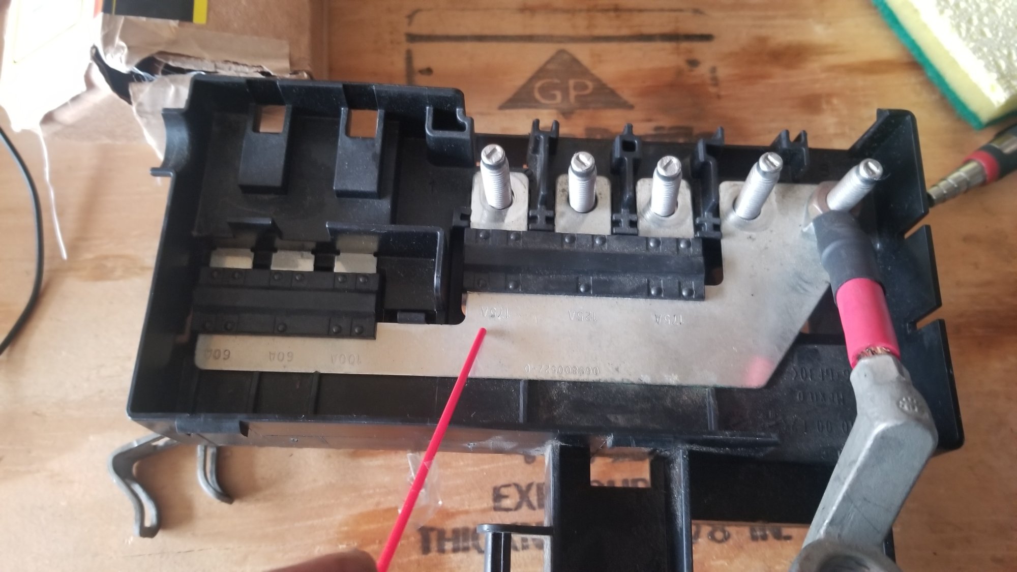

  6. Issue is the mega fuses. Likely the 175A on the battery head thats feeding the cable which runs from battery to the other side. Replace that should have it all back to normal
  7. Anyone have a fix ? Just swapped my cam. Put whole truck back together and exact same symptoms above. No horn no dash lights. Wont turn over. Even remote start fails. Only 1 headlight turns on. Opposite side blinker works other doesnt. Driver side mirror light doesnt turn on. Passenger side does. Interior dome lights turn on once key is removed. Dome lights dont activate when door is opened. No clue where to start
